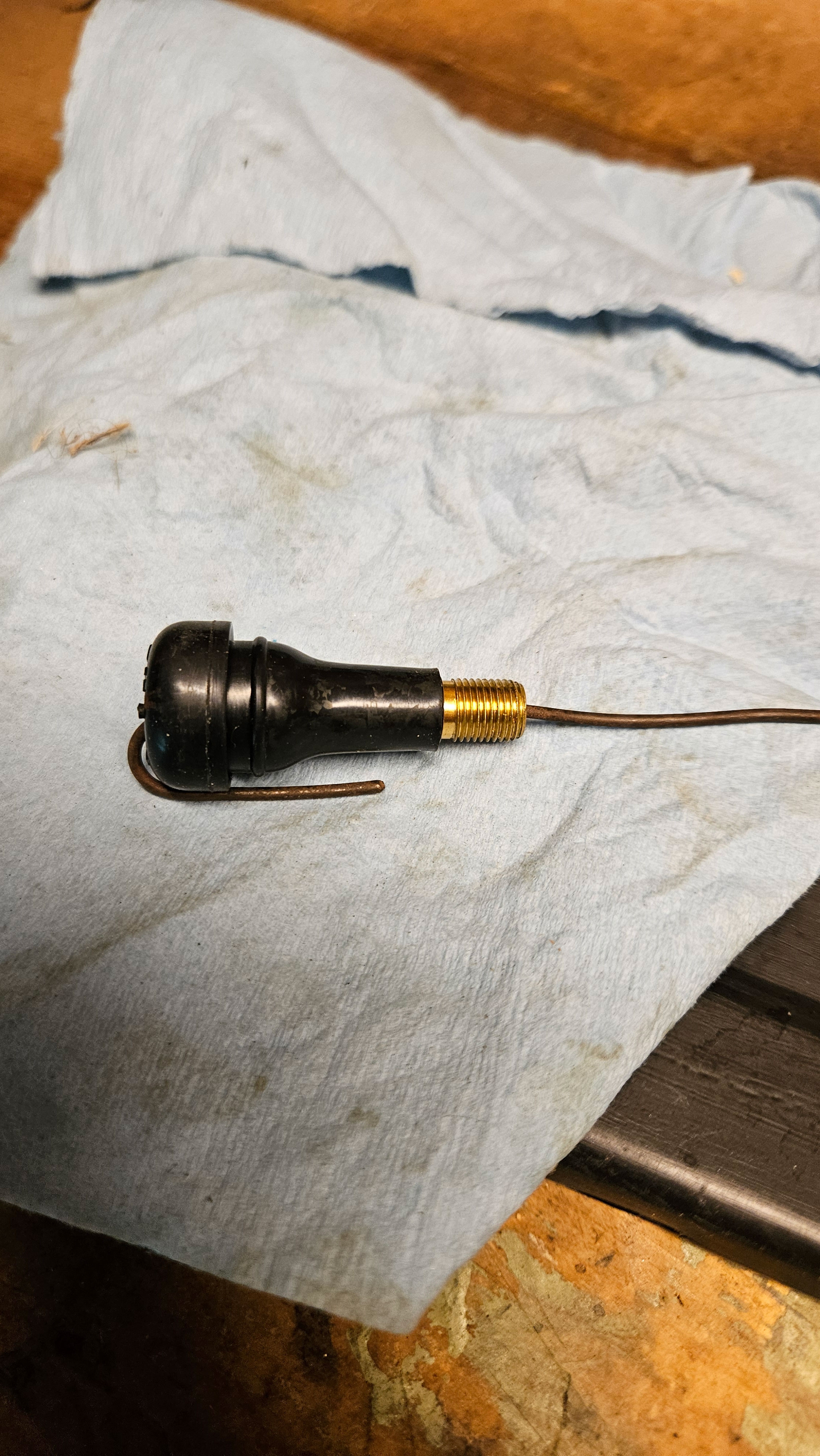

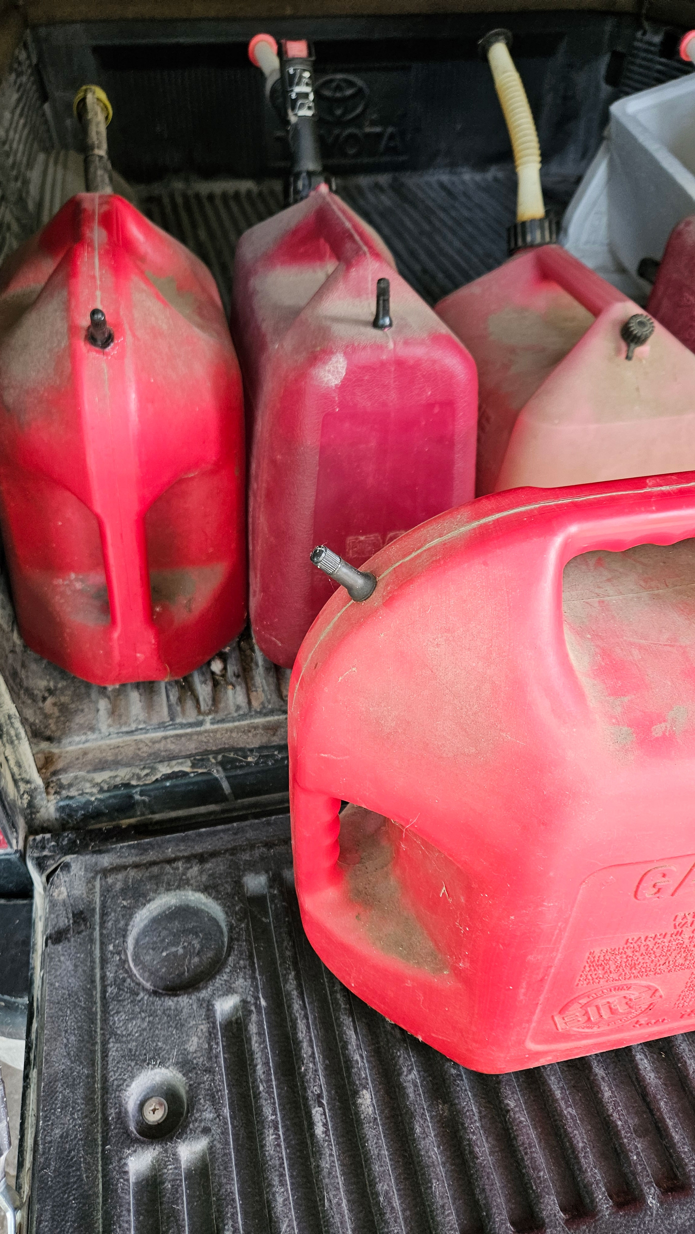

Instead of whining about government and buying new nozzles, I put vents in all my unvented cans.
Drill a 1/2" hole and install a tire valve. Amazon.com
Remove the Schrader valve, run a 12-14" piece of baling wire through, and make a hook at the end. Make a slight bow in the entire length of wire. Remove the nozzle and run the wire through the opening and carefully pull the valve stem up through the drilled hole until it's seated.
They don't leak but, if you're a belt-and-suspenders guy, you could put some sealant at the base of the stem where it contacts the can.
Quick and cheap. The can in the foreground, like many cans, has a flat spot tailor-made for a vent, where the manufacturer used old molds with vents.
