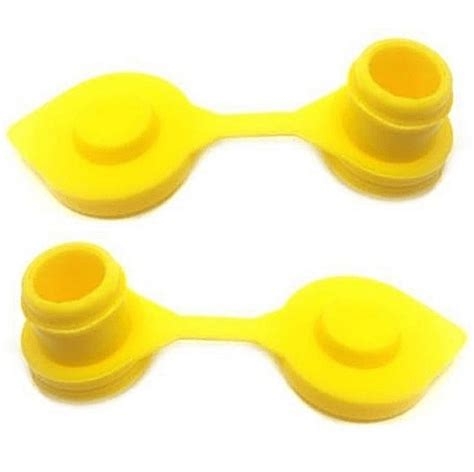

I "fixed" my new plastic gas containers with Amazon.com: 𝟏𝟎 𝐏𝐜𝐬 Gas can Vents for Plastic Gas Cans, Gas Can Vent Caps, Yellow Fuel Gas Can Jug Vents/Cap Replacement : Automotive
HUH; 10 states are SOL.

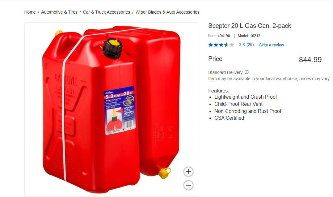

I will say tho, Costco around here has been selling a pair of 20L cans with vent for CAN$45 which is US$33 for years and that's delivered, less in store. They have the stupid ratchet locks around the fill but a utility knife fixes that.
That’s a pretty good deal, MM. Are they selling a yellow diesel version? Or just red?
I drilled these into my current, nanny state 5 gallon cans. They help.
But activating the button while holding a 5G can up at waist height without spilling isn’t easy when it’s full without spilling fuel.

The problem I had with the vents is the cap lanyard breaks. I went with drilled holes and rubber stoppers. Most of the time I fill using a funnel and no nozzle at all. No vent needed, just pour at a rate that doesn't make the can GLUG GLUG.
