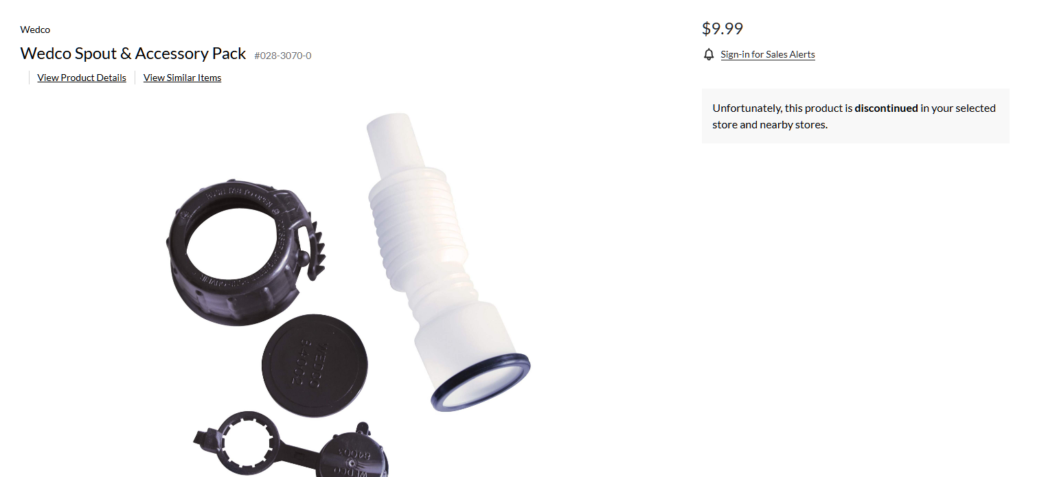

The ones I have lasted for years before they started cracking, never leaked anywhere as you could bend the spout and place it in the tank of whatever you're filling before upending the gas can.
Now as someone pointed out, they're too small diameter at the base flange and leak like a sieve.
This is the one I was talking about, notice..."Discontinued"
EZ-Pour has the correct nozzle for a Wedco can.
