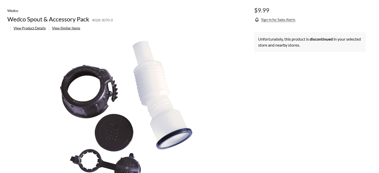

I do use a $25 12 volt transfer pump for diesel. Went through 2 of them in a year and then discovered if you hang them and let them drain, they last. I understand they are not made for gasoline. New zero turn and tractor have a 4 inch gas tank hole and are low. Dump directly out of the can.
My plastic gas cans are so old I've lost the caps and I can't find a cap that fits the can threads. I have several spout assortments from Amazon, but don't have the correct thread, too small. Where do I find the correct size?
