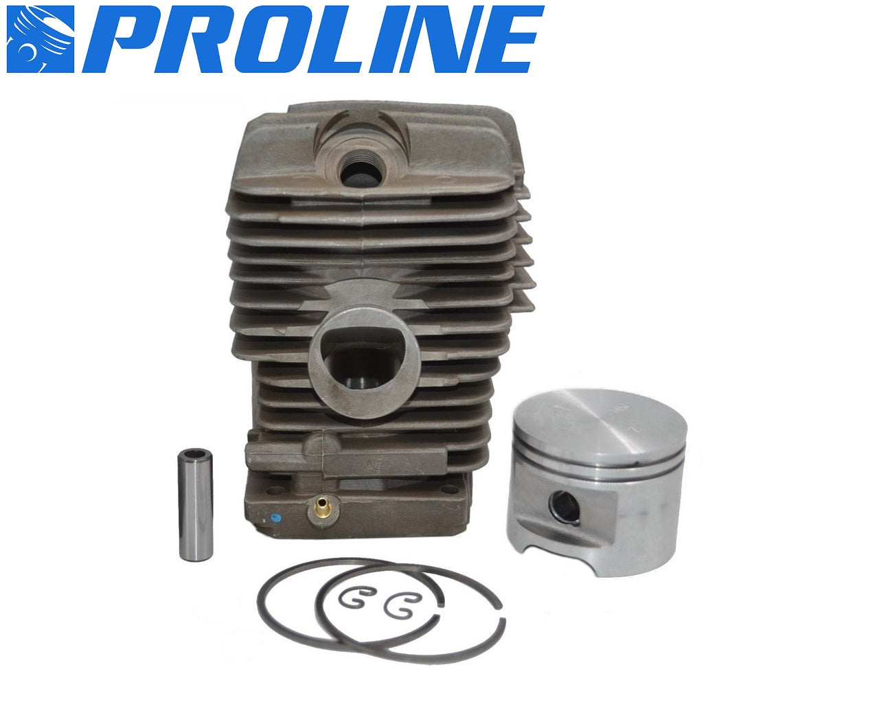

What do you think of this option? They provide a 1 yr warranty and were pretty good at answering all my questions. They were adamant that none of their cylinder/piston kits were made in China..thanks again !
It looks like a good middle of the road price option. If you are able to do the repairs you probably also know what things to look at for quality. It's easy to put a shiny piston in the photo. I'm more interested in cylinder roundness and finish. I would check how the piston looks in the cylinder and if the overall fit and finish look acceptable.
