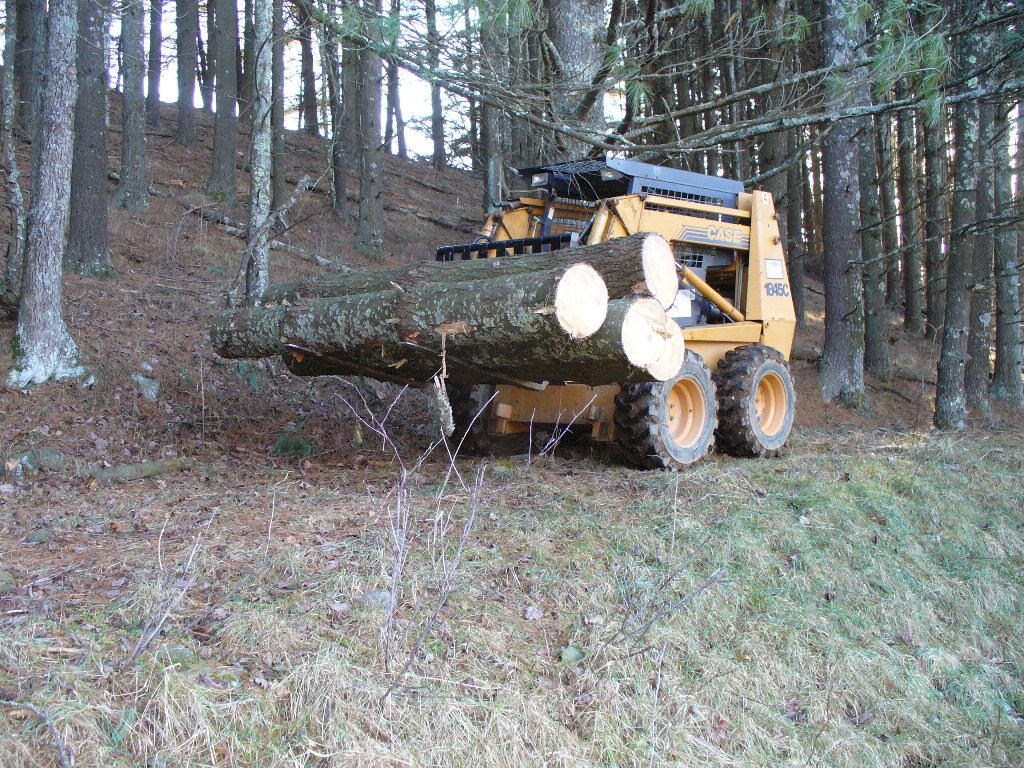

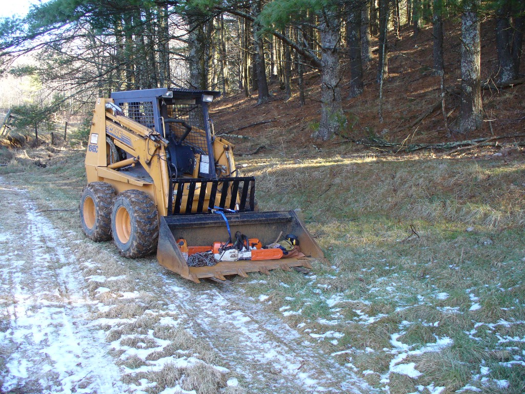

I was able to get out to the woods today to get another load of logs before the next storm. Largest logs I got are 24" diameter on the big end, so I'll have to shave them down to fit in the mill. I might also use the Alaskan to make them into cants, should be interesting. Below are a couple pics of what I'm doing in the woods for now, carrying the tools out in the bucket, using forks to carry logs back to the truck, a grapple would be nice.

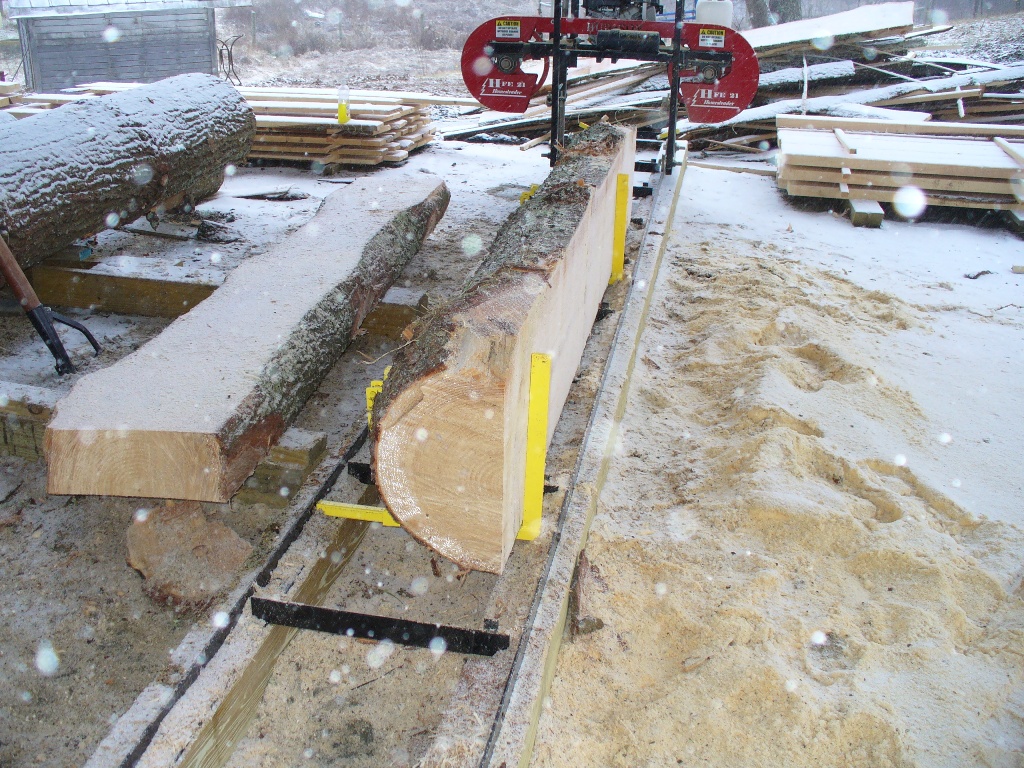

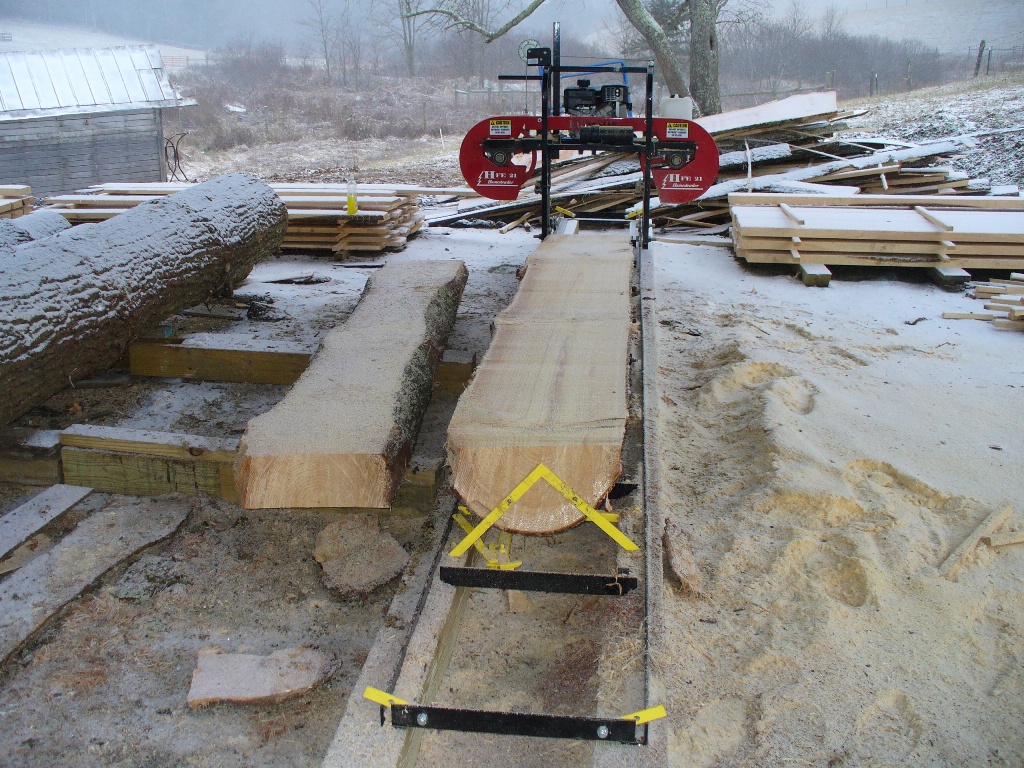

I got a few more logs milled today, these larger logs are nice because I can make multiple cants out of them which makes things go quicker. Couple pics below of making some 6" wide cants for 1x6 and 2x6:

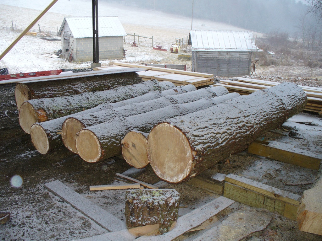

Logs ready to be milled, should be about 800bf here:

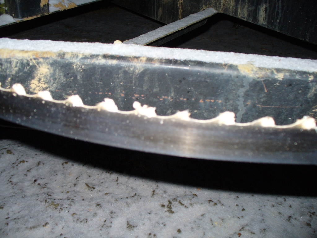

Question for those with more experience than I, I sometimes get to a point when the blade quits cutting, saw bogs down etc. It seems to mostly happen after 200-300bf, but I don't think the blade is getting that dull. It seems as if it just gums up sometime, despite using dish detergent in my blade lube. See pic:
Is this a result of the blade being dull, too much pitch in the wood (seems to be spots where this trouble occurs, not all logs), not enough/right type of blade lube? I have taken off two blades after about 200-300bf thinking they were dull, but they might have just been gummed up. Thoughts?
