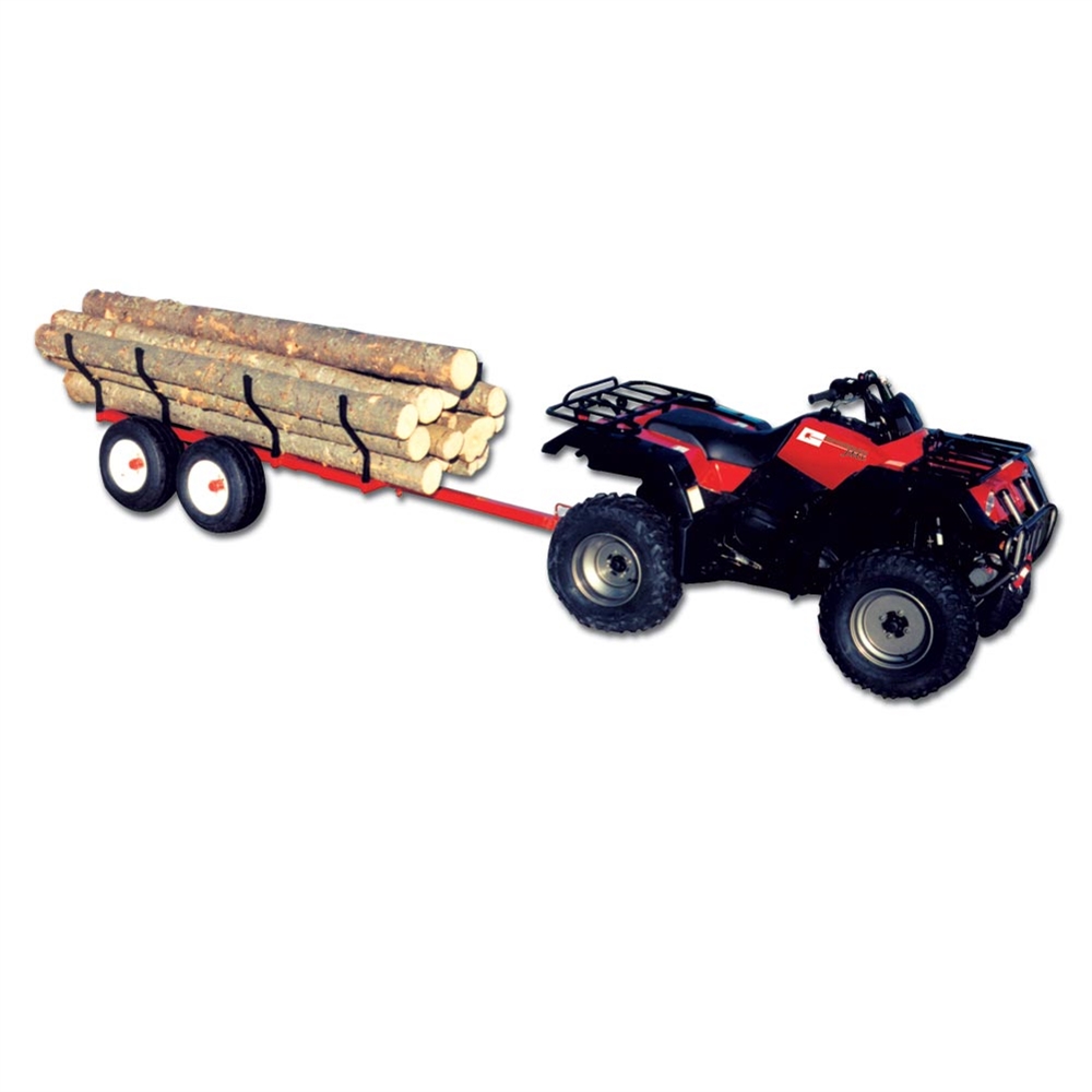

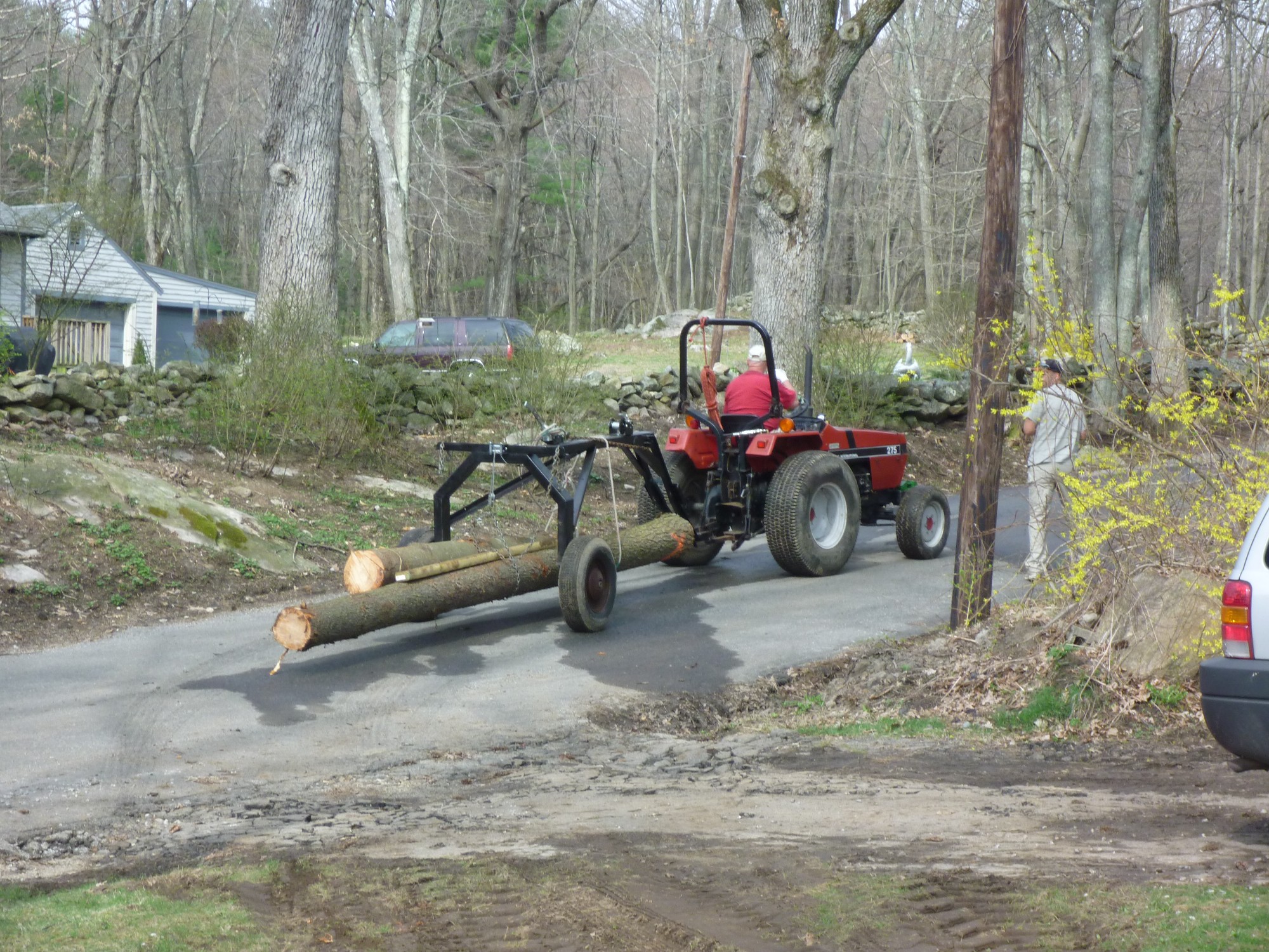

I've been contemplating building a little log trailer like this one below, except tractor size:
I could pull it in the woods and load it with my B3200, then hook it to the truck to take it back to the mill. For big loads I could use it behind my IH 454 and load it with the skid steer.

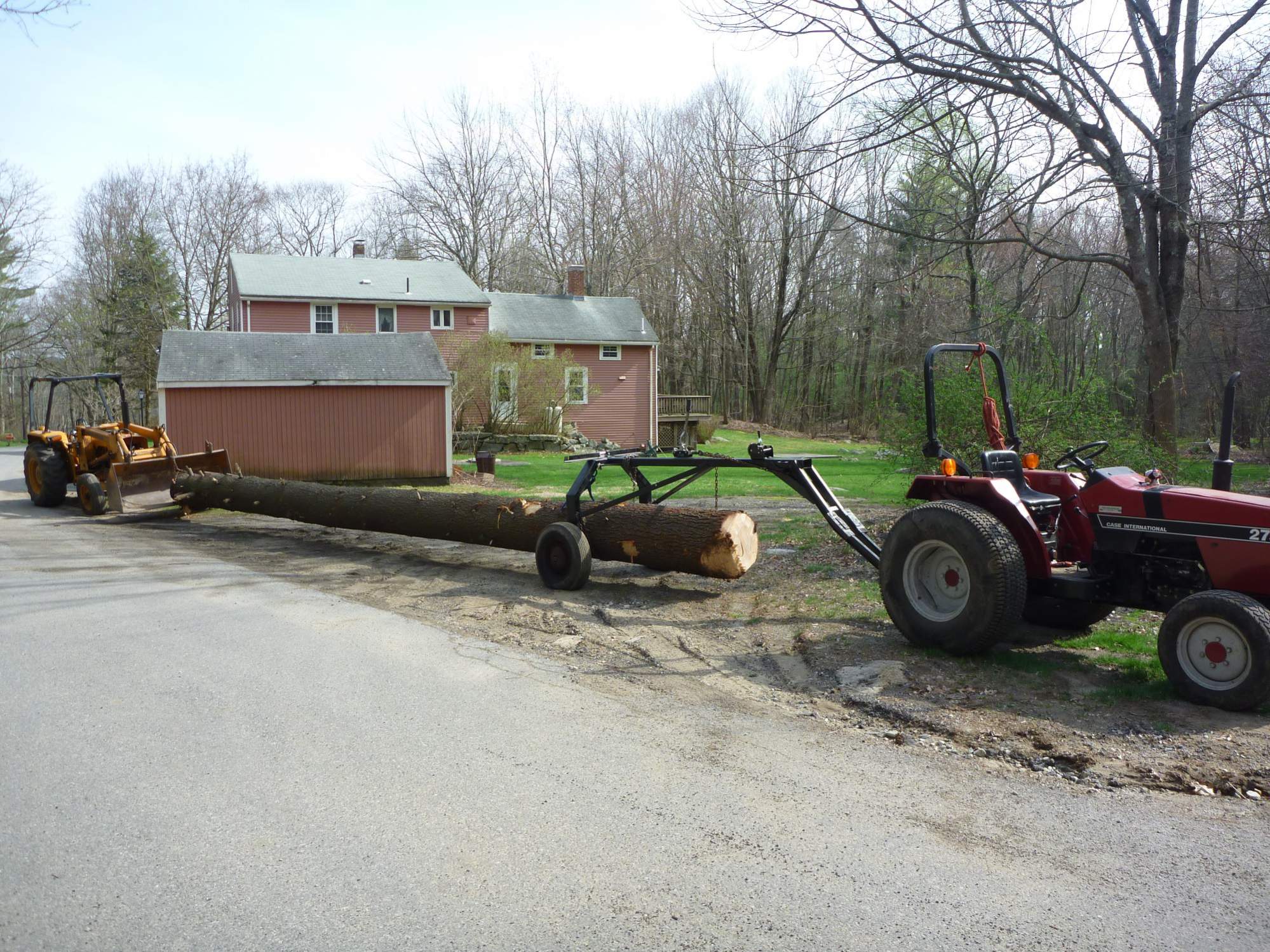

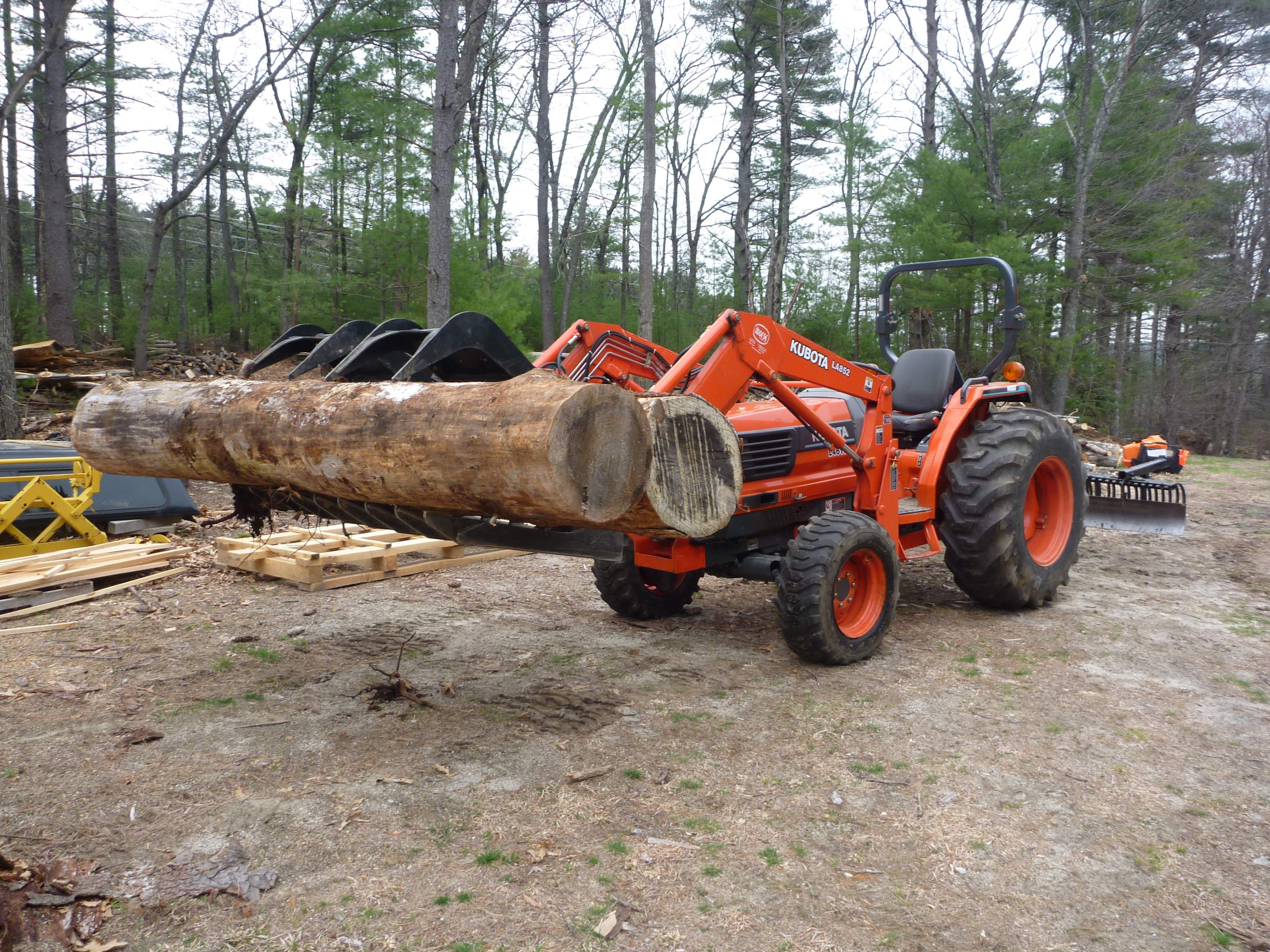

-What kind of equipment do you use to get your logs from the stump to the mill?

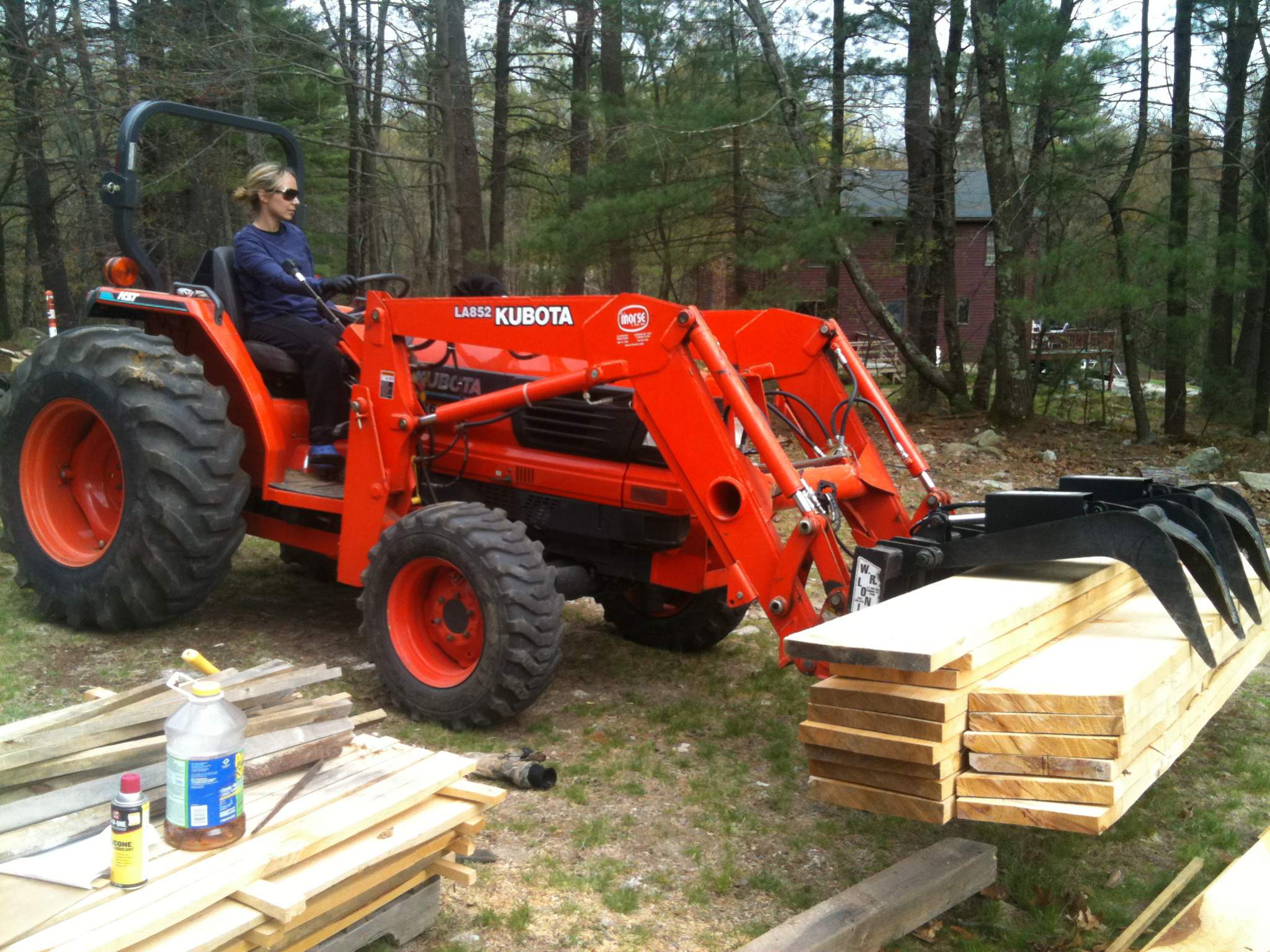

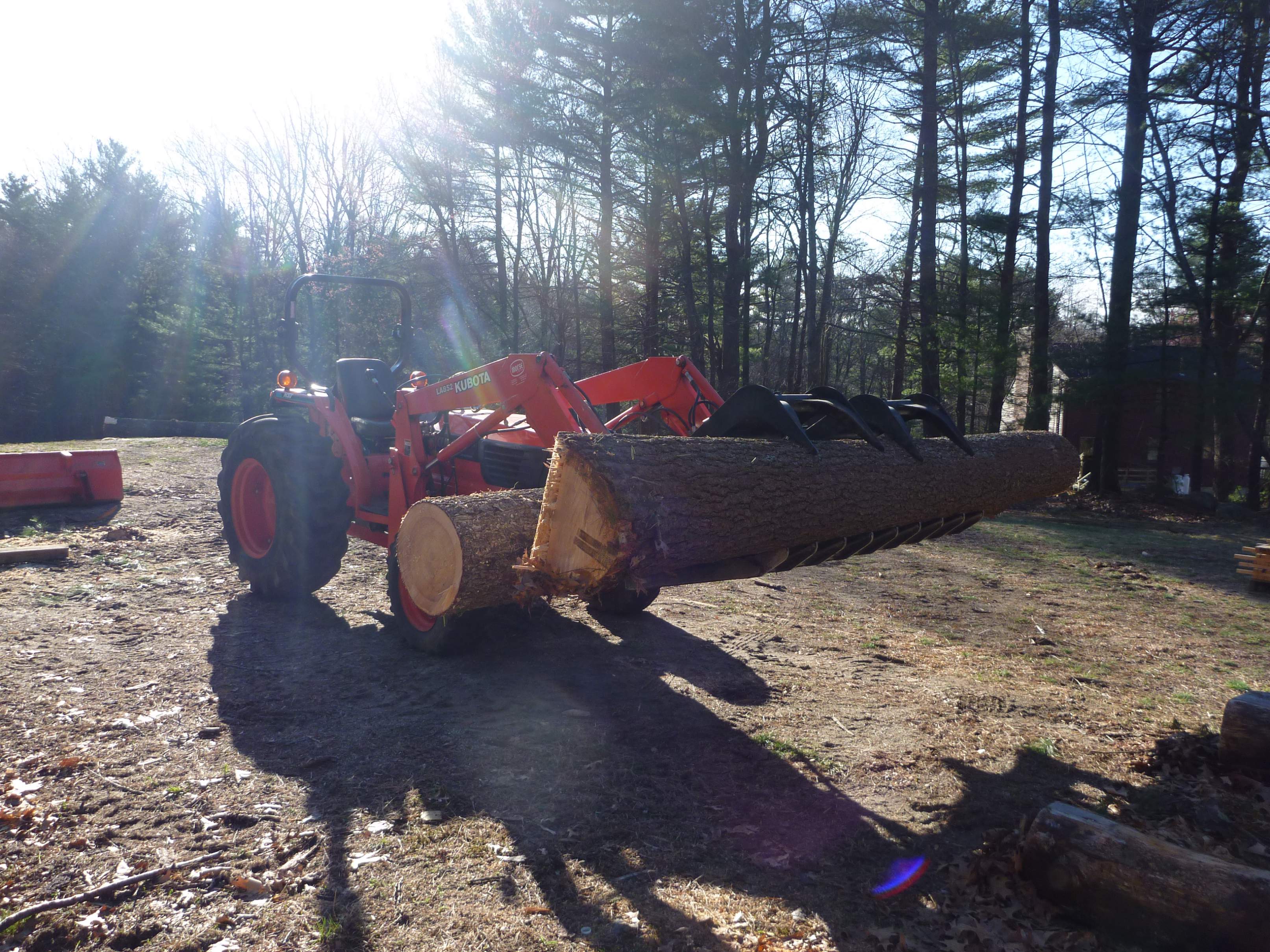

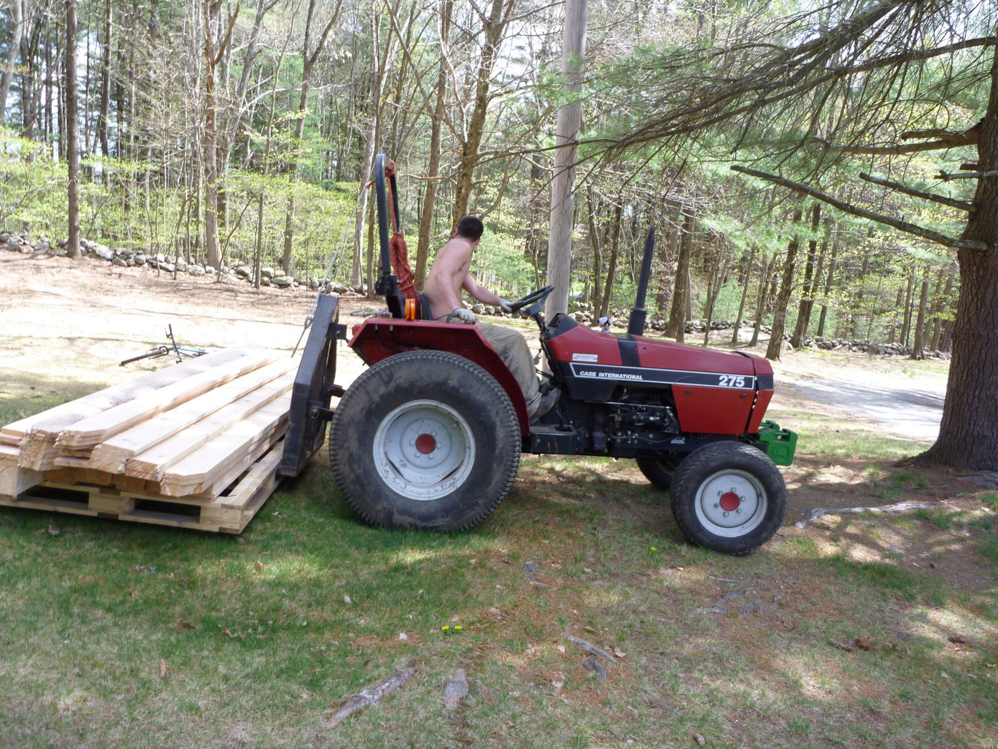

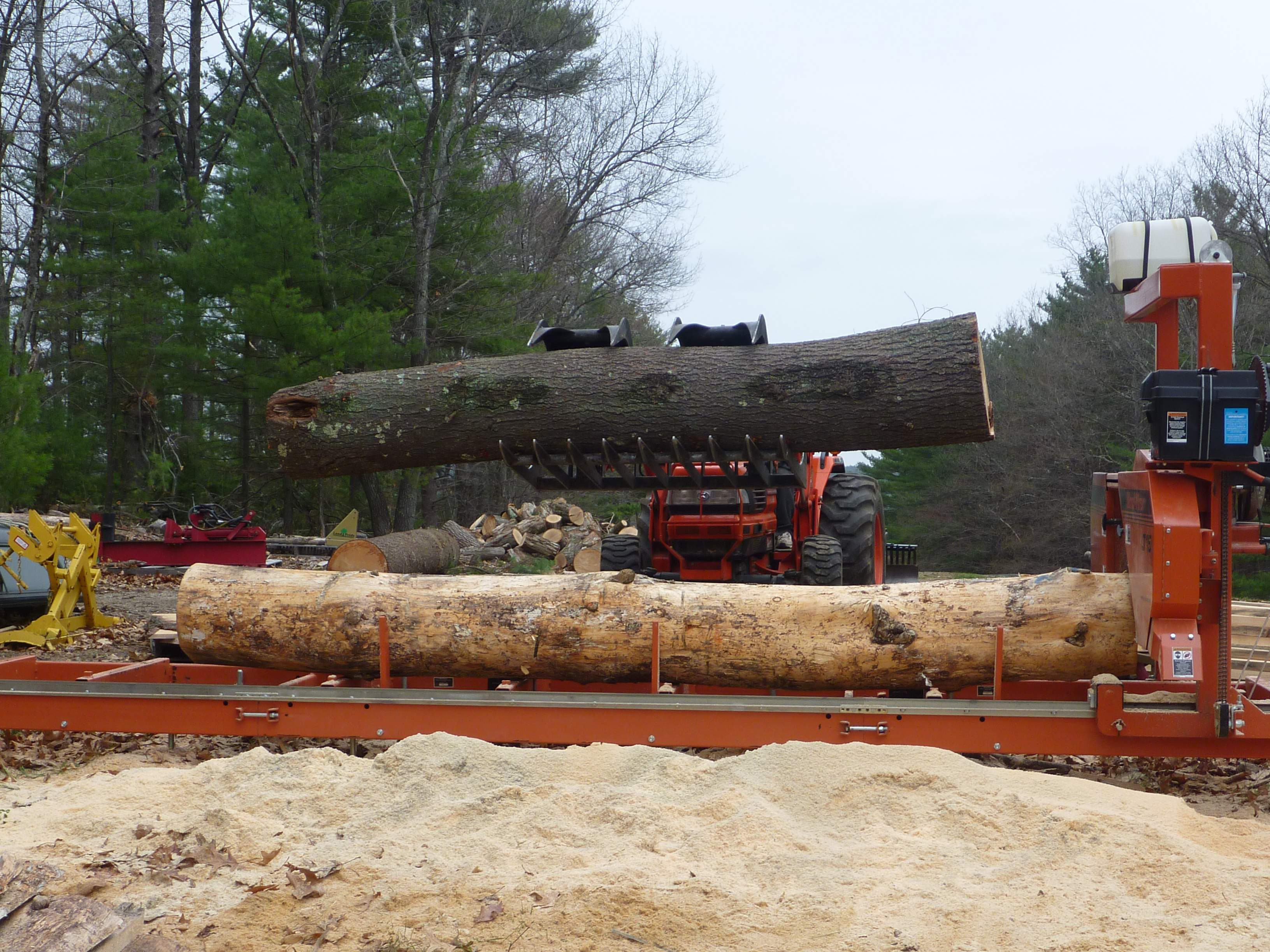

I almost always use my grapple. Usually I can carry the logs in the grapple and place them directly onto my "log bunks". If they are too heavy (mostly to do with length) or they are too long to carry out of the woods without running into trees, I'll use my log arch, although this is rare. The few times I've had to carry numerous logs longer distances, I've used my tractor and grapple to load the logs on a full size trailer, and then the same method to offload them at the mill. I've also used a dump trailer once which wasn't mine. That was a really slick setup but only good for logs less than 14' or so.
I would not have a sawmill without a FEL grapple. (I chose the specific grapple I have based on uses for the mill, let me know if you want "reasons why".)
Here is what I used prior to my new tractor and grapple...
It is 10 times faster with the grapple, and I never have to leave my seat :D

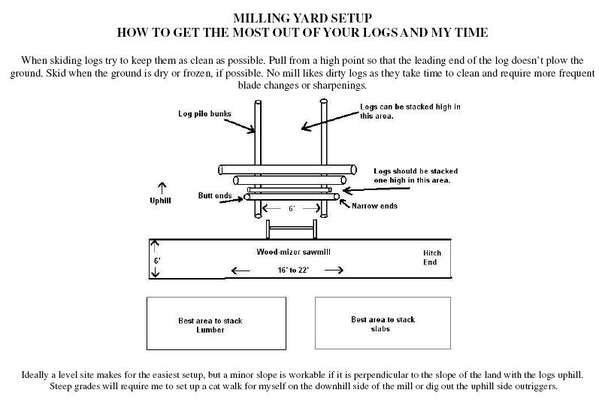

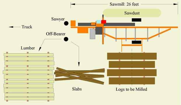

-What kind of method or layout do you use to efficiently separate/stack/move lumber, slab wood, sawdust etc away from the mill?
Here is what works pretty well for me. These are not my pictures, but I find them useful, and they were posted with permission to use elsewhere. I based my mill setup on these suggestions.
Depending on how your site is laid out, or if you have a helper, you may find this works well for you. Otherwise, it's a good start if nothing else.
Milling efficiently is similar to splitting firewood efficiently, material handling (onloading and offbearing/stacking) has more to do with efficiency than the ability of the mill. No matter how nice of a log splitter I have, I still have to load the rounds, move the splits, and stack them properly. Same with milling.

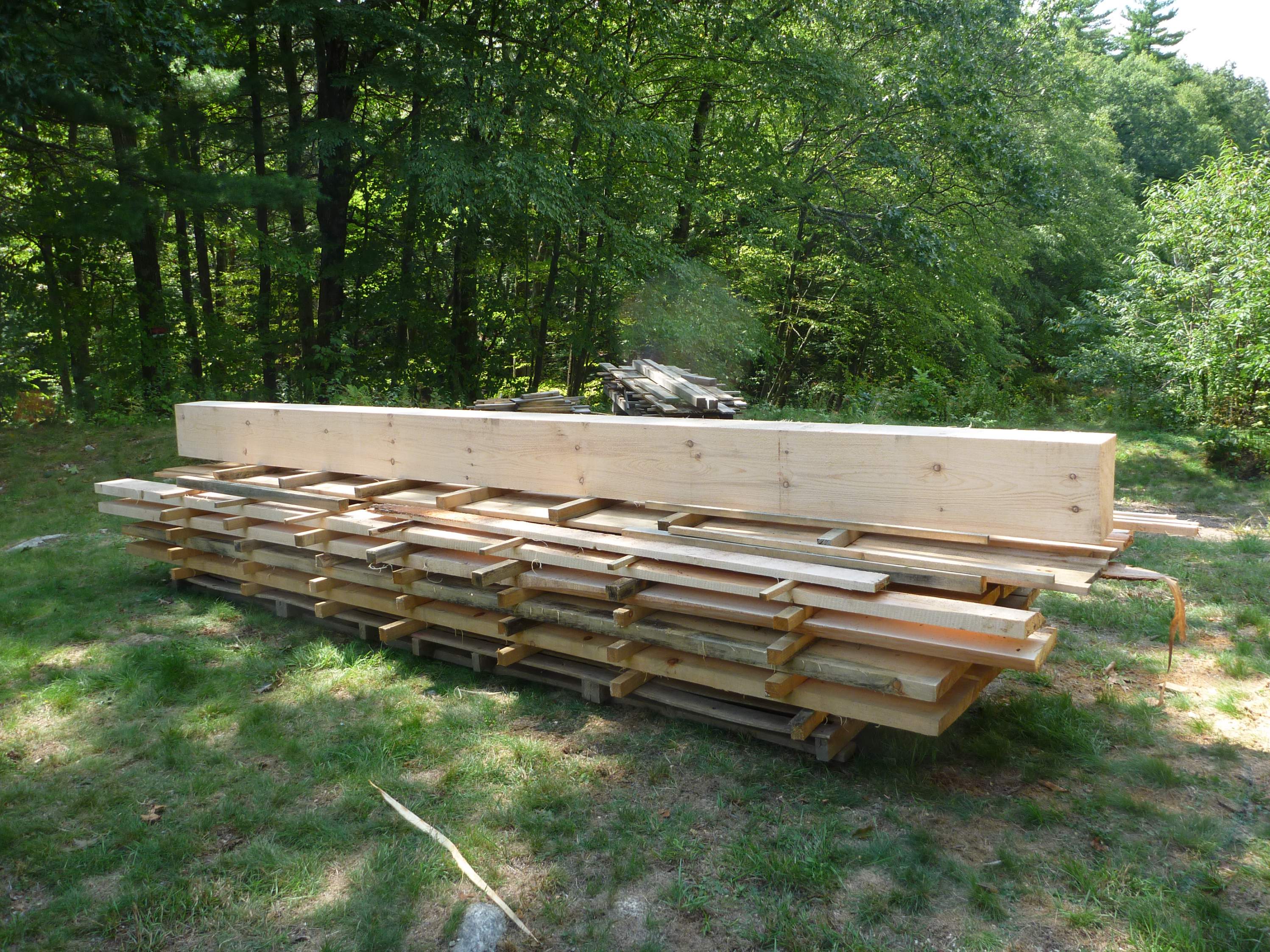

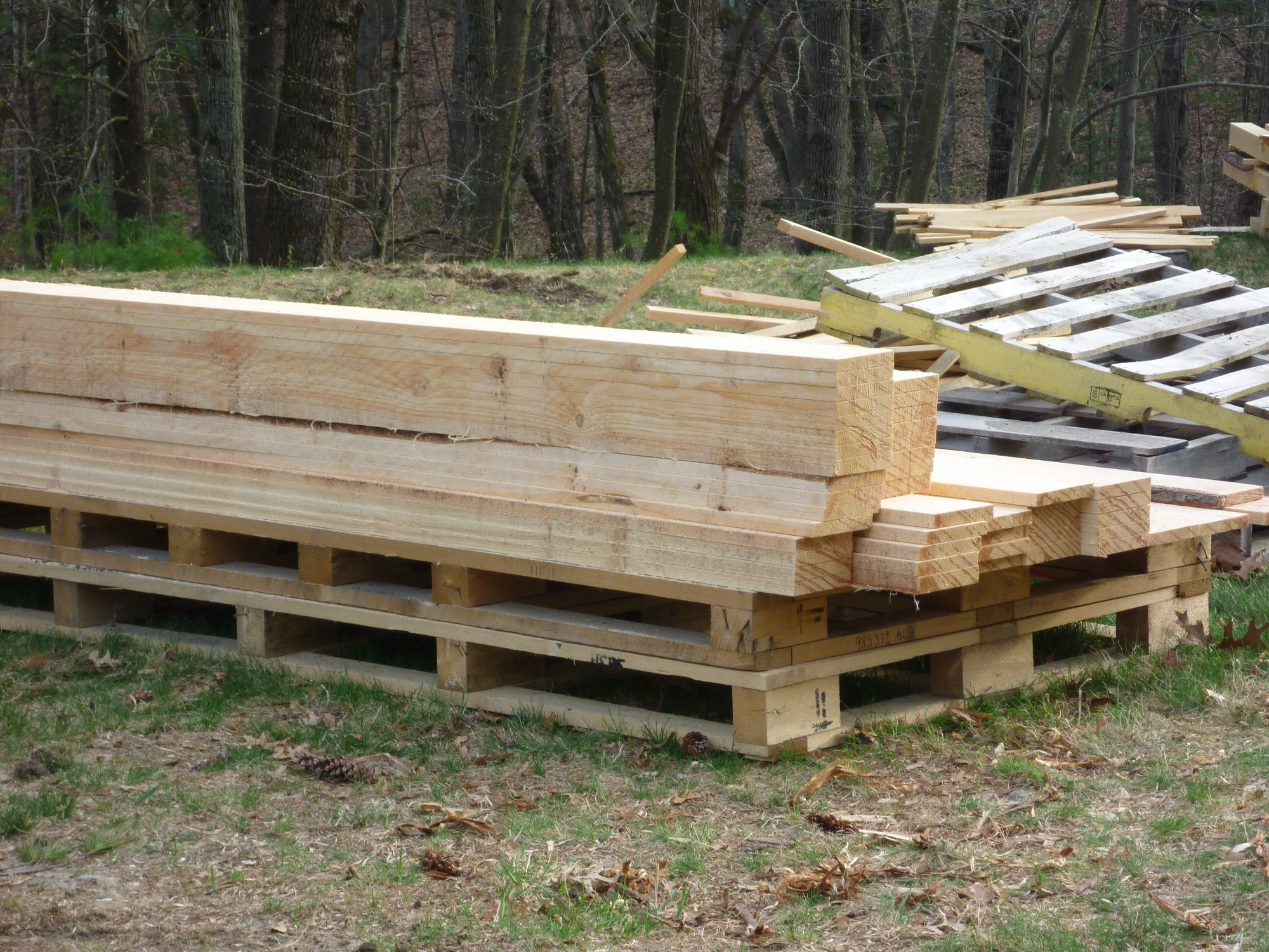

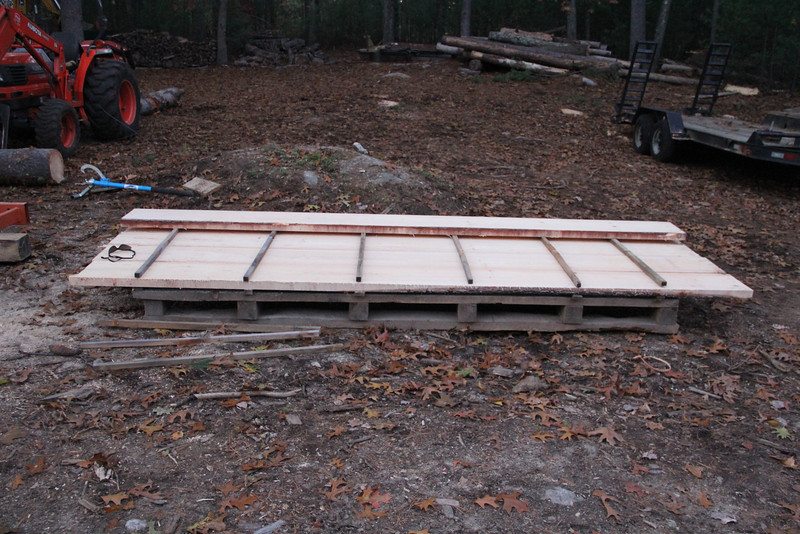

-I'll be stacking and stickering the lumber outside for now, what do you use as a good flat base for your lumber? To cover your lumber stacks?
Outside is fine, that is where most of us stack our lumber. If I'm storing some timbers or lumber outside and I don't want them to be discolored by sunlight, then I'll cover them with a tarp, elevated off the timbers, and allowing airflow on all 4 sides. A tarp isn't ideal but it works for short periods. Otherwise though, I really don't cover my lumber, however I always sticker it. Stickering is much more important than covering. Always sticker your lumber, especially pine in really hot/humid weather. Pine will start to "bluestain" within a matter of days if it is not stickered.
I use green stickers when sawing pine, and saw my stickers from the "waste" or when edging boards. Be sure all your stickers are the same thickness in one dimension and always use that dimension for your stickers (within the same row).
You will get stains when using green stickers, and if your using it for framing lumber that will be covered up it is fine. It doesn't affect your lumber structurally but keep in mind, even if you plane the wood, it may not come out. I use dry stickers for timbers or wood that will be used and seen, like flooring.
I built quite a few "pallets" for my longer wood, mostly so I could move it around if needed. If your not worried about moving it around, then a flat base of any sort, elevated off the ground will work well. Try to elevate the base of the stack about a foot or more. You'll want to be able to get either a push mower or weed wacker under there if the grass starts growing high around the edges.

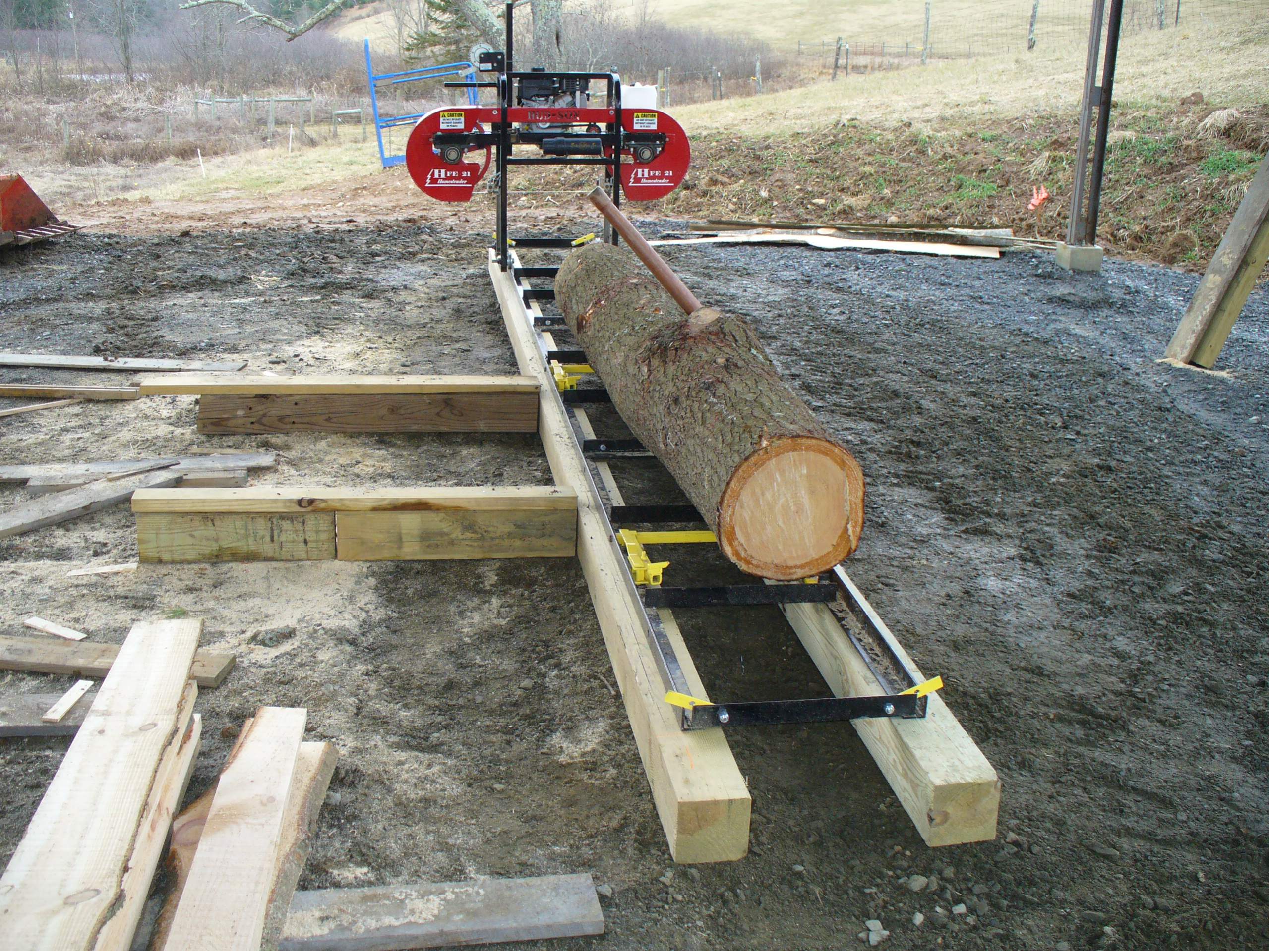

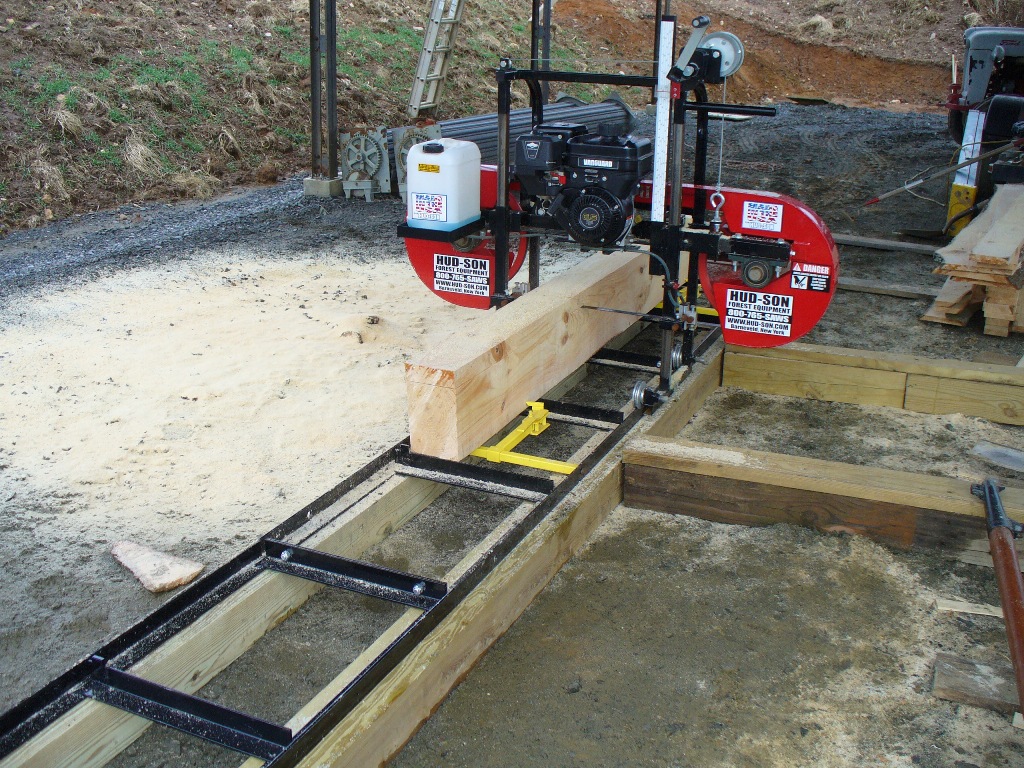

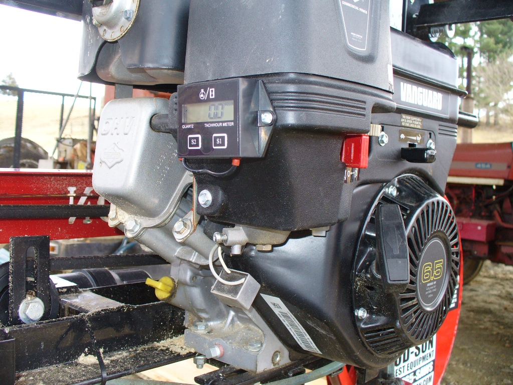

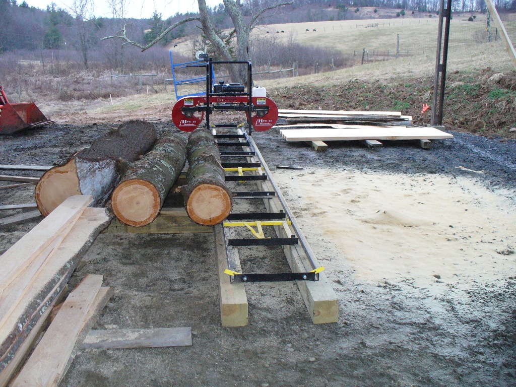

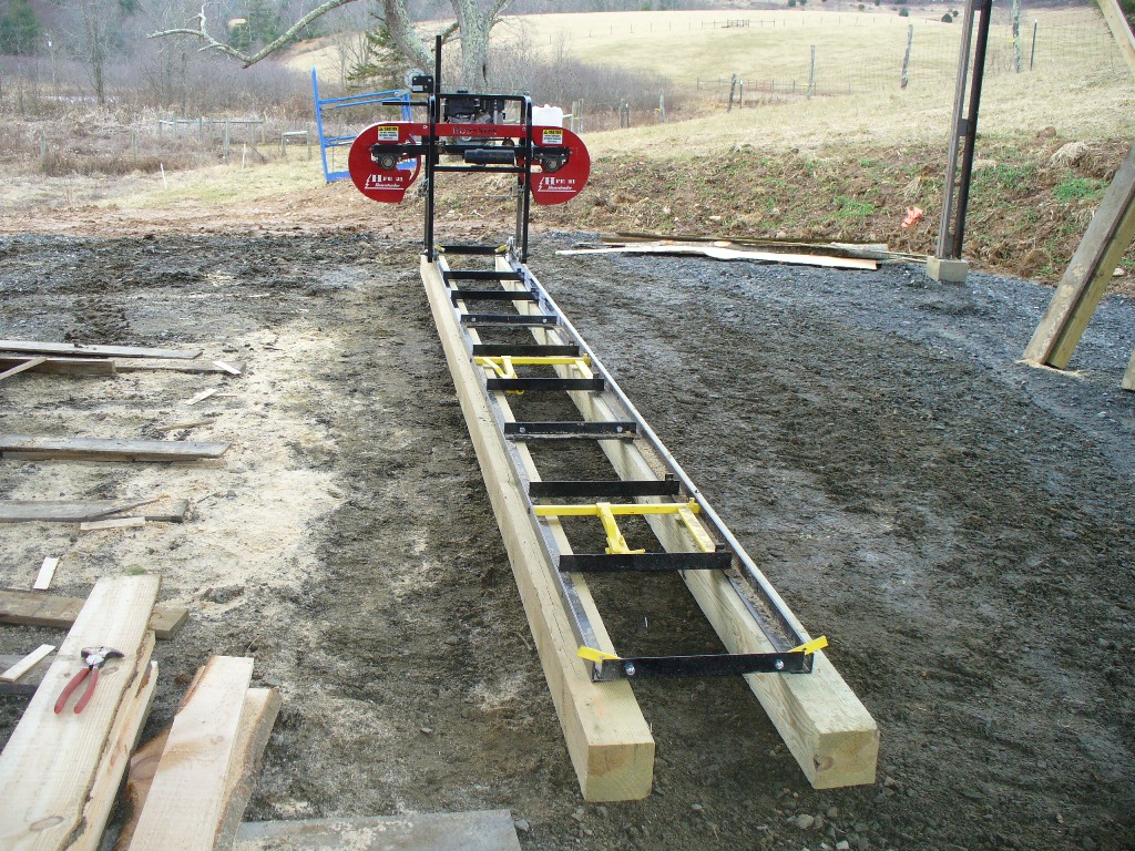

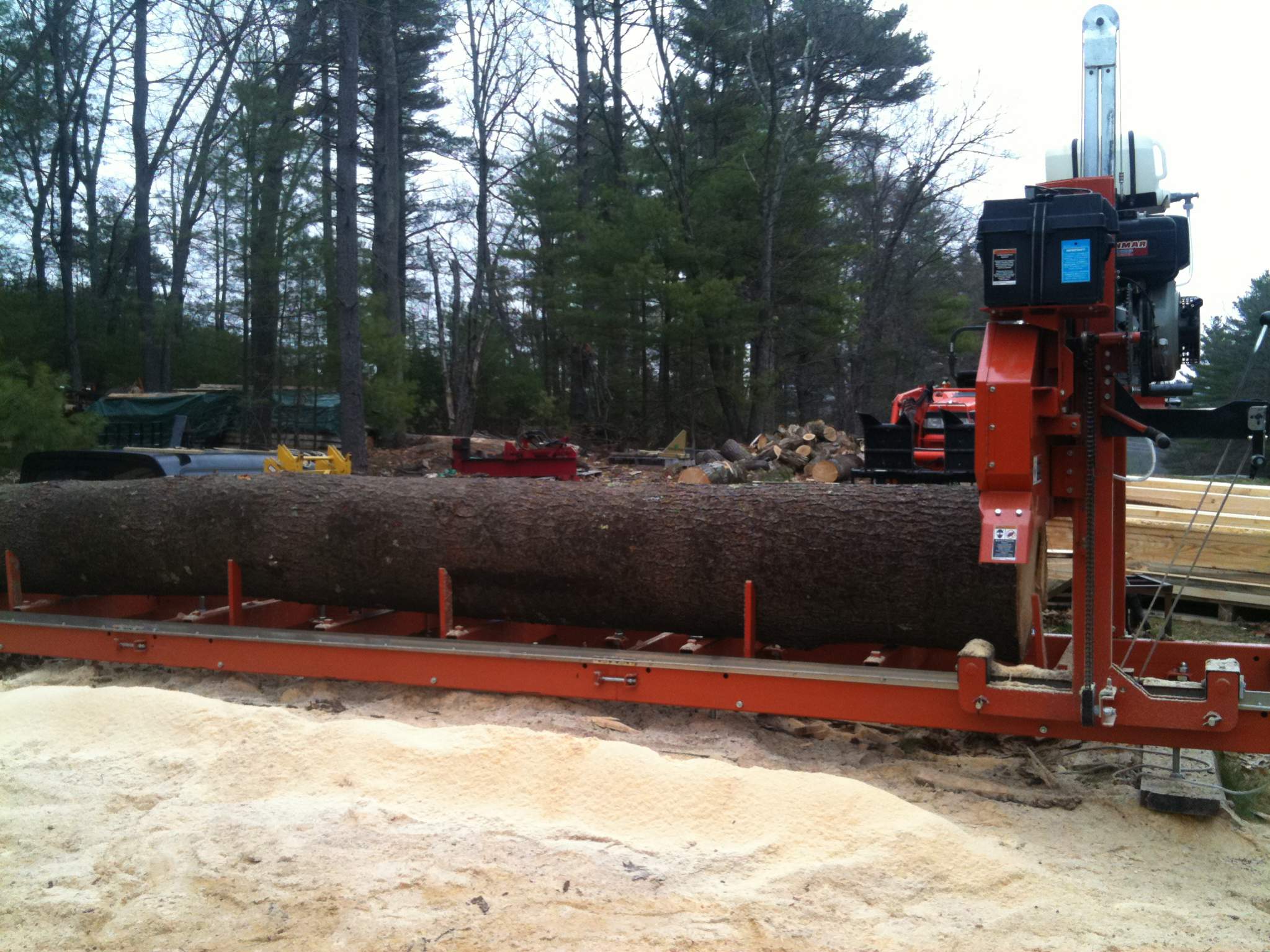

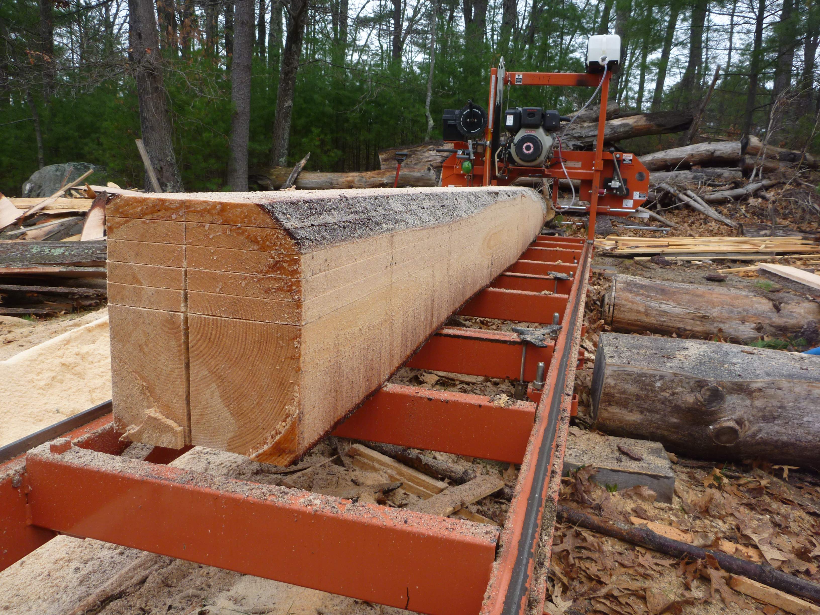

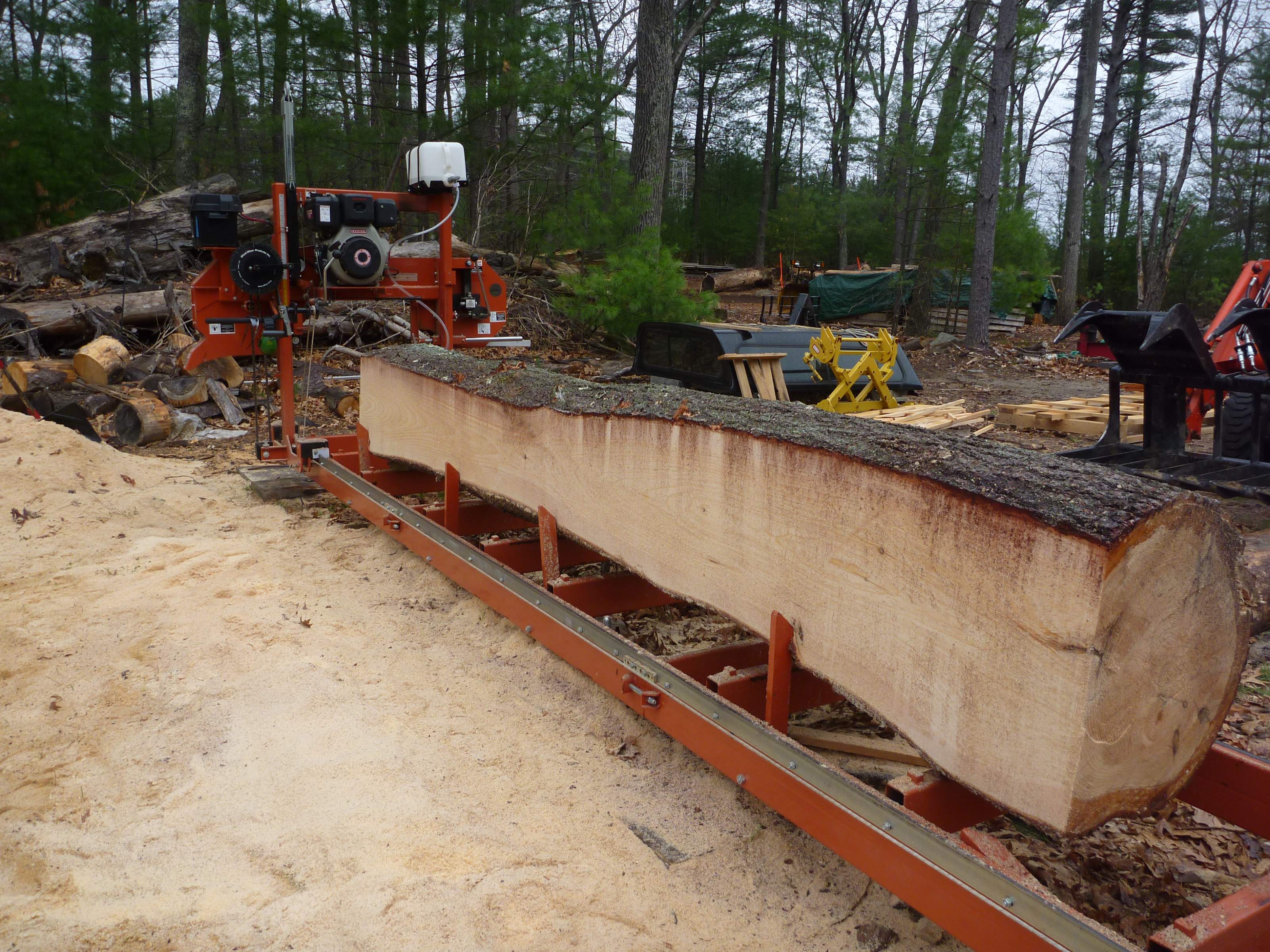

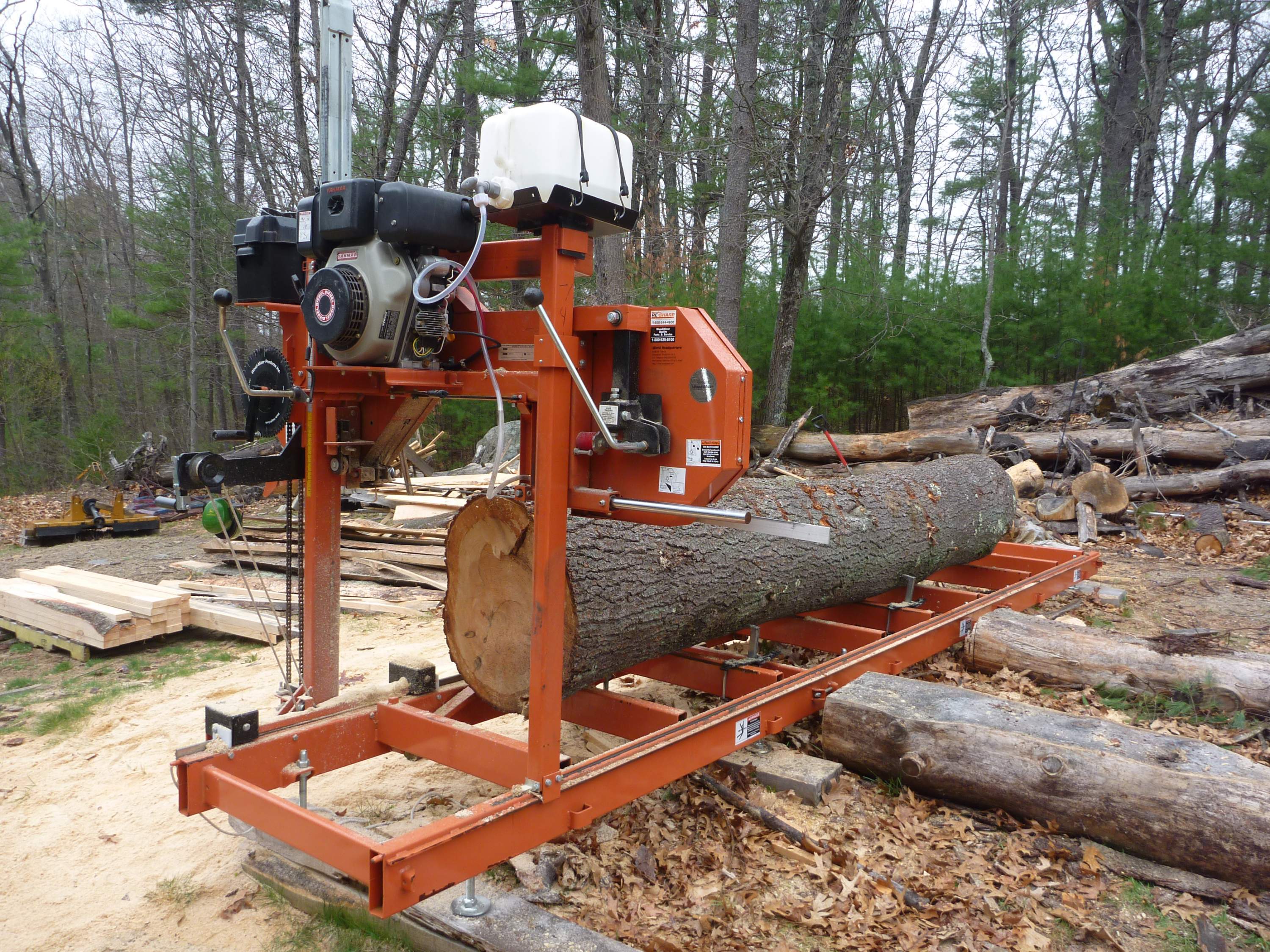

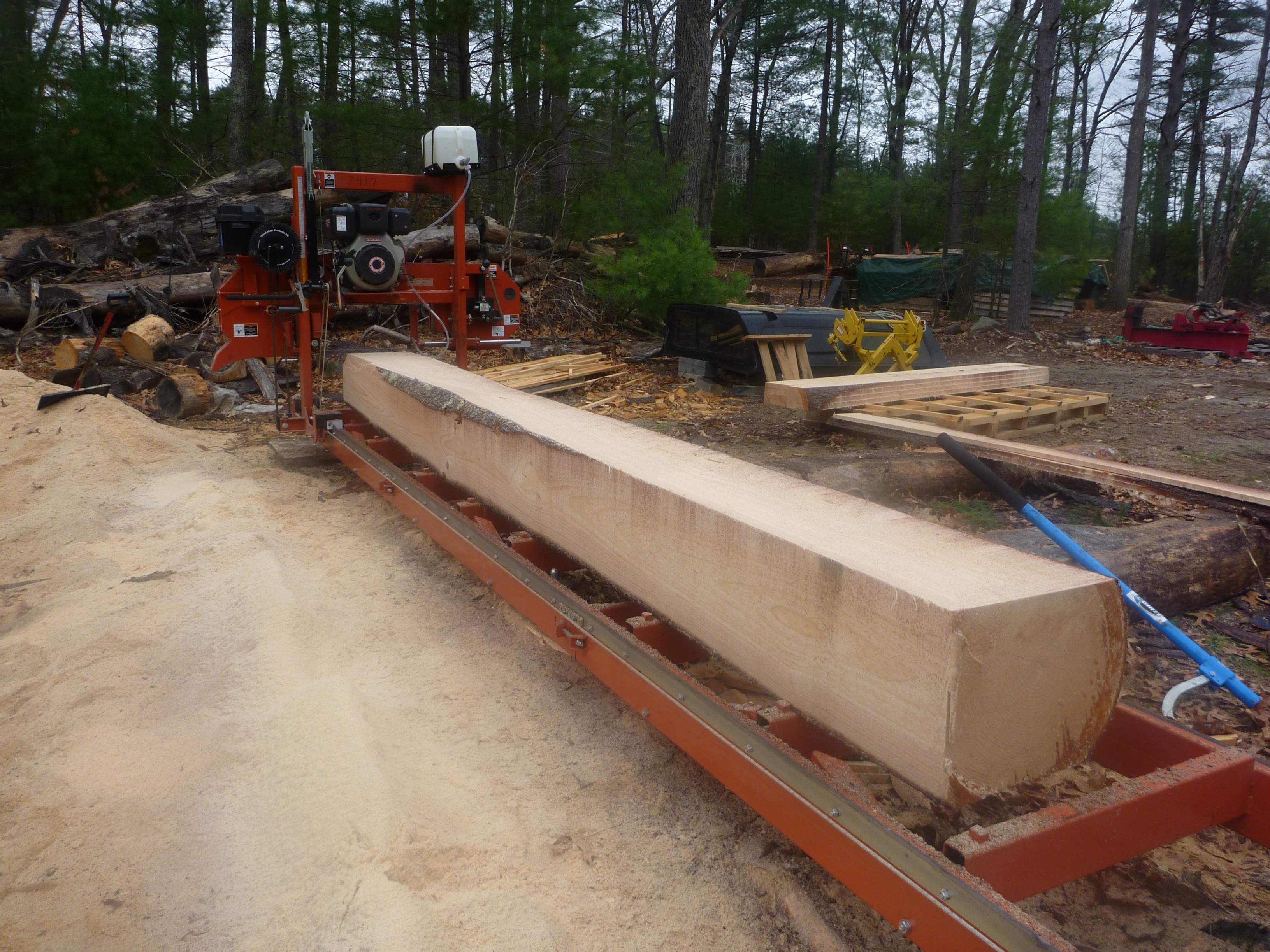

I got a couple hours in today and finally got some worthwhile lumber made. I took the morning to set up the mill on the new timbers ;) along with the new track section. I also installed an hour meter so I can keep track of maintenance. Below are some pics along with observations:
New setup is better leveled and more solid, I can also mill 16' logs now:
Hour meter installed:
Log on the mill. There are little triangles provided for logs that are too big to be dogged down. They nail on the ends with double headed nails to stabilize the logs. It sounds like a hassle, but it's actually pretty quick to setup, and after the first two cuts you don't need them (didn't get a pic of them on the log):

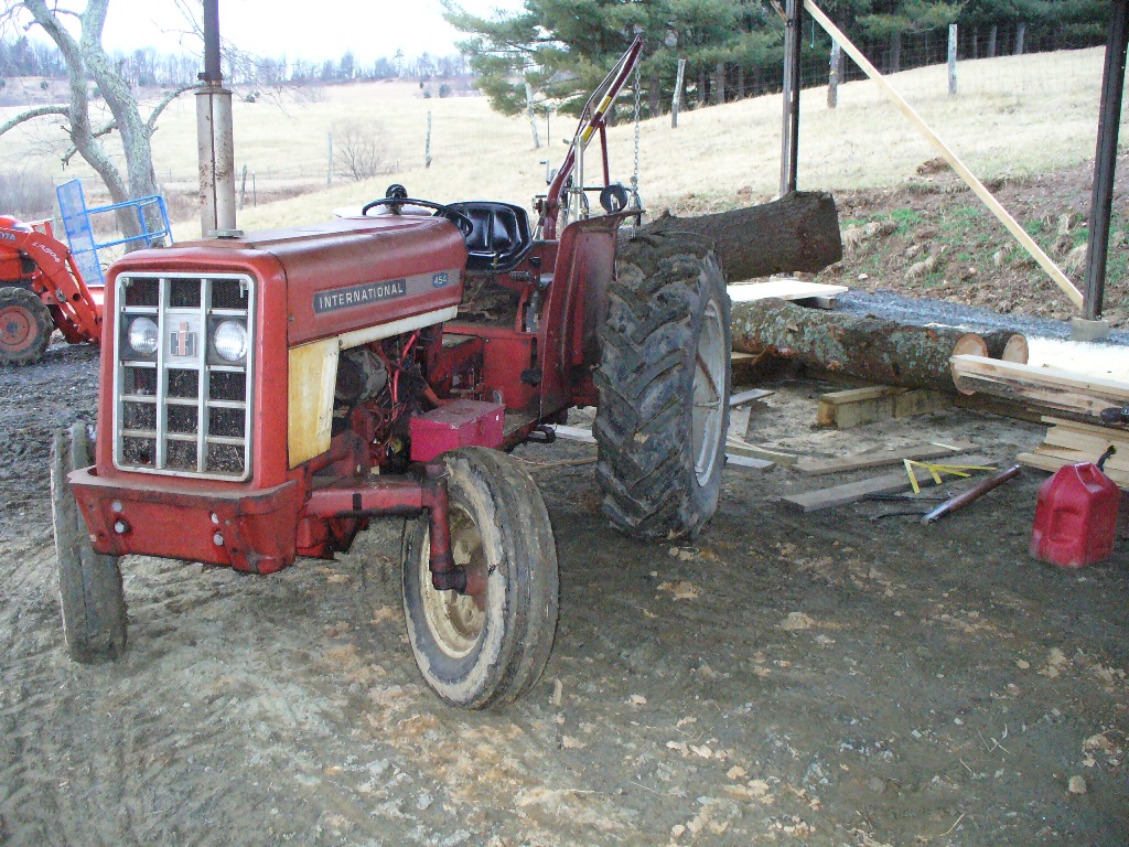

Loading logs with the boom on the back of the International. Not as good as forks or a grapple, but the skid steer is at the other farm for loading logs, this worked OK:
Logs ready to be milled, I had to roll them back as the mill carriage wouldn't clear with them all pushed up that far:
Sawing some full dimension 2x6's out of a cant:
I can definitely see the need for lots of room (and flat ground) around the mill. I'm making 2x6's in 8, 10, and 12' lengths, 1" boards in various widths and lengths (for siding) and I also have a pile of 1" boards that need to be edged. Trying to find enough room to keep everything separated and stacked flat is a challenge.
Piston, what motor is that on your mill, looks like a little diesel? Also, what are your recommendations on a grapple that's ideal for sawmill work?
   / Logistics of small sawmill operation #20
Verticaltrx, what made you settle on this brand of mill? What other options/brands did you consider if I may ask. Also regarding the hour meter, is that an option from the manufactorer or after market?
