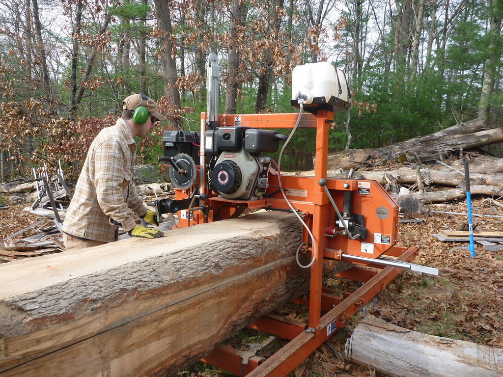

Piston, what motor is that on your mill, looks like a little diesel? Also, what are your recommendations on a grapple that's ideal for sawmill work?
Your correct, the motor is a little 10hp Yanmar diesel. I absolutely love the engine, it has a great amount of torque for it's little size and will run all day on one gallon of gas. I had a hard time finding an hour meter for it though since most of them tie into the spark of the spark plug. I finally had to bite the bullet and spend $90 on one designed to work with the engine.

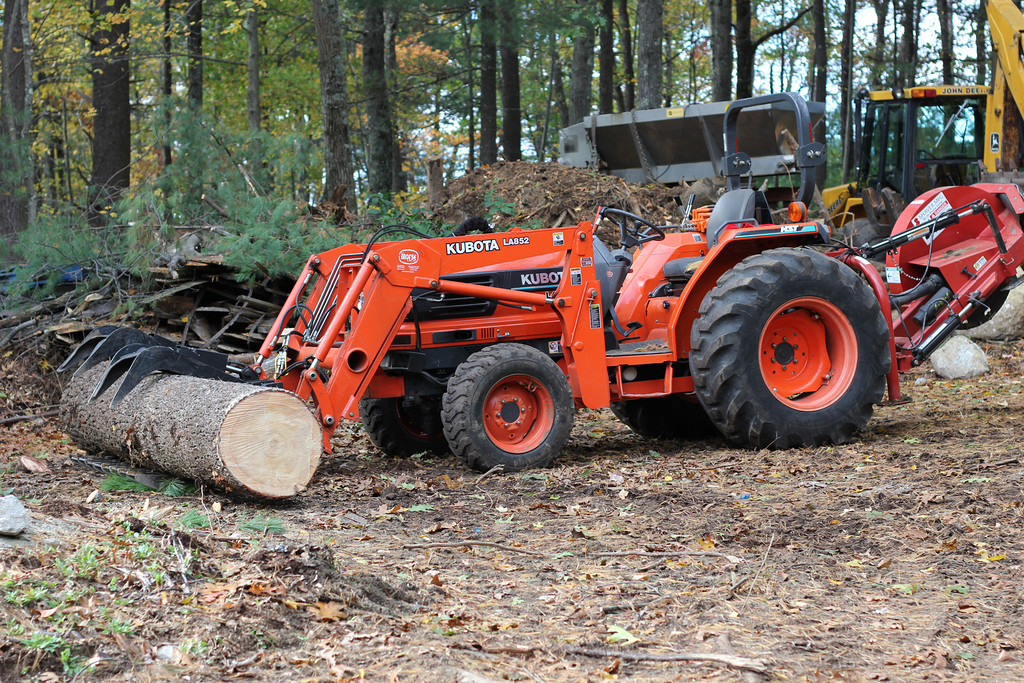

I chose the open bottom grapple from WR Long because of the "versatility" of it regarding the mill. Some open bottom grapple's don't have the flat tines on the bottom, they sort of "curve" upwards throughout the length of the grapple. That type would work well for things like moving slab piles and logs, but the main reason I wanted to flat bottom was to support lumber and timbers using a nice flat surface. With the curved radiused style, you will get "dents" in your lumber because it's only supporting the wood on the outside corners of the squared off lumber. I use the bottom portion of the grapple as my "holding table" for any lumber that still needs to be edged. I keep it low to the ground on the side of the mill that you walk along, and put all my pieces that need to go back on the mill for edging right onto the grapple.
I used my friends root rake style before buying my grapple, and I didn't like how it didn't have that "flat" bottom to it. It was still 10 times better than not having a grapple, but compared to the one I purchased it's a big difference when using it around the mill. I probably would have bought the root rake style as that's what I originally wanted (I think they look so much cooler :D) but after using that grapple I knew it wasn't the best for using around mill. This is also why I didn't go with the open bottom style that has the radiused bottom tines vs. the flat ones. As much as I love my grapple, it can't handle everything...

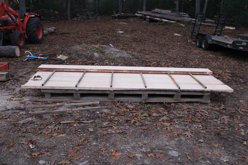

Also, check this link for a great way to stack/sort/store your lumber on homemade "pallets".
http://www.forestryforum.com/board/index.php?topic=48895.0

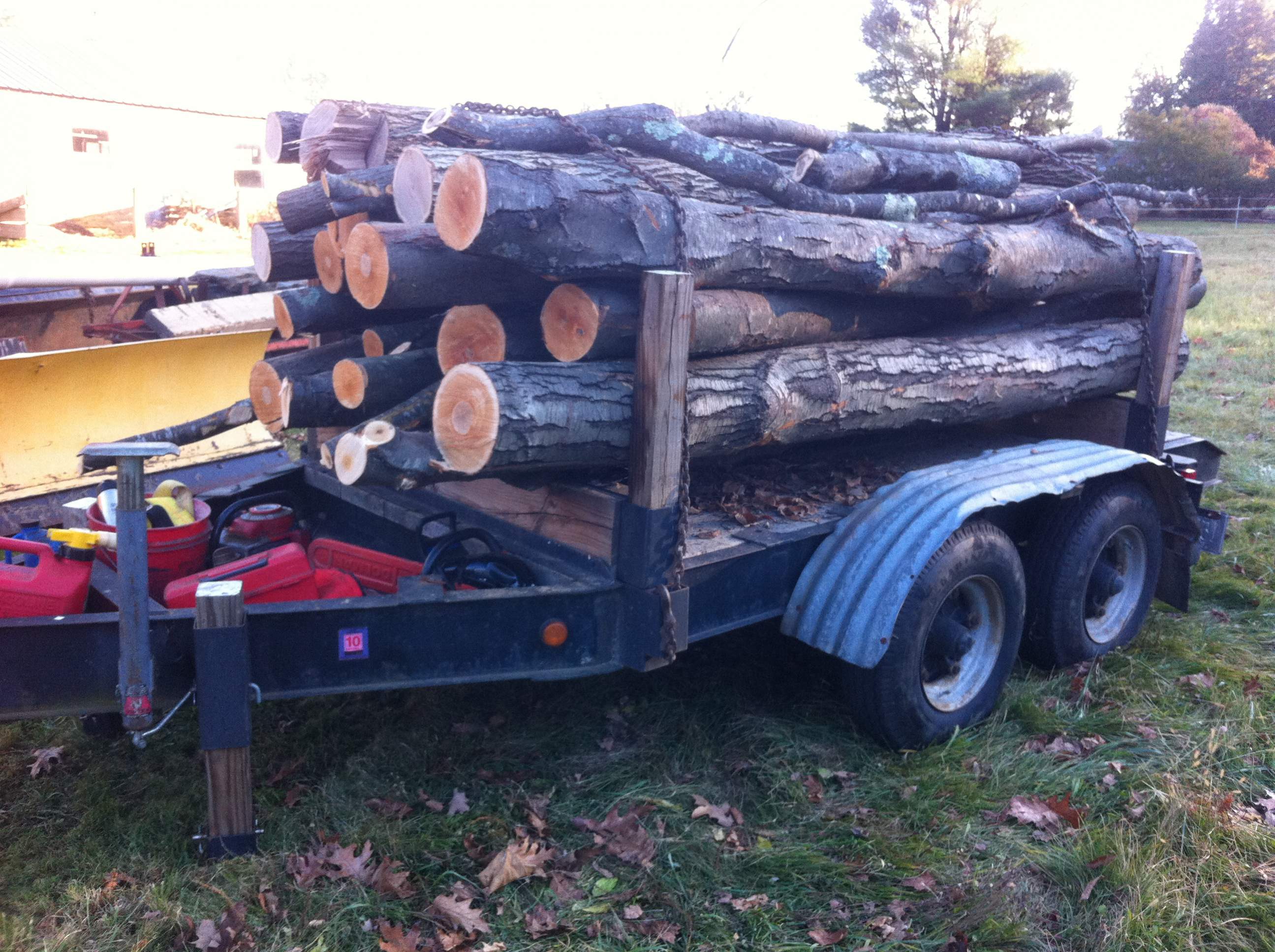

I've found this very handy for getting logs from my woods to my barn. Firewood for now, logs for milling soon. It's an old house trailer with cobbed on fenders, some bunks for PT 4x4s, and decking in the triangle to carry saws, gas, etc. to the woods. I use it on the road occasionally, but mostly in the woods. Could use brakes on some of my downhills, though...
I agree about the grapple to load for clean logs. I winch when I have to but try to get to the felled trees with the grapple. Sometimes wish I had a mill but not enough use for one.

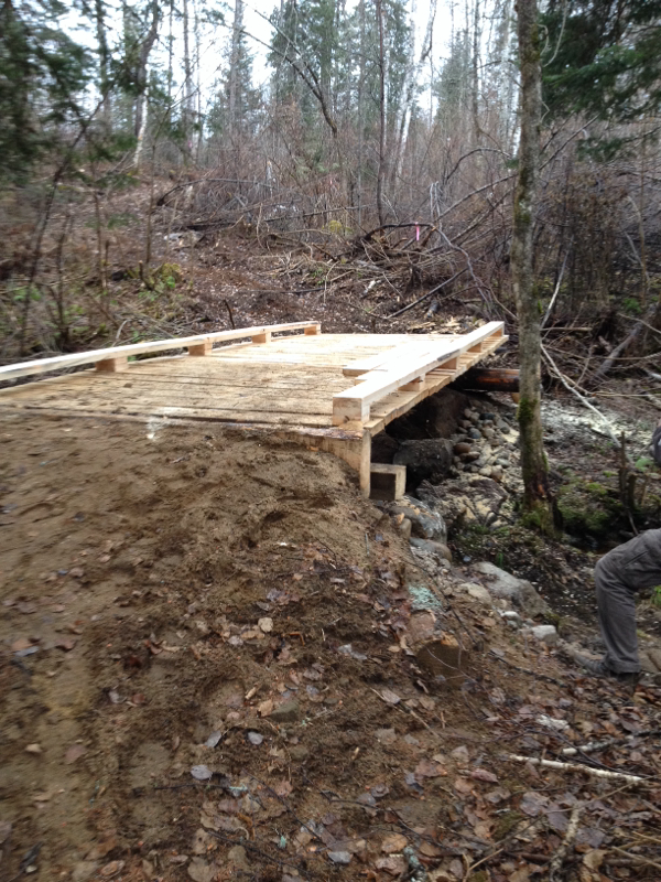

The bridge we made with milled lumber

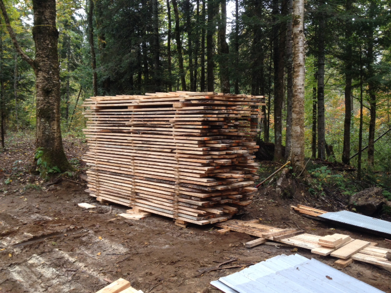

About 5 hours of cutting 1x6 boards

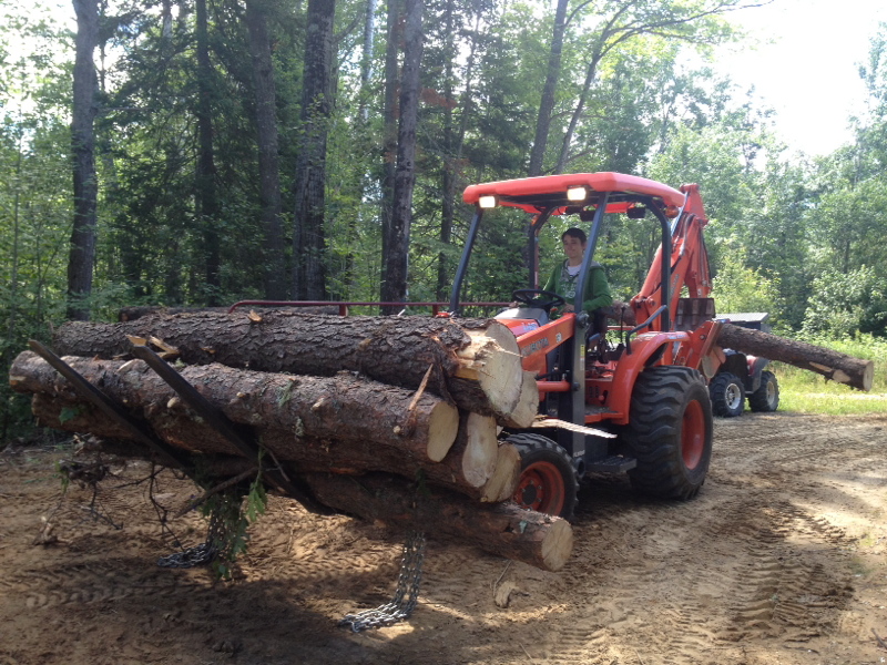

I pull the logs out of the brush with the backhoe and bring them to the mill with the forks you don't need a grapple

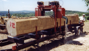

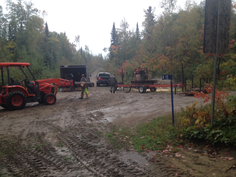

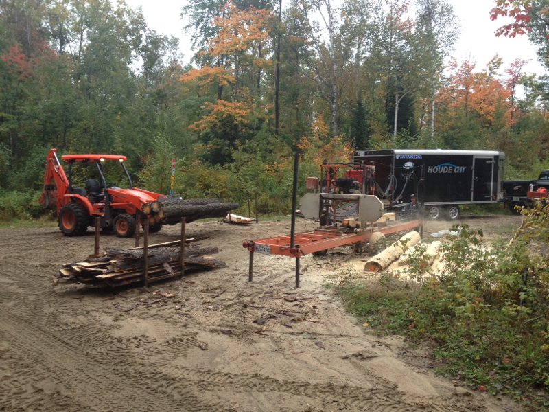

And this is our set up with my friends homemade fully hydro mill amazing machine work with we had 2 guys trying to keep up to him swaying boards

Awesome pics Andre! I couldn't move that many logs at once with my grapple!
Nice machine.
