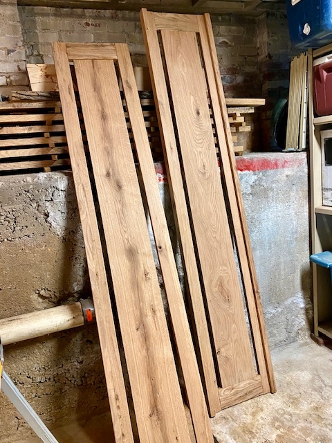

Dowels are good! but I don't like smooth ones. There are sizing plates that groove the dowels when pushed through.
Rolling the dowels under a coarse rasp with heavy pressure works too. So does just producing rough facets by rubbing on sand paper. Anything to prevent a tight fitting dowel.
Got to leave room for the glue!

Your use of dowels is just fine. Also, what you were told regarding required jointery for end/side grain is spot on.
One thing that may make doweling easier for you is sizing the dowel before use. I have a 1/4" thick steel plate with 1/4", 3/8", 1/2" reamed holes I made years ago. The dowel is simply driven through the appropriate hole to size it assuring good fits.
Using air dried lumber for interior projects can be tricky. 12% is about as dry as you can get; it usually takes way longer than a year too. Are you using an accurate meter? Know that wood usually climatizes to 10% in heated homes (throughout the nation). Cross-grain jointery (in completed projects) captures the wood and trys to prevent it from moving. Dry wood is compressed as it heads toward 10% MC. Wet wood (>12%) will try and shrink as it heads toward 10% and crack when it is prevented from doing so. Be sure of your MC if you are determined to use air dried lumber.
Thanks. Good info. I think I have a decent moisture meter but it is only measures surface. Readings varied among boards from 12-16%. The tree was a blow down and had been dead for about a year but trunk was not touching the ground so no rot at all. I know the wood wouldn't dry out much before milling but maybe some? Was milled about a year ago. It might have been 18 months.
This is a learning process for me. Doing without a table saw, jointer or router table makes things even more challenging. Fortunately these shelves will be going in a utility closet that doubles as my cloths closet so it will only be seen by me and my wife. As long as cracking doesn't compromise it structurally I will chalk it up to a learning experience.

Thanks. These dowels are fluted for what its worth. Can't speak to the quality of them or the value of the fluting; they're just what I happened to buy.
