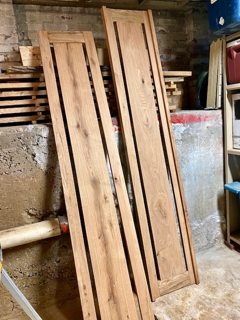

Here is what the sides of the shelves look like. These are 7 feet tall. The edges are a corner made of two 1x2 pieces glued along the edge. I think I used 5 dowels along the length of each of these.
The horizontal pieces at the top and bottom have three dowels on each joined edge. Since these are edge grain to end grain I think the dowels are helpful.
But, where they have been really helpful is getting all of this aligned for glue up.

On the pictures shown no dowells need to be used. The Center pieces are just straight glue up placed in a slot top and bottom. The outer pieces easily lend themselves to a half lap joint which will be stronger than dowels!
Comments much to late for the present prodject!

I don't have a router table or table saw. So slots, groves and even half laps really aren't an option. Not skilled enough for hand cut joinery.
I have been told that end grain to side grain joints are not ideal for glue alone. Maybe that's wrong. Live and learn.
So now I'm curious. If I did not need any dowels for this project, when do you need to use loose tenon joinery like dowels or dominoes?

Your use of dowels is just fine. Also, what you were told regarding required jointery for end/side grain is spot on.
One thing that may make doweling easier for you is sizing the dowel before use. I have a 1/4" thick steel plate with 1/4", 3/8", 1/2" reamed holes I made years ago. The dowel is simply driven through the appropriate hole to size it assuring good fits.
Using air dried lumber for interior projects can be tricky. 12% is about as dry as you can get; it usually takes way longer than a year too. Are you using an accurate meter? Know that wood usually climatizes to 10% in heated homes (throughout the nation). Cross-grain jointery (in completed projects) captures the wood and trys to prevent it from moving. Kiln dried wood (6-8%) is compressed as it heads toward 10% MC. Wet wood (>12%) will try and shrink as it heads toward 10% and crack when it is prevented from doing so. Be sure of your MC if you are determined to use air dried lumber.
