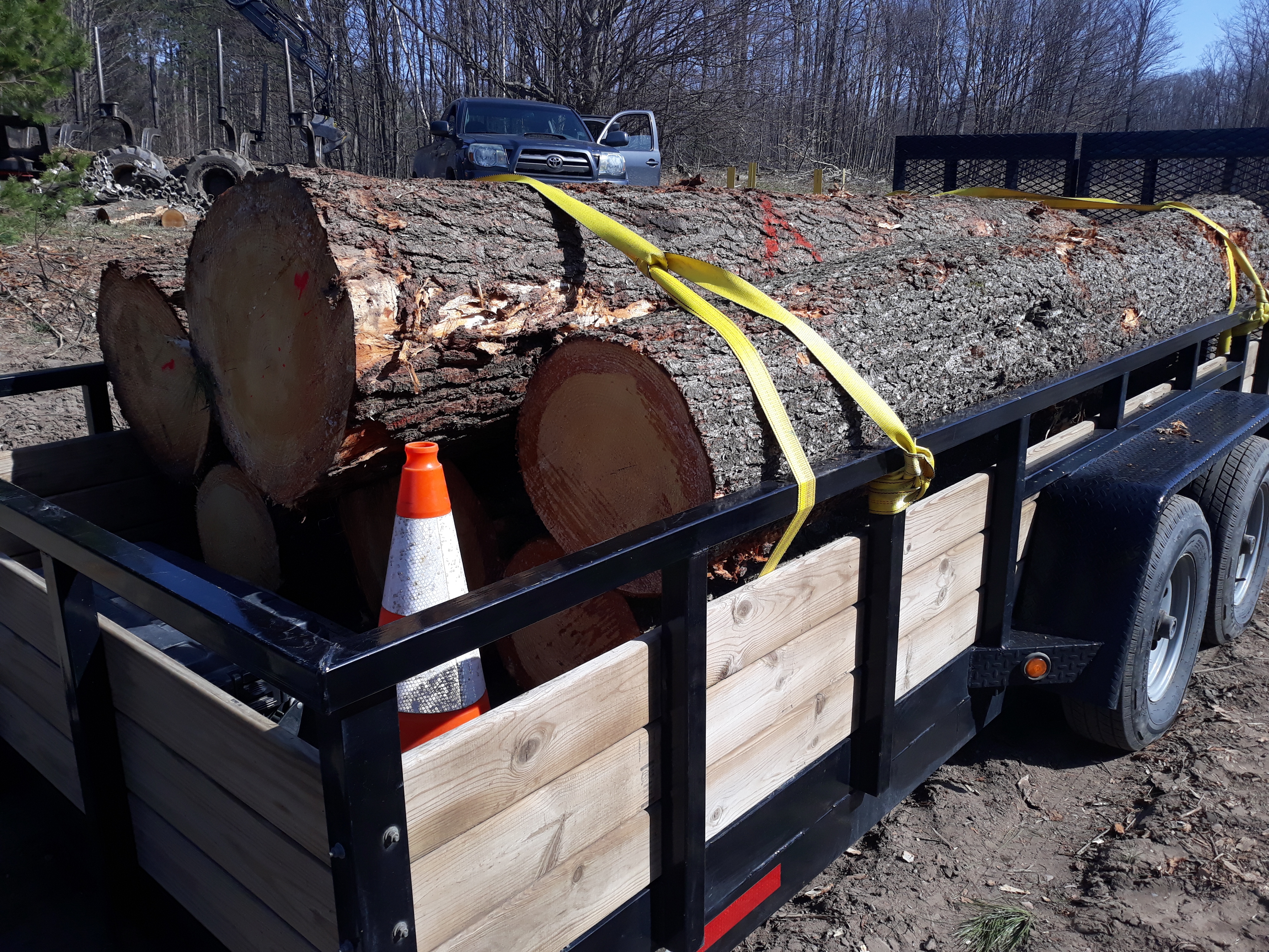

   / Guess I'm a Sawyer now? A 1991 Kasco "The Saw IIA" Sawmill is mine! #41
2 of 3 loads
   / Guess I'm a Sawyer now? A 1991 Kasco "The Saw IIA" Sawmill is mine! #42
4th load, different job

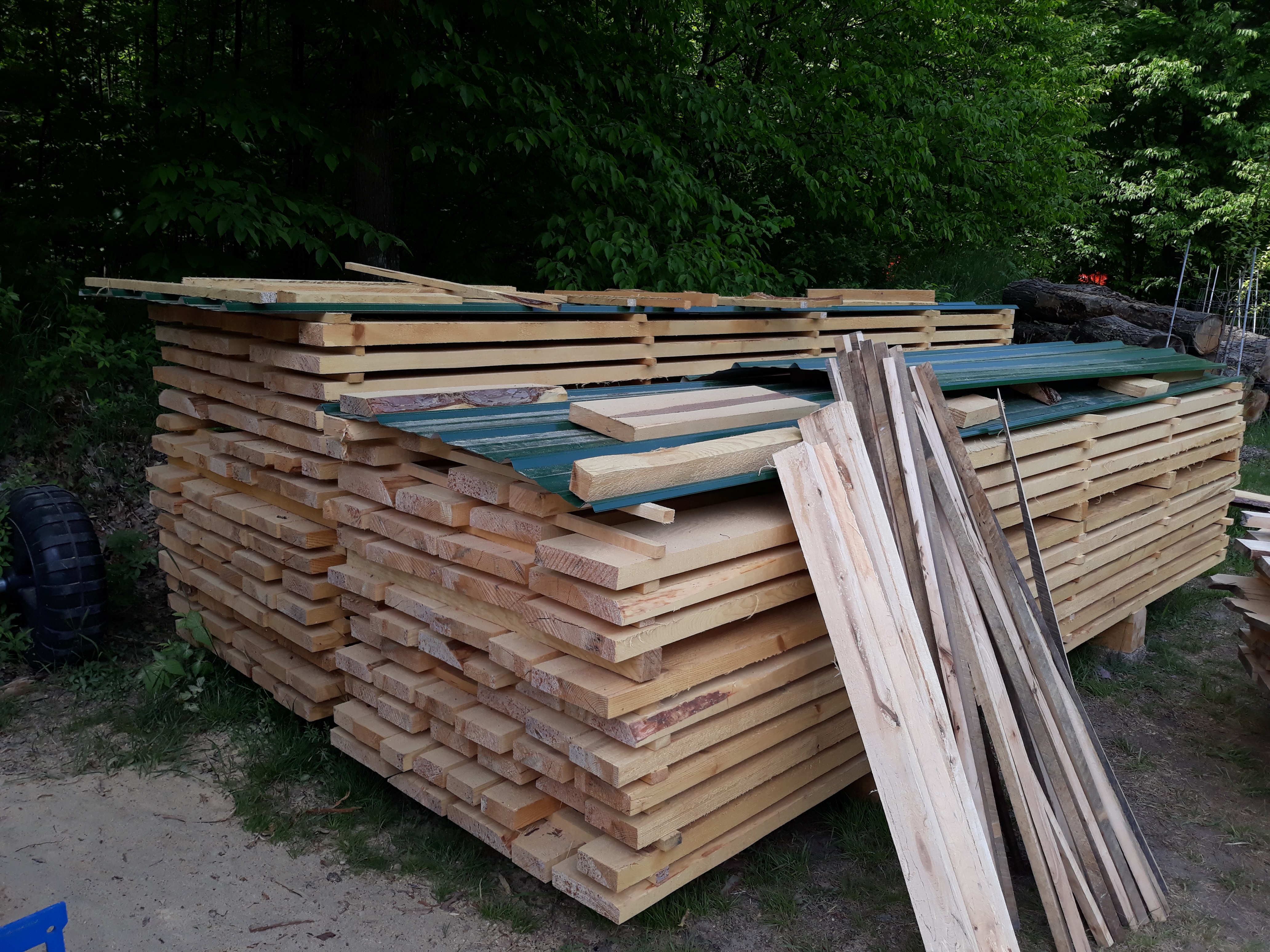

   / Guess I'm a Sawyer now? A 1991 Kasco "The Saw IIA" Sawmill is mine! #43
stacked and stickered

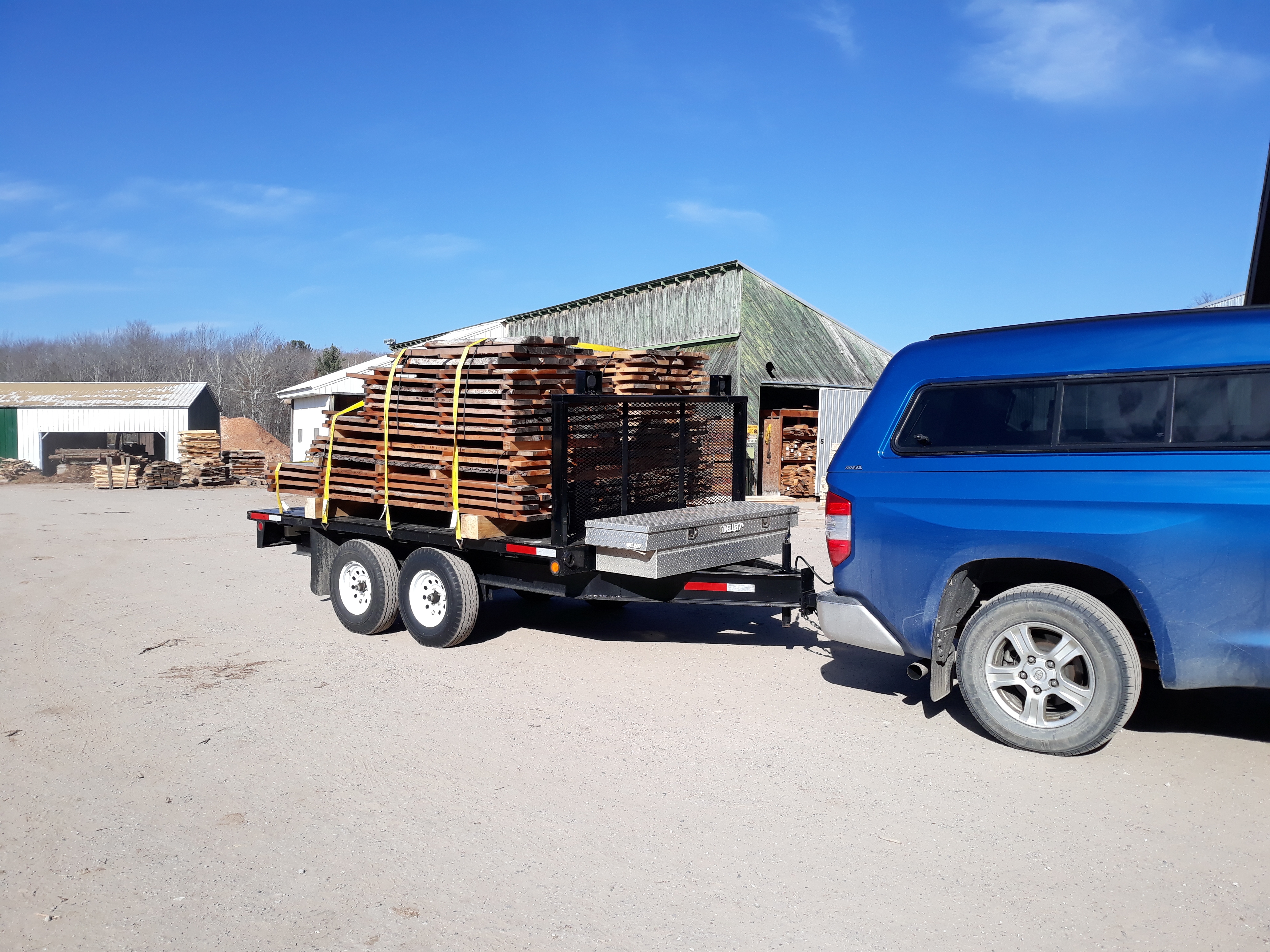

   / Guess I'm a Sawyer now? A 1991 Kasco "The Saw IIA" Sawmill is mine! #44
picking up 1 stack of dried cherry, and 1 stack of dried oak from a different sawmill that has a kiln.
#45
That's a big ass log! nice work.
How is your experience with stacking outdoors like that, and only covering with a piece of metal roofing? Does it dry out well enough even with rainstorms and snow keeping things moist?
   / Guess I'm a Sawyer now? A 1991 Kasco "The Saw IIA" Sawmill is mine! #47
It will end up just as dry as any lumber out of a kiln, that's stacked in an out building, and left there for a time.
As long as the green lumber stack is covered well enough to keep all the rain/snow off it.
SR
   / Guess I'm a Sawyer now? A 1991 Kasco "The Saw IIA" Sawmill is mine! #48
A full roof shed with open sides and generous overhangs would be better. But more expensive. I think meter readings 10-13% at edges, center pieces might reach single digits. But some end up in the attic above the workshop and temps get up in the 90s+. Cherry and oak were dried in kiln ans stored inside. Outside stacks mostly red and white pine. Whie cedar was out about a year then put inside storage barn, no heat. Jon
