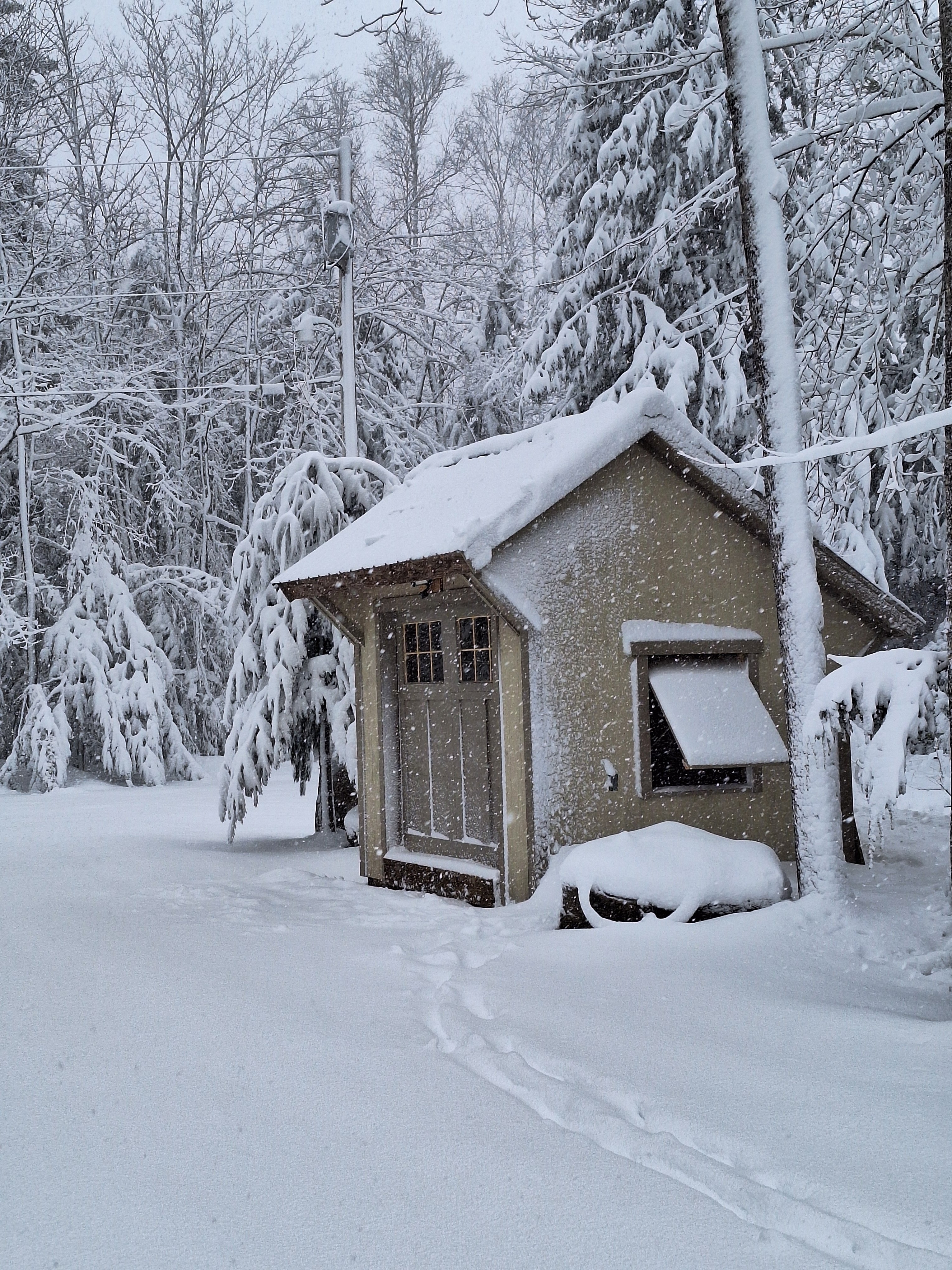

My first project;
My generator building.

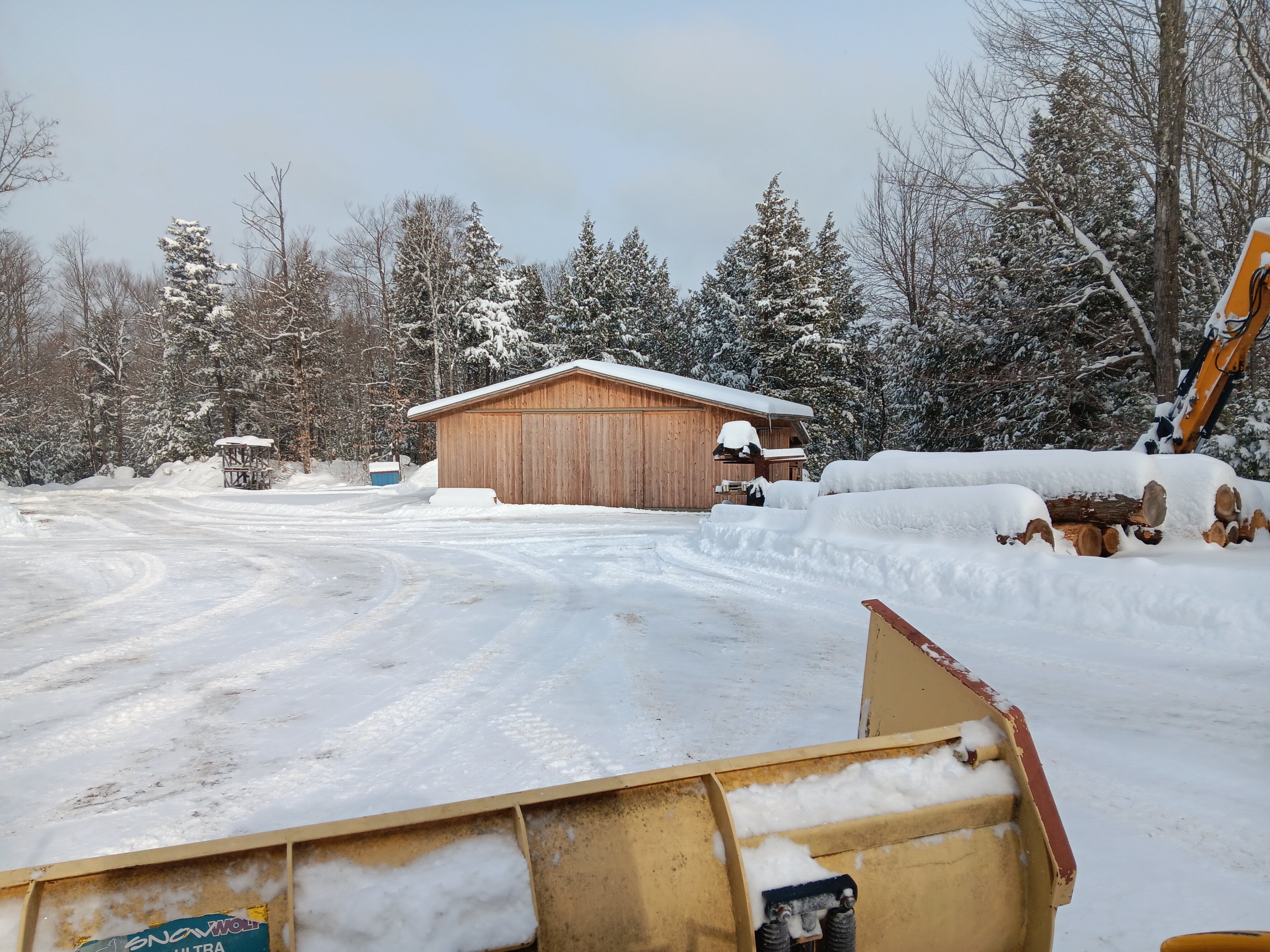

And my 2nd project;
My sawmill building!
Enjoy your mill!👍
