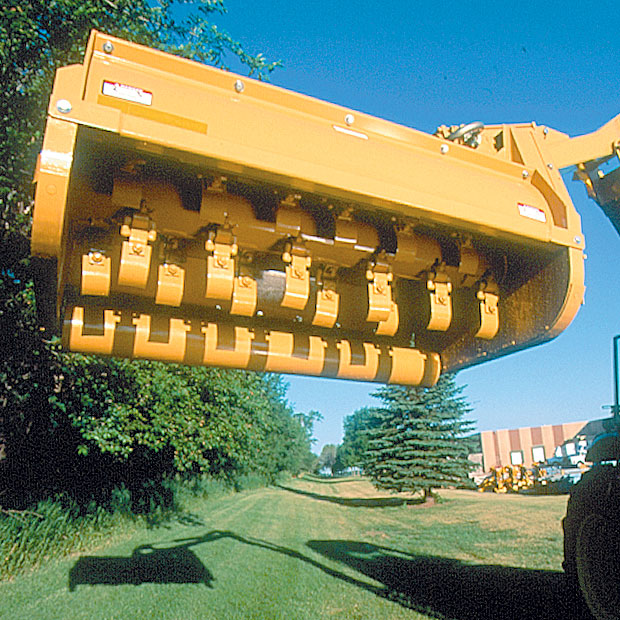

I agree with you on the balance, only when new. Below is a picture of odd and even hammers. On the 5 hammer row, they have to add a counter weight to balance against the 6 row hammers. If any one of them gets damage or wears on one side, the flail will come out of balance. If you resharpen, you risk being out of balance unless you do the same grind on each hammer. You could weight each one and grind off some more for equal weight.
If one were to lose a hammer, you can still adjust by filling in the missing hammer from one off the end. You have to remove another one from opposite sides of the rotor, to keep the balance.
About the only people that could balance a rotor after use would be something like a drive-line shop . I don't know if they would do that kind of thing though.

OK, I have risked life and limb to dig around under the Caroni flail while it was precariously suspended from the FEL. :ashamed: Here is what I found:
The Caroni TM1900 rotor has a symmetrical balanced array of flail knife stations. There are two opposite rows of 8 stations each with two knives and two opposite rows of 6 stations each also with two knives. This makes a total of 28 stations (8+6+8+6) and 56 knives.
There are no welded balance weights and as evident from the finding above, none would be necessary as it is a balanced arrangement of knives.
So, I guess this means that there are two types of flail rotors; those that are inherently balanced like the Caroni, and those that require welded counterweights to offset the assymetrical blade arrangement. I'm sure some flail engineer can expouse on the virtues of each type. For my purposes it just seems that the inherently balanced type has the advantage of being able to change blade type/weight without needing to dynamically rebalance the rotor (so long as all blades are changed at once). It also allows the rotor to remain in balance as knives wear so long as they wear relatively evenly. There are no gaps in the cutting with this 8x6x8x6 station arrangement so I don't see any disadvantages of the balanced type.
