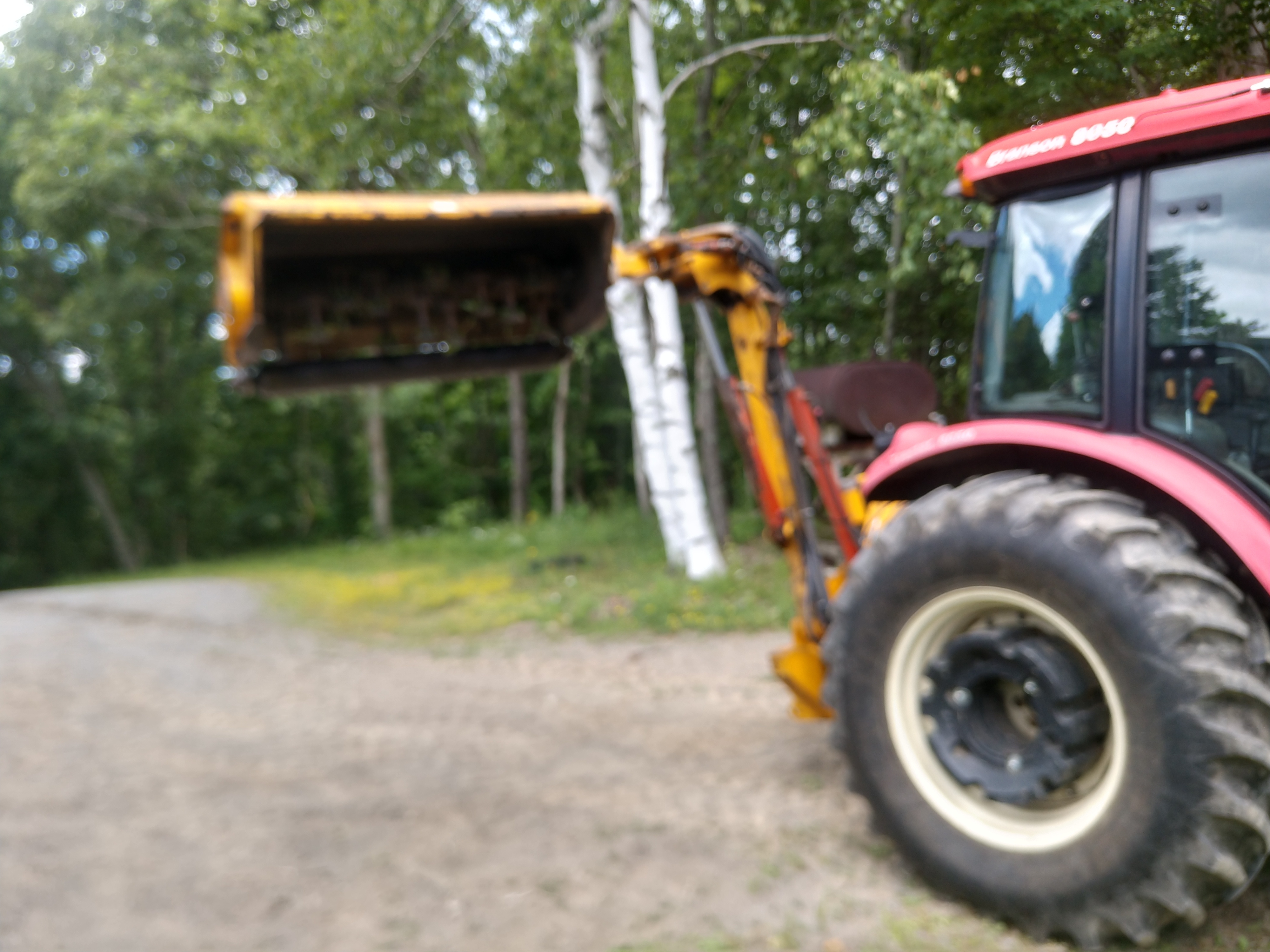

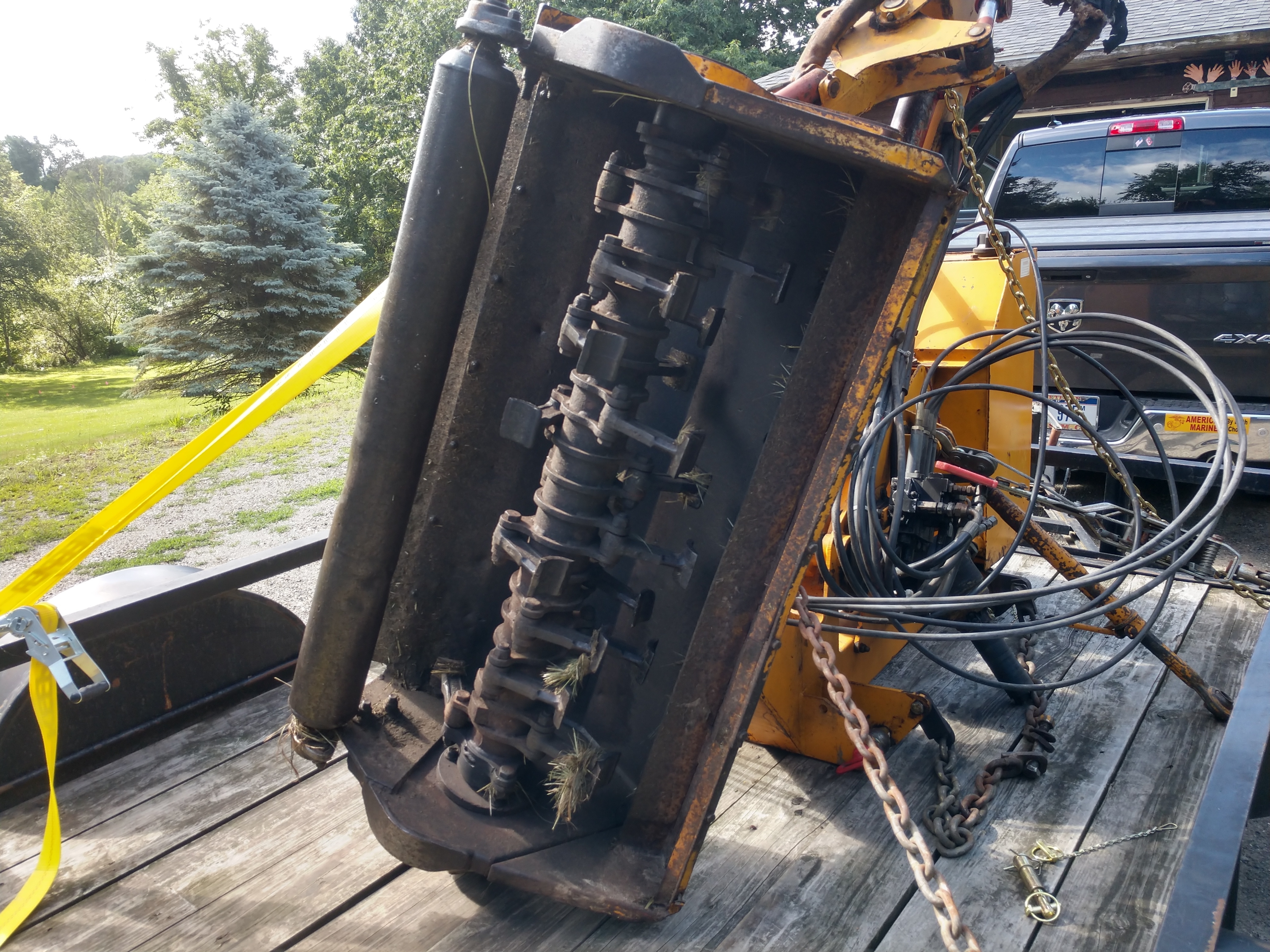

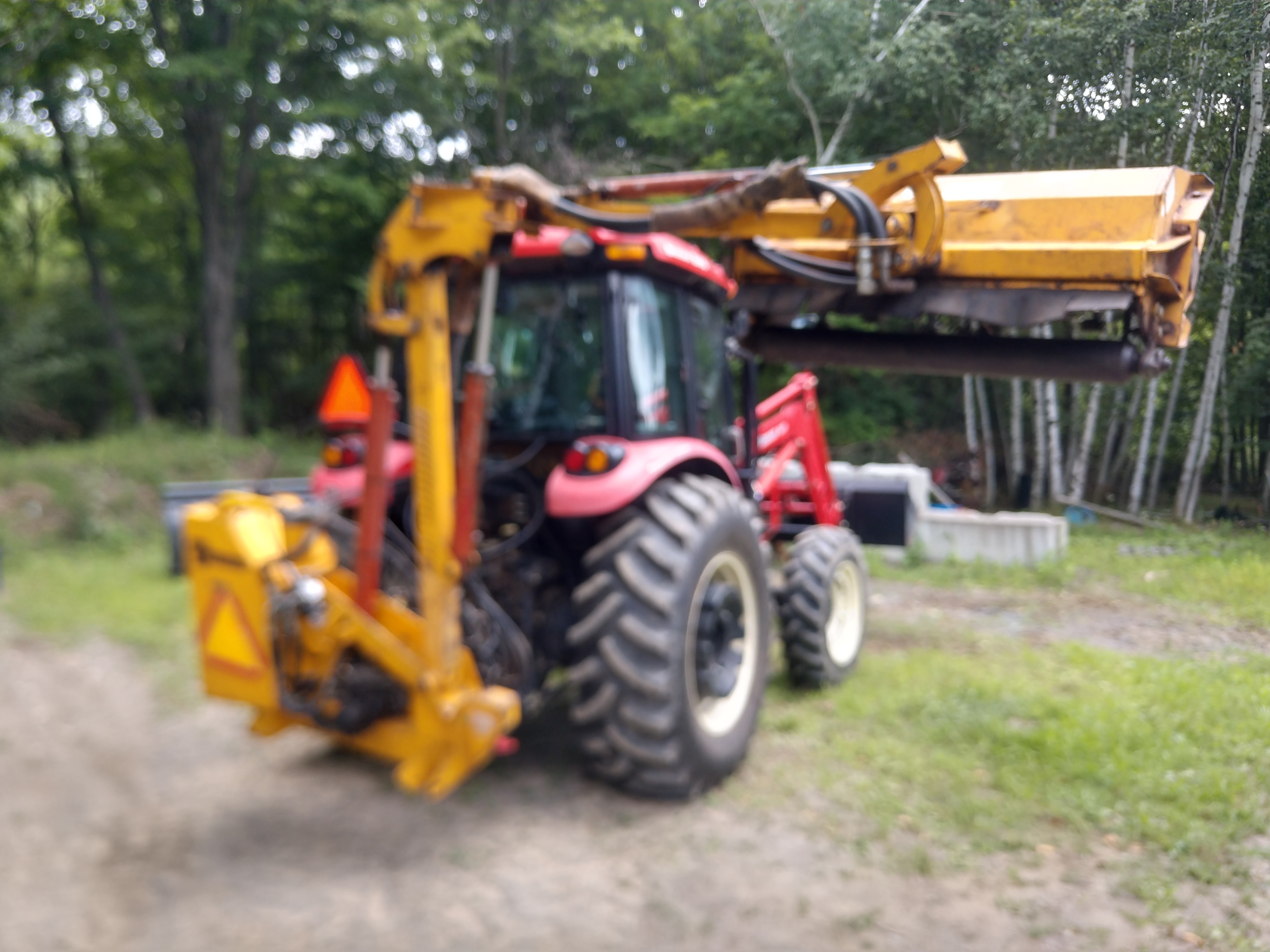

/ Flail Mower for Hedges? #9
This mower works well for hedges and trimming. It is a bit of a pain as it really magnifies and irregularities in the ground while mowing. It is much more open in the front of the flail so it's not shrouded as much as the ditch bank units.

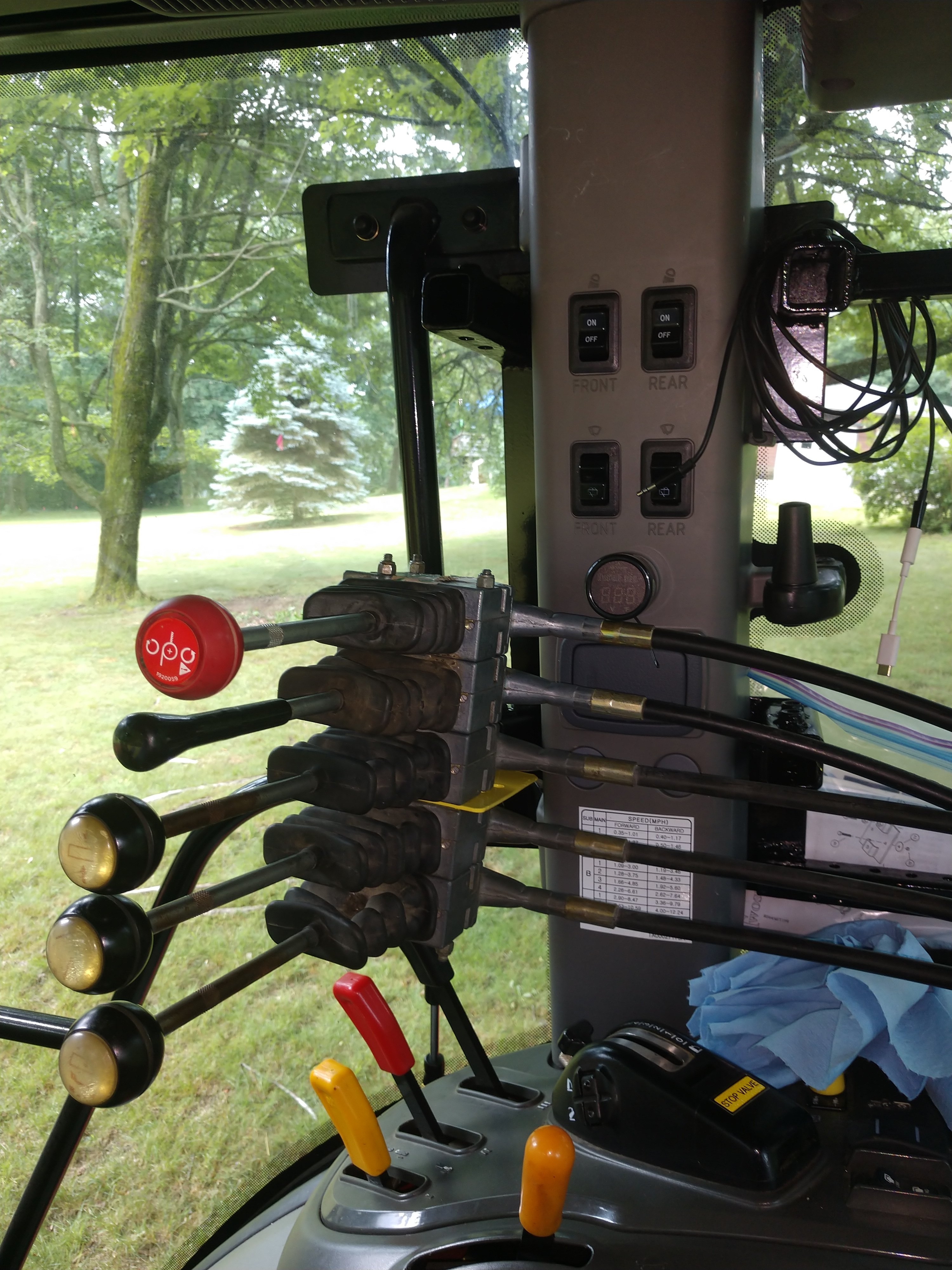

The controls can keep you quite busy also,...........the flails are more of a scoop style

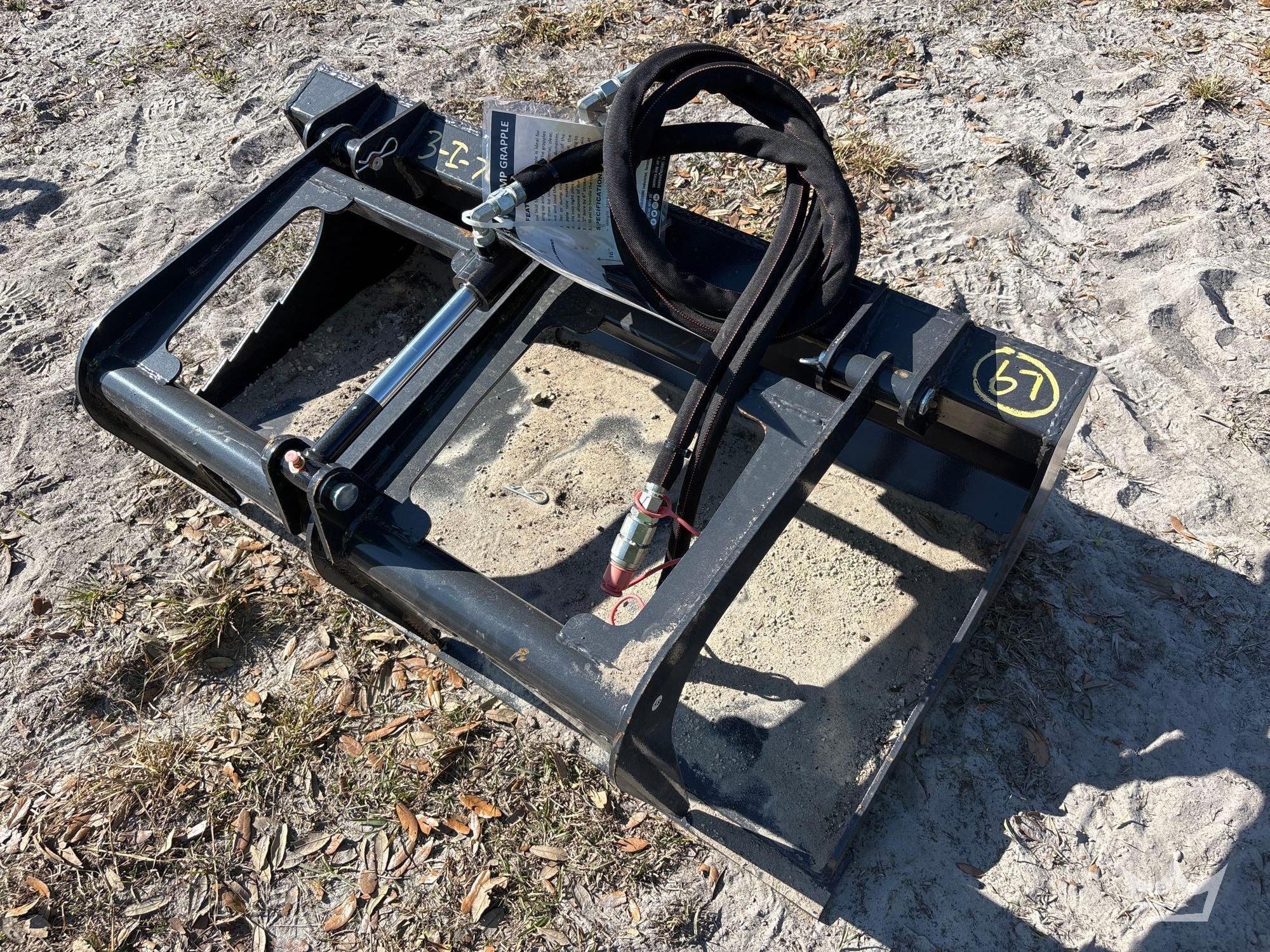

I keep seeing adds on Facebook for a sticker bar that you mint onto a loader bucket with clamps. Laneshark maybe? Know nothing about them other than seeing the adds.
That would allow vertical and horizontal positioning. Then you'd only have to worry about gopher holes causing a dip in your top of hedge.
