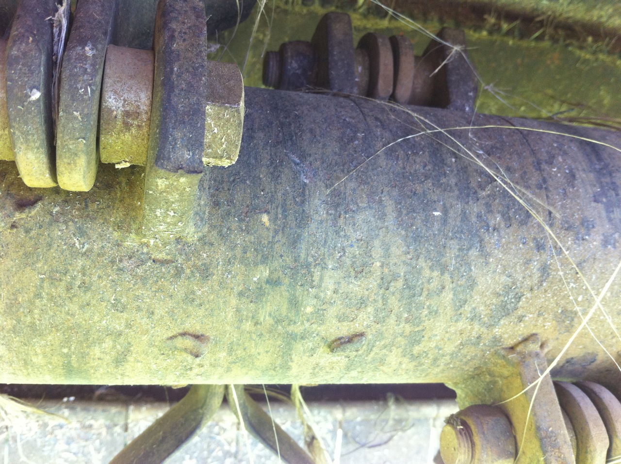

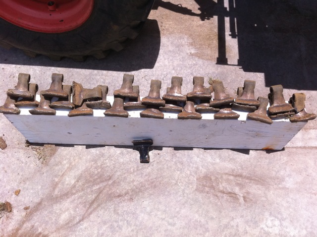

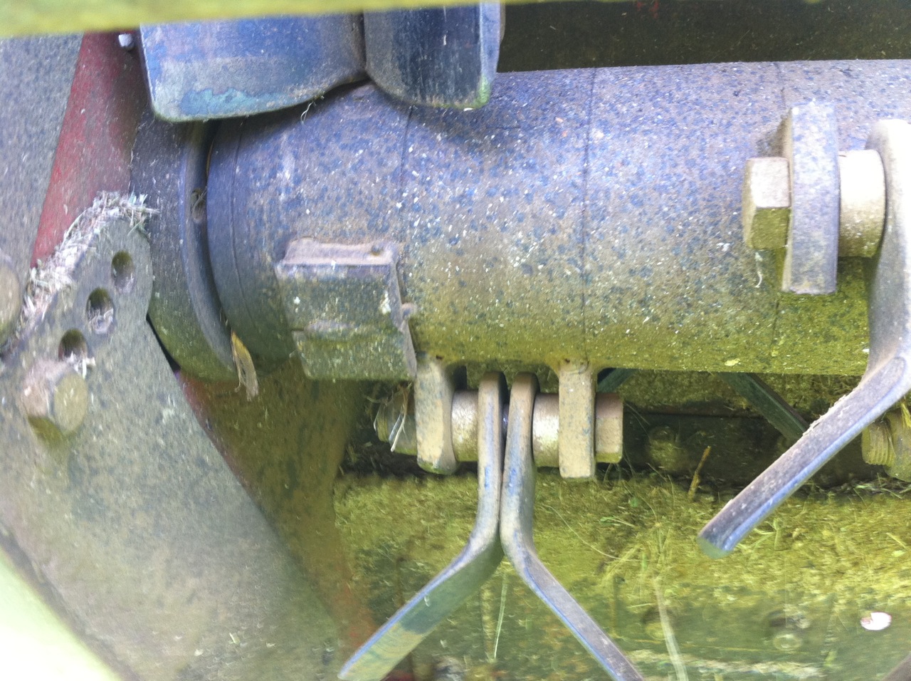

OK, I also got under mine a bit. Here are the pics.
Appears to be some effort at balancing, 1- a small plate welded at one end of the shaft. 2 - 2 smallish beads about 1/3 distance the other end. Could be just sloppy welding, but the rest of the shaft is clean so these appear to be there on purpose.
As for knife weight... I don't have a scale, but I did fashion a "knife-edge" balance and my hammers are definitely heavier than the grass blades.
Overall, I consider mine to be quite tolerant. I really banged up my hammers before I replaced them. I only got a noticeable vibration if I severely damaged a hammer, note the one on top far right.

Thanks for going to the trouble , those small weights are what was put there at the factory to Dynamically balance the rotor with the knives they put on at that time . The replacement knives would be somewhere within the allowable weight specs so the mower should always run pretty good . The absence of any large counterweights is apparently because of the straight rows and even numbers of knives that are fitted . So I digress , some , flail mowers run straight rows of knives and some , run staggered which requires a counterweight and some run a double helix which run counterweights .
My Cabe's run a large one on each end , the Berti runs 3 smaller ones , one on each end and one in the middle and my FAE excavator mulcher runs 2 large ones on each end which is (i think) a double helix , they are all to compensate for the knife arrangement not only to take out any harmonics the rotors may have had at the factory .

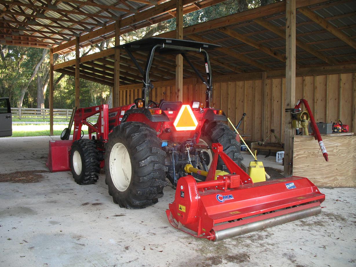

Nothing new here, just a pic of my dad's month-old Caroni TM1900
Hey, no overflow oil stains! Did you forget to put in oil or was this before any mowing or did you just clean it up for the photo? You cannot be a member of the TM1900 club without oil stains.
/ Let's talk flail mowers #956
Yeah, weird, remember how I said AgriSupply gave us a sheet telling buyers to fill the oil only to the lower level ... Well, the guy outside that was getting the mower prepped & ready to lift & put on our trailer said he was having a hard time getting the oil out, since he was trying to hurry, etc., & really made a mess, oil was all over the mower. And it's very stinky oil, as you know. My dad wiped that all up, started to empty out the "extra" oil, then decided to just let it spill out until the correct level, & clean it up as needed. So far none has spilled out ... yet, the oil is in there & above the low mark. I know his land/ grass isn't that smooth ...
