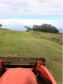

Noticed that from time to time there's questions regarding flail cut so as I mowed today I figured I'd post something of a before and after pic.
In the attached pic you can see where I was mowing today. It used to look like the area to the right outside the fence. Not too bad for former cane field turned pasture.

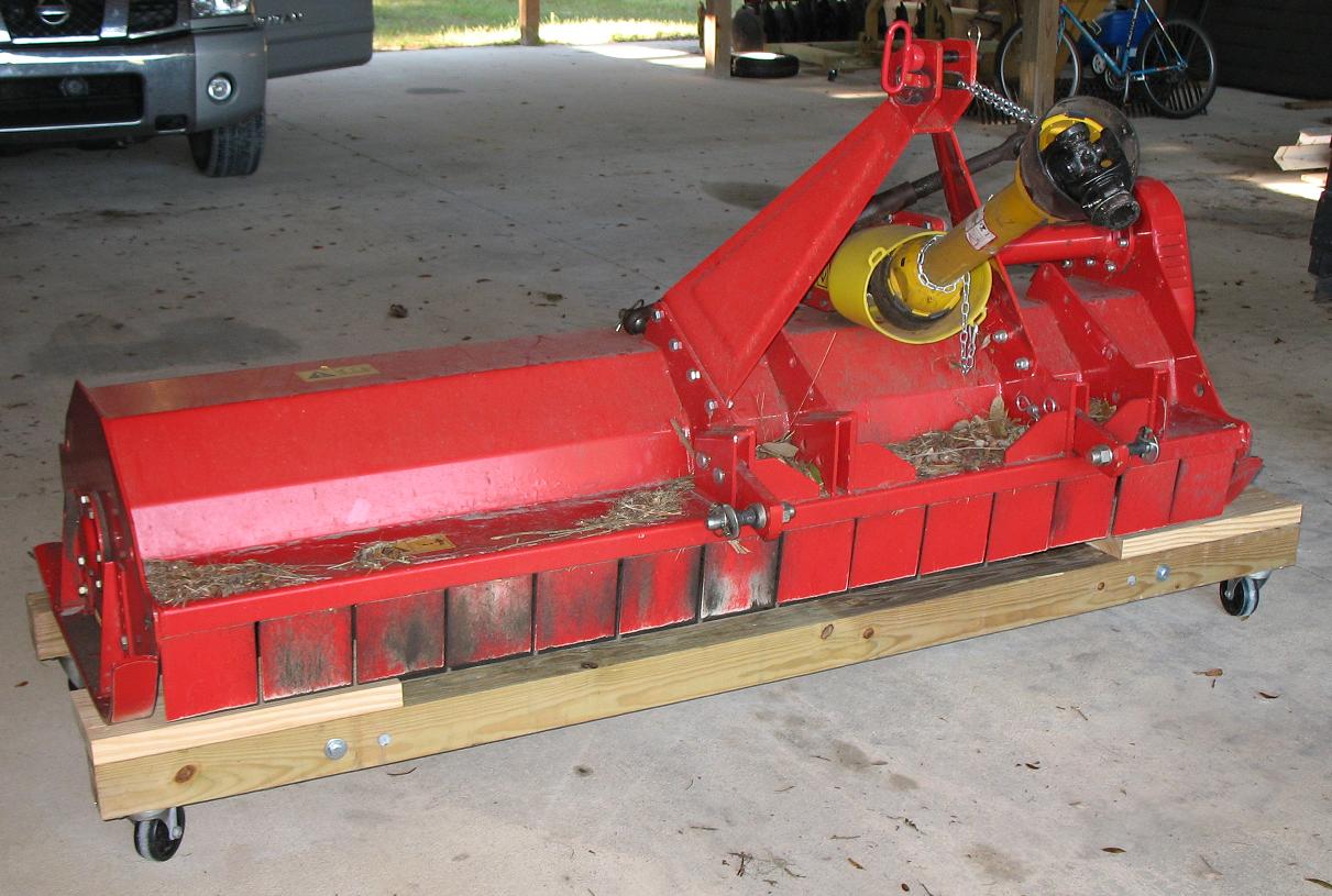

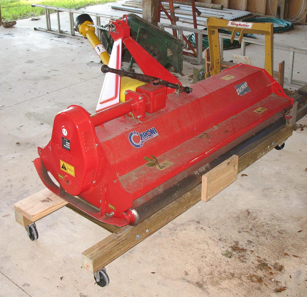

The dolly I made for my dad's Caroni TM1900. Two ~82"-long 4x4's connected with two short pieces of 4x6's I had leftover laying around. Piece of 2x8 as a back-stop to set the roller against. Two short 2x8 pieces under the front corners, to keep the flail level & keep it from rolling forward. The level my dad has his roller set at takes a two-by (1.5") under the front corners to just about perfectly level the unit (front-to-back).
attachment.php
attachment.php
