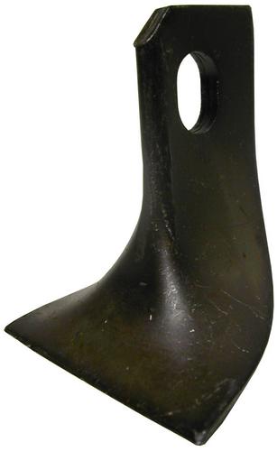

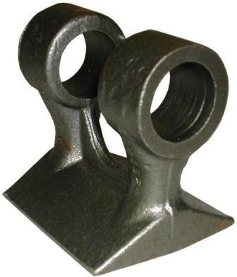

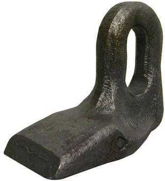

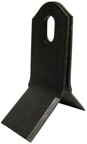

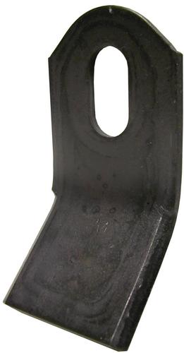

In general, the thickness of the flail blades will tell you how they are used. The thin Y type blades is for finish cut lawns/grass. The same type flail blades, but thicker, will still cut good, and last longer. As you get to the flat faced blades, you can cut a more dense grasses/weeds, and light wood. The large heavy flail hammers, of course will cut, tear, beat up on, destroy just about anything. On some of the flails, you can switch to different blades, and still get 100 % coverage. Just don't expect one type of flail to do good at everything.
Blades thickness could be .087 in, .196 in .13 in, .25 in

I have used finish cut and rough cut blades... They both cut BUT you have to back off quit a bit to not see the difference in the cut...
Guess thats why a lot of folks use a general purpose blade... "sort of" does both .
If you truly need a fine finish cut ... nothing beats the correct blade for the job... KennyV

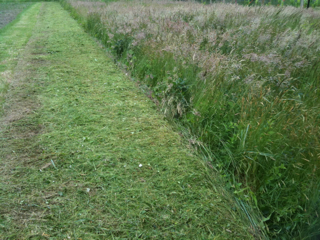

/ Let's talk flail mowers #989
Good afternoon,
If you desire to mow good turf grass and brush
continually the finish rotor is what you want to use.
The finish blade will work on heavy brush and winter
kill brush and it takes a bit longer but either way once
it gets knicked down to the sod the bad brush has very
little opportunity to return.
A hardened or non hardened grass slicer will last you
along time in any case.
If you are clearing land the P rotor/hammer knife is what you
would need for sure but if its only overgrown scrub the F rotor
or the B rotor will do it(with the F rotor cutting everything
to shreds slowly so it cannot return as thick and any native grasses
or seeded grasses will grow quickly as they are no longer choked by
weeds.
The finish knives are less costly to buy than the hammer knives as well
so please look at that issue when you begin narrowing down the problem/opportunity of selection.

I have never used the hammer knives before, I have y blades on my flails, the 6 foot has heavy gauge, I think .265, my 7 foot has ( again ) I think .211, with the .265 I can go over a hedge or bush in 2 passes, ( makes a little noise ) they stay sharper longer when cutting grass than the .211, it might just be me, but the lighter .211's appear to leave a finer cut. jmo.

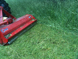

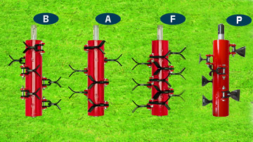

I will me mowing a wide rage of items with it. I have been mowing an old tralier park ( compleate with junk still in it) that is being slowley turned into a park, I have also mowed mantained fields, old fields(with trees regrowing etc) multi floral rose bushes, weeds, etc. I live in WV which is rarley with out some type of hill and rock etc. I am mowing along rivers, on top of mountians and everything in the middle. I have been doing all of this with 2 brush hogs. One I consider junk basicaly as It really does not mow well but I take it to jobs where if it breaks it is no big loss( ie hit a big stump, rock, mowing down small trees , Trash, etc). The other brush hog the side is removabe and I do mow hay with it. It does a pretty good job with a clean cut. I know that a flail will not totally do what I am doing with either but is rather a totally different beast. I know that for some jobs I will still be using the junk brush hog, Others the better one. What I hope to do is use the flail as a go between. It will be wider and I am hoping for a good cut quality. With that said though I dont know what type of rotor and blades or knifes I need. I will not really be cutting down trees with it but I will likely hit rocks, stumps trash etc with it. I would like it to give a high quality finish with one pass. ( not leave stubs sticking up etc, also I dont like having to remow espically when I am charging someone.) I want to be able to mow old fields( that are growing up with multi floral rose, small sapling, weeds etc and have a nice finish) I also want to be able to mow the park with it and leave a nice finish( no stubs etc). So what type of blades should I be looking at. I know that the hammer type cost more to replace but most do not have shackels. So if you take the cost of both the shackle and the knife and compair it to a single hammer I think it closes the gap some on cost. With all of that said would a B type rotor or the P type Rotor from Caroni be better for me? Also in looking at the picture of both the B and P rotor the mounts look the same( best i can tell in the picture). So if I ordered the P rotor type cold I also order the B blades and switch between the 2 for the best of both.( I do understand that it would be all the blades no mix and match) I don't mind spending a little more if it will work better for me. ( a few 100 not 1000) Lastly and maybe someone else can tell me I am assuming that the P rotor is a hammer type blade in the picture, If it is not and actually a scoop type how does that compair. Thanks for the input.
Link to where I got the picture Caroni S.p.a.
/ Let's talk flail mowers #997
have been mowing an old trailer park ( complete with junk still in it) that is
being slowly turned into a park, I have also mowed mantained fields, old fields
(with trees regrowing etc.) multi flora rose bushes, weeds, etc.
I live in WV which is rarely with out some type of hill and rock etc. I am
I have been doing all of this with 2 brush hogs. One I consider junk as It really
a big stump, rock, mowing down small trees, trash, etc.
On the other brush hog the side is removable and I do mow hay with it. It does
stumps, trash, etc. with it.
charging someone.
I want to be able to mow old fields that are growing up with multiflora rose,
small saplings, weeds, etc., and have a nice finish.
I also want to be able to mow the park with it and leave a nice finish no stubs
etc.
both the shackle and the knife and compare it to a single hammer I think it
better for me?
same best I can tell in the picture.
So if I ordered the P rotor type could I also order the B blades and switch between
the 2 for the best of both. I do understand that it would be all the blades no
mix and match.
I don't mind spending a little more if it will work better for me-a few 100 not
1,000.
does that compair.
This is the link to where I got the picture.
Caroni S.p.a.
A) That is a scoop/cup blade on the P rotor

If you mount a landscape rake wider than the wheel width of you tractor you
can use the A, B, or F rotor and knives with success and be assured the mower
and tractor will not be damaged.
After you have cleared everything to your satisfaction you can remove the rake
and use it normally for other jobs.
We want you succeed and buying a flailmower and a lanscape rake to protect
your tractor and mower by mounting it up front is the best way to do it .

As Leonz noted the P rotor is not for hammers but mounts the finish cut scoops. The B rotor and blades are the ones you want IMO. I'll post a few photos later of thick grass mixed with brush pre and post B rotor treatment.

Here are a few. More to follow
/ Let's talk flail mowers #1,000
Man that proves there are no sneaky snakes right there:thumbsup:
:drool:
