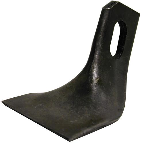

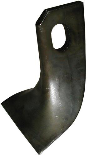

Here are some pictures of some that might be used for fine cut grass cutting.

The 4 that J J has pictured are good finish blades, the second one is the most robust of all and will lend itself to more accidental abuse cutting small sticks and brush... If you are mowing a clean lawn area you can get a lot of life from almost any finish blade... but too many of us, myself included, tend to occasionally mow into places to reclaim over grown spots... depends on what you are mowing. KennyV
