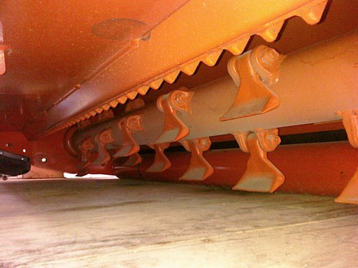

These are heavy duty axe blades, and should be able to chew up 2 in material. You still need to go slow, when trying to mulch trees.
