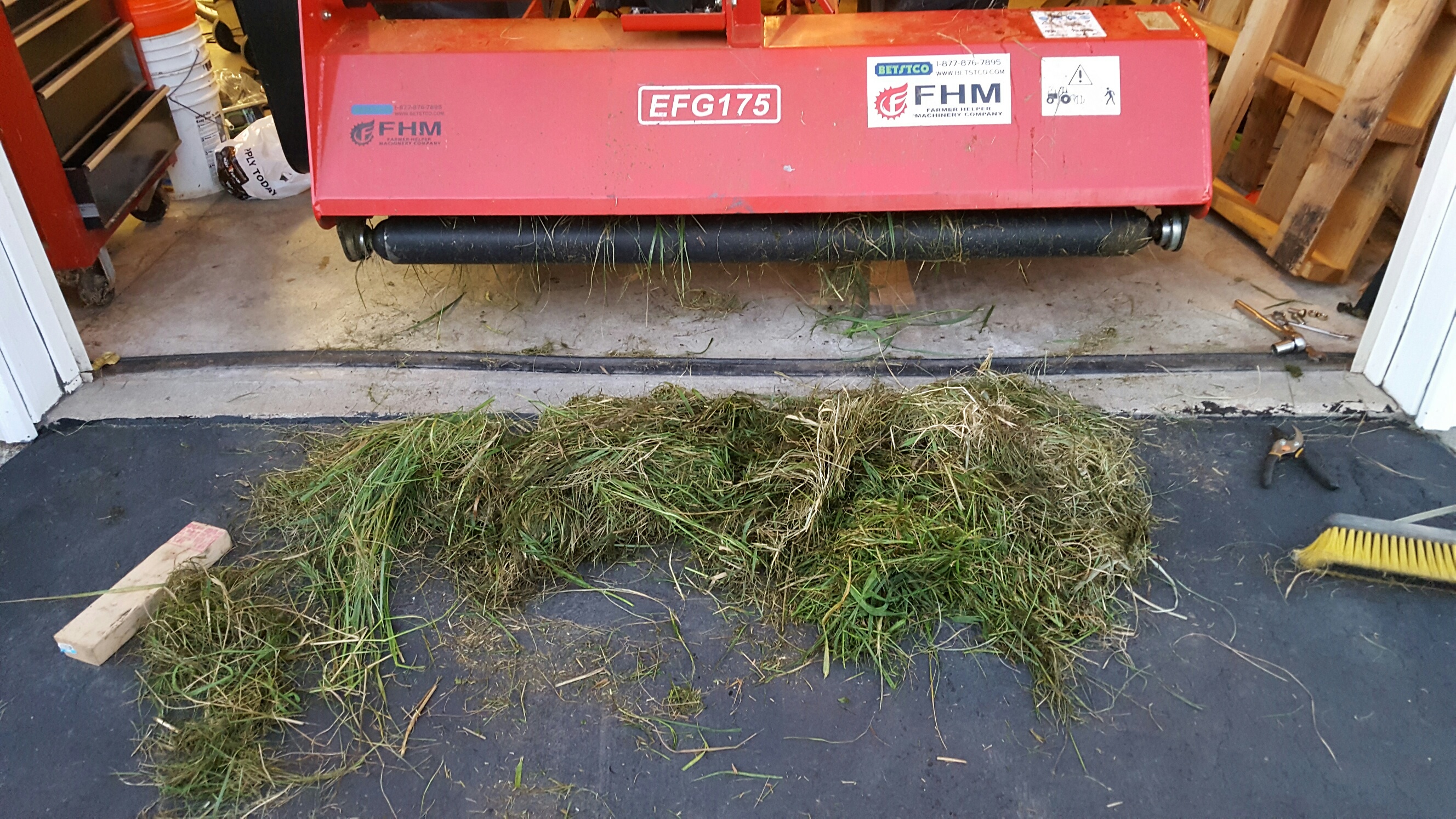

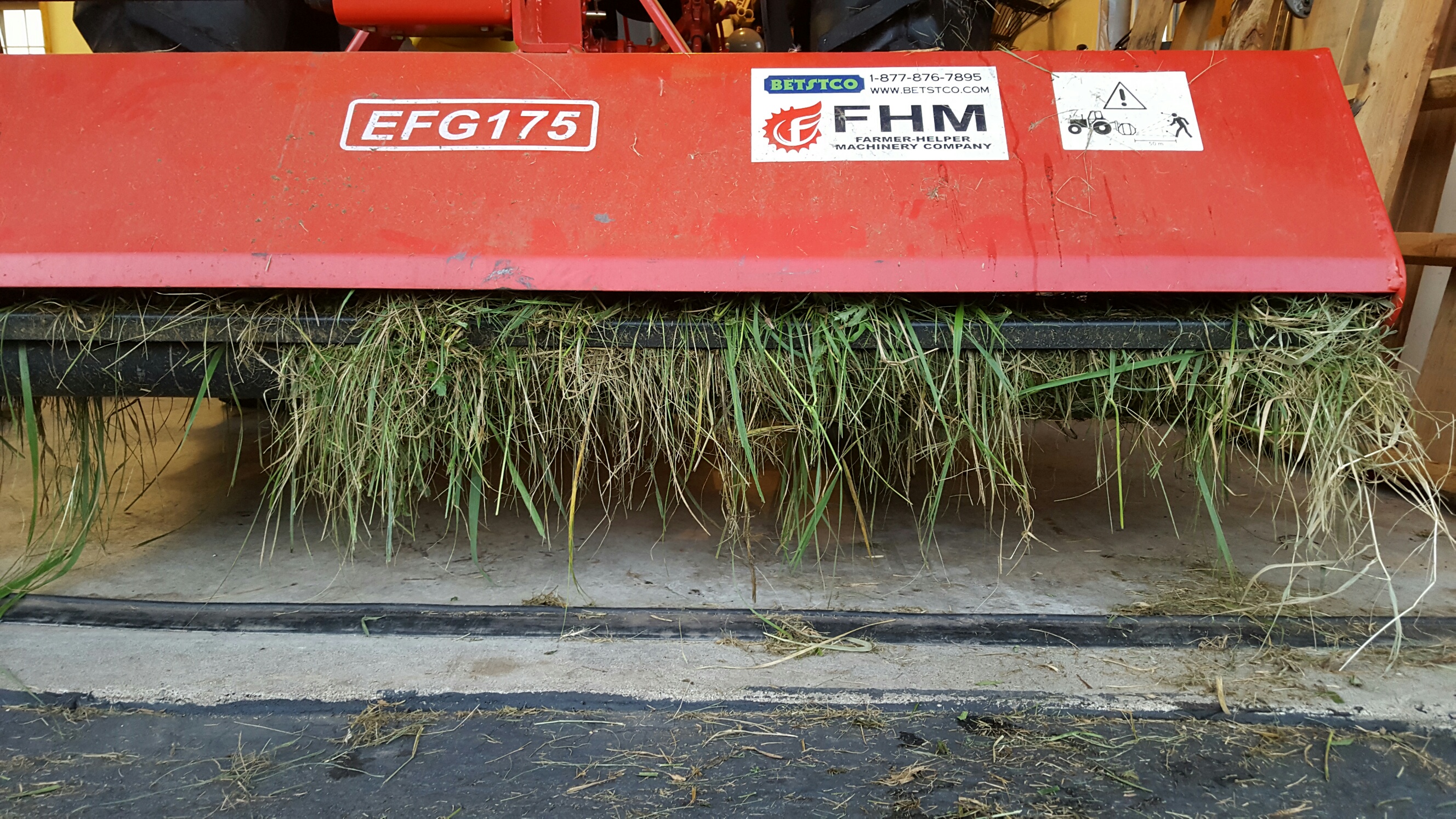

A question I forgot to ask last night, I'm having trouble with grass wrapping up on the roller and jamming the roller with the scraper bar. My scraper is off the roller a bit, are they typically set pretty tight? I need to try something different with that (either adjusting or removing the scraper) before I go out again today, had to stop several times in an hour last night to clear it..
Are you sure that the cutters are not on backwards? A flail usually cuts the clippings so short that they could not wrap around the roller.
Pictures would help.

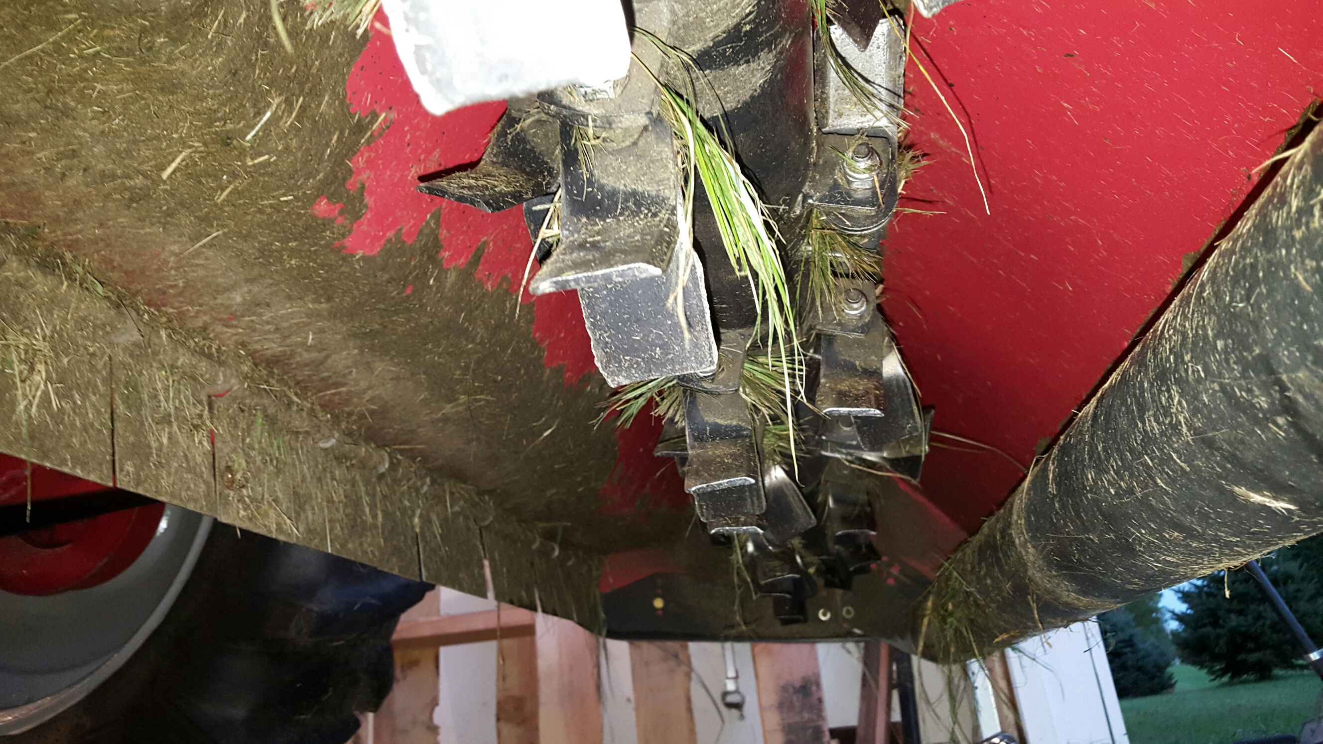

I might be dealing with multiple issues at once... The knives are side cutters that are sharpened on both sides, can't be installed backwards. I verified the other day that the knives are rotating upward in front so rotation is correct. Started doing some tune-up (haven't had this tractor long...) and found a bunch of corrosion on one plug wire and corresponding distributor terminal, no replacements locally of course but I cleaned them up pretty well, went out to test, no change. Checked base timing and found it off about 10 degrees, fixed it, went out to test, no change. Found that the distributor points had almost no gap and set to proper .025, was getting dark so didn't go back out yet. I've never had to mess with points so no idea how much difference that could make. Verified that the mechanical advance weights move smoothly and no play in the distributor shaft. Couldn't check timing advance yet, it's been so many years since I've needed a timing light I couldn't find it and don't know that I even have one any more.. :laughing: Also ran a compression test and got 130/115/120/120 so I'm all good there. That stuff is all separate from the cutting issues as the areas I've posted pics of were gone over with the tractor at or a little above 540 ptm rpm, so even if I get the tractor running better I don't expect any difference in the actual mowing. I'll try taking the scraper off, but if the grass isn't getting mulched up it will probably just wrap up more without it...
I took the scraper bar off for now, but I'm pretty sure that's just going to allow the roller to really build up the grass. Up till now though, the grass would build up enough between the roller and scraper to jam the roller and I think it was probably just dragging and not rolling. I also always have heavy grass wrapped around the ends with the bearings (especially the right side), to the point where the bearing gets hot from being packed tight in insulation and also friction.
The grass was a little damp tonight, do others have trouble mowing if it's wet/damp or does it usually not matter? Wishing I had just bought a Bush Hog at this point...or no tractor at all... :mad:

Leave the scraper bar off.
If you are just mowing grass then it isn't really necessary.

From the look of that last photo it looks like it is throwing forwards. The front of the mower is dirty and the back is clean. This would make the tractor work really hard if the blades were turning that way.
If the cutters were turning the same way as your wheels the roller would not get covered like it does because the grass is driven down, not up over the top and on to the roller as in this case. It also makes it easier to propel the mower/tractor through the grass. The mower pushes rather than pulls against the tractor.
That's what it looks like to me anyway.

According to the documentation that's the direction it's supposed to run, but I may look to see if the gearbox is reversible and try same as tires if possible..

Rotation of rotor, blade type, and scraper are all normal. Even if PTO speed is a bit low it shouldn't result in clogging the rear roller (I mow similar height and density grass with engine set 200-400rpm below PTO speed routinely).
I've never seen long grass clogging the rear roller before so can only speculate but 1) have you tried mowing more slowly and 2) is your tractor putting out enough HP to keep the rotor cutting? Does it bog down?
Do you have access to another tractor for a test comparison? If you mow in low range do you get the same result?
I have seen similar poor mowing with small clumps of un cut areas in a field before but that was always due to either several missing blades or wet grass or mowing too fast in thick dry grass. What I experienced wasn't as bad as what is shown in photos here though and in particular there was never grass wrapping around the rear roller. I've never seen grass wrapped around a rear roller before and think somehow that is the key clue.
/ Let's talk flail mowers #3,540
I'm hung up on the first picture of the roller. Isn't that showing grass being slung over the TOP of the scraper? How can grass get slung in this way if the drum is turning in the same direction as the tractor's wheels? If the drum is turning counter to the tractor's wheels then I could the explanation being that the tractor is flattening some grass and the flail isn't picking it up well because it's rotating into the backside of the flattened grass, onto the top of the scraper.
