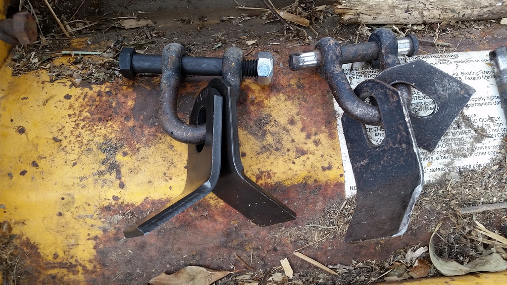

Interesting picture there as the D ring mount might allow the two blades to "hydrofoil" out (spread apart from each other) as leonz said. Mine are rigidly mounted, which makes little sense to me as you have the wide 3/8" or so flat where the upper parts are together that just rips at the grass. Even if the blades were sharpened all the way up that wouldn't really become a cutting edge with them pressed together. I'd rather see something like one of these with all edges sharpened...
I've wondered about just spreading mine apart with the spacers that are already on the bolts, but would have to check overlap of the blades first. I also think the standard side slicers would cut more efficiently if the bottoms were ground instead of the tops. If you picture the angle of attack of the blade swinging up and forward into the grass grinding the bottom instead would lead the cutting edge into the material a little more square to it...
For now I'm probably done messing with it for a while. Tried again today with no better luck, and when I got back to add insult to injury I had a very small coolant drip from the radiator... :rolleyes: I don't see it as practical to try and return it, and I can't use it as is, so just have to chalk it up to having made a bad decision. Still might stick the flail on the neighbor's tractor just to test how much of the issue is my tractor, but that depends on him finding time. Might pick up a carb rebuild kit this weekend too, but not sure when I would get to it...

Dan in MN, did you look at the gearbox? I am still wondering if it could be flipped over,,
which would reverse the rotation of the cutters.
My flail mower rotates opposite the direction yours does.
If you reversed rotation, at least you could use the sharp side of the blades,,, :laughing:
Also, my side skids are adjusted so that they are within an inch of the ground when the roller is on the ground.
Your skids have multiple holes for some reason, it seems that they are there for more than parking,,,
There are a lot of things to try before you give up.
IIRC, you had some issue getting the mower "leveled" when you first started,,
and maybe having the blades hit soil dulled them.
It might be worth the effort to reverse the blades to see if the sharp side cuts better.
I have to admit, my blades are original, never rotated, and 10 years old,
they still cut just fine.
I am just throwing out ideas,, the answer has to be somewhere.

Hello dan,
Your neighbors mule will not make difference.
The issue is the "so called" knives that came with it. Take one pair off and measure the total knife height from Vertical, The Width and the size of the mounting hole and order a new set of hardened knives from Flail Master or Clean Cutter.
Sadly sharpening the bottom edge of the side slicers mounted on the flail mower will not help you as they will not be contacting the majority of the brush at all(less than 1/4 of an inch width of cut as the other edges will just tear at the brush.
Once you have the knives changed you will see a huge difference.
I am sorry your going through this due to thier poor quality control and manufacturing.

I still don't see how the knives can be Dan's problem. They are essentially new and have more edge than mine do. The clevis mount is exactly what my Caroni uses and "hydrofoiling " is just not an issue.
/ Let's talk flail mowers #3,572
I don't believe it's the blades either ...
I replace mine typically just when I bend them.
/ Let's talk flail mowers #3,574
I'm not sure how the knives would be the problem either. How would measuring what is on there now and ordering the exact same thing but hardened change anything?
As for the knives opening up while spinning. Does anyone have any proof that that actually happens? When I built my chain attachments I checked to make sure the knives had plenty of room to slide open to allow the cut to be horizontal. They open up very easily by hand. When I had all knives on I brought the flail up to speed and videoed with my phone and could clearly see the knives were not opening up at all. Still had the upside down Y shape.
