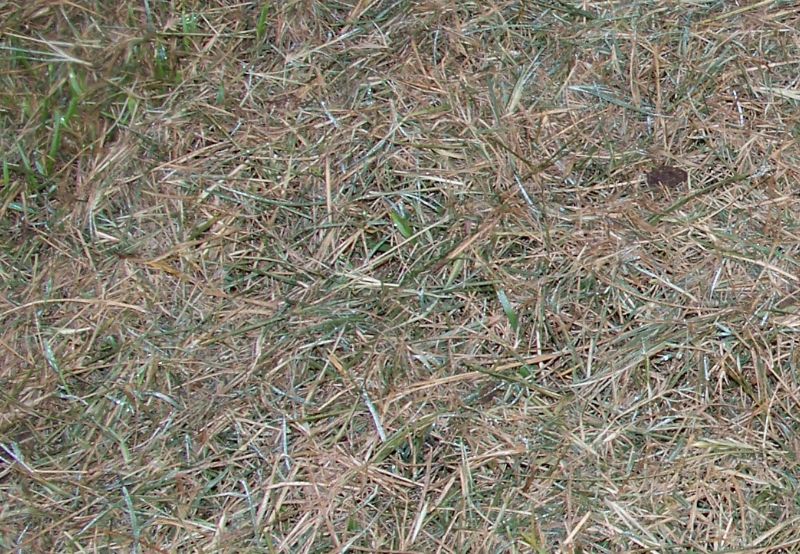

This is baffling to say the least, don't believe anyone here has ran into what Dan is experiencing. This may be asking allot but might help us figure out what is going on. Can you make a video of the mower in action? Maybe have a helper walk beside the tractor with the camera, include sound if you can. Most cameras today will record videos and of course if you have a smart phone...
On your question of wet grass, I mow in the mornings as we normally have temperatures close to 100 and 70% humidity by noon in the summer. The grass is always wet from dew, the flail doesn't seem to care unlike my ZTR. If I try to mow the yard the ZTR just clogs up with wet grass.
<edit> I mowed this yesterday morning, it was about 8 inches tall and wet. The close up is what my JD flail leaves behind.

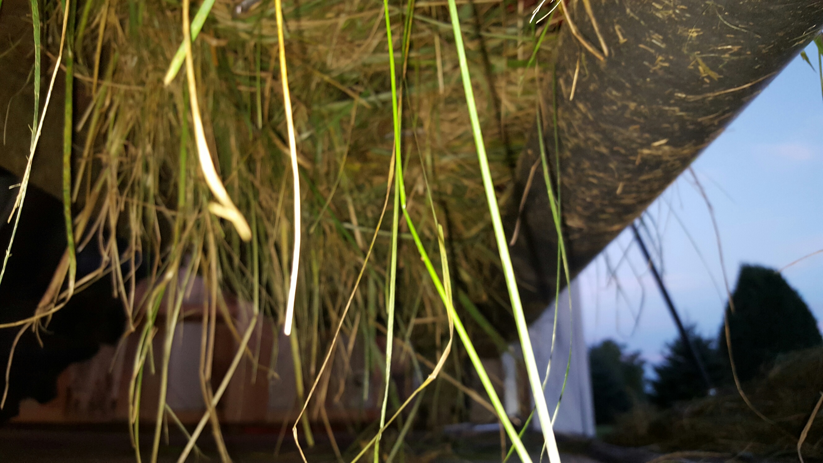

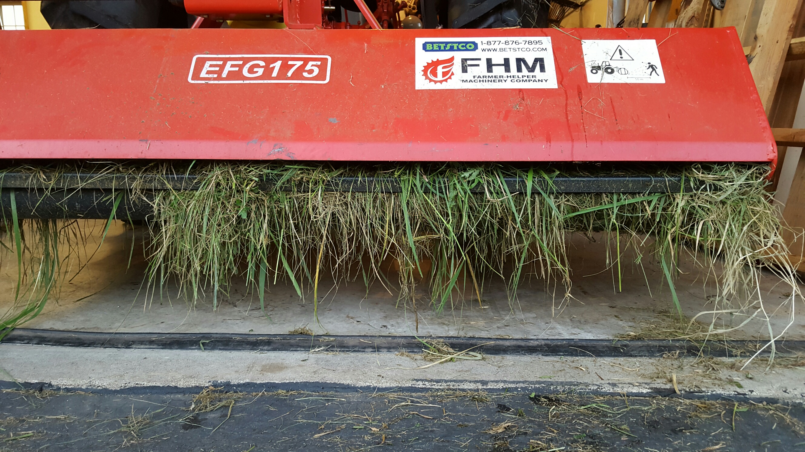

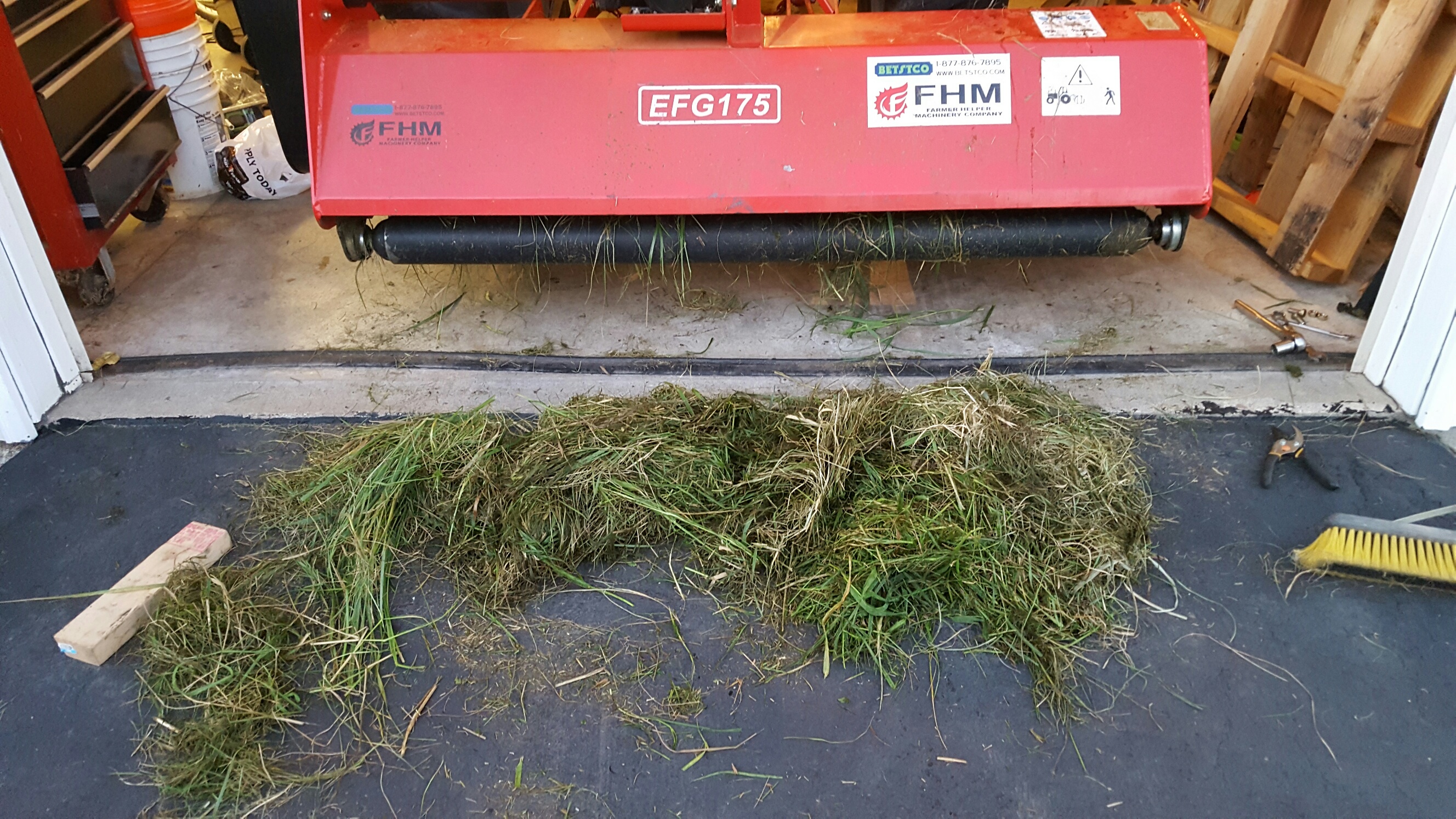

/ Let's talk flail mowers #3,544
Standard angled side cutter pairs.
This afternoon I changed the points, condenser, cap, and rotor and no improvement. Had to buy a timing light since I have no idea where mine went...probably threw it out a few years ago since I hadn't needed one for ~20 years... Was hoping the other stuff would be the solution so I could return the light, but no such luck. Getting the total timing set made a big difference in power, but as soon as the mower loaded up the roller again it just brought the tractor to it's knees...as soon as it bogged down completely this time I shut the pto off and drove back to the garage..
Roller full of grass.. View attachment 480909
All of this came off the roller!View attachment 480910
Underneath full of loose grass.. View attachment 480911
Cleaned out.. View attachment 480912
I took the scraper bar off for now, but I'm pretty sure that's just going to allow the roller to really build up the grass. Up till now though, the grass would build up enough between the roller and scraper to jam the roller and I think it was probably just dragging and not rolling. I also always have heavy grass wrapped around the ends with the bearings (especially the right side), to the point where the bearing gets hot from being packed tight in insulation and also friction.
The grass was a little damp tonight, do others have trouble mowing if it's wet/damp or does it usually not matter? Wishing I had just bought a Bush Hog at this point...or no tractor at all... :mad:

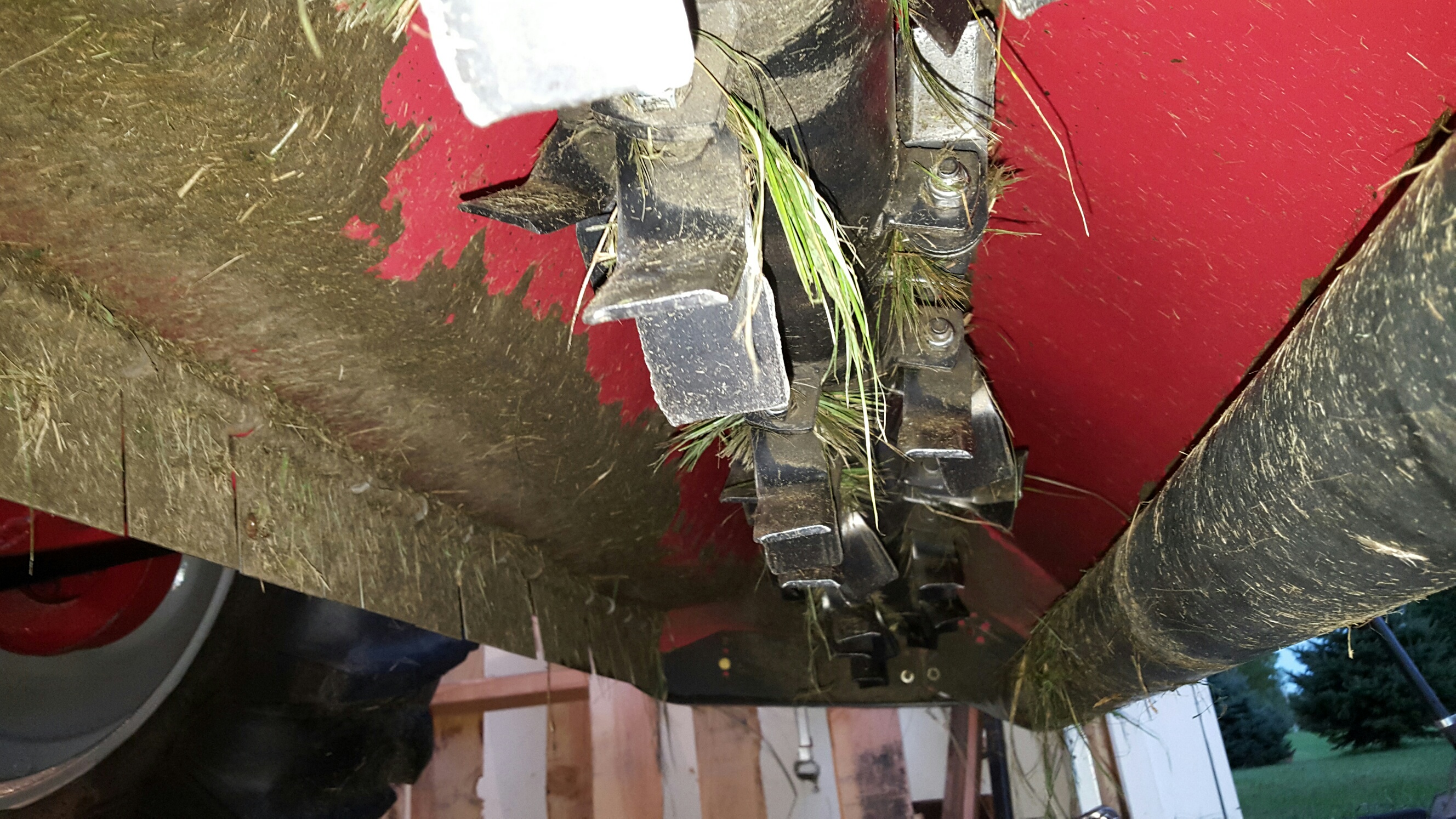

Hello Dan,
GROWL!!!!!!!!!!!!!!!!!!!!!!!!!!!!!!!!!!!!!!!!!!!!!!!!!!!!!!!!!!!!!!!!!!!!!!!!!!!!!!!
HISSSSSSSSSSSSSSSSSSS!!!!!!!!!!!!!!!!!!!!!!!!!!!!!!!!!!!!!!!!!!!!!!!!!!!!!!!!!!!
SPIT!!!!!!!!!!!!!!!!!!!!!!!!!!!!!!!!!!!!!!!!!!!!!!!!!!!!!!!!!!!!!!!!!!!!!!!!!!!!!!!!!!!!!!!!!!!!!!!!!!!!
)(*&^%$#$%^&*()_)(*&^%$#%^&*()_)(*&^%$#%^&*()_)(*&^%$%^&*()_)(*&^%$%^&*()_(*&^%$%^&*()(*&^%$#%^&*()_+)(*&^%$%^&*()_)(*&^%$^&*()_)(*&^%^&*()(*&^%
OK now that I have vented my spleen;
Please invest in a non contact rpm gauge to verify the
1. PTO SHAFT speed at the PTO SHAFT
2. Shaft Speed at cross shaft
3. Drive pulley speed
4. driven pulley speed
5 Flail Mower Rotor Speed; at the shaft end stub through the open bearing-measure only at
only at this point for reasons of safety to avoid exposure to the knife pairs while the rotor is spinning.
The flail mower rotor shaft stub should be spinning at 2200 RPM with the engine PTO Speed at 540 RPM.
Your side slicers have no cutting edge at 37 degrees of angle from horizontal!!
It is Not Your fault!!
It is the manufacturer of the flail mower that is responsible for this.
All your side slicer pairs are doing is just ripping at the tall grass and pulling it not verticutting it.
You can take the knives off and properly grind them at the 37 degree angle using a wet grinder or
order 100 of standard side slicers of that size that are not heat treated and have good mowing results.
IF you want I can talk with the folks that sold you this "flail mower".
GROWL
HISS
SPIT
(*&^%^&*()_+_)(*&^%^&*()_+_)(*&^
I only get mad when the quality is bad!! The knives are the business end of any flail mower and that is where the work is done!!
/ Let's talk flail mowers #3,545
I'm hung up on the first picture of the roller. Isn't that showing grass being slung over the TOP of the scraper?
How can grass get slung in this way if the drum is turning in the same direction as the tractor's wheels?
If the drum is turning counter to the tractor's wheels then I could the explanation being that the tractor is flattening some grass and the flail isn't picking it up well because it's rotating into the backside of the flattened grass, onto the top of the scraper.
I think the discussion that I have read states the mower is counter-rotating the tire direction?? :confused:
:confused2:
The wrapping is nothing short of amazing,, no matter what direction the mower/wheels are turning..
If it were my mower,,,
I would,,, with a freshly cleaned drum,,, take the mower out and try cutting in reverse. :thumbsup:
/ Let's talk flail mowers #3,546
Hello Dan,
GROWL
HISS
SPIT
Now that I re-look at the pics, it does appear that the un-sharpened portion of the blade is doing a lot of the "work".
I would guess 50% of the grass is contacted by the flat, rather than the "blade" ? :confused:
If the 3/8" wide flat of those two blades hit the grass,, all it will do is pull on the grass, rather than cut it,,,
That is an amazing wear pattern, Dan,, thanks for posting the pics!! :thumbsup:

/ Let's talk flail mowers #3,556
I hate to say it but you do need new knives.
They did a piss poor job of sharpening them using simple steel as a knife blank
and if they tell you different I will gladly have a conversation with them.
There is no excuse for those knives BECAUSE of the blunt edge that SHOULD NOT be there to begin with.
That is why your mower is not mowing well and tearing the brush rather than cutting it.
Your mule has issues as you said with a different Tachometer/speedometer than what is ment for your mule.
The 37 degree cutting angle figure comes from the Mathews Company Lawn Genies that my father and I have owned and own now.
The no tool knife hangers they manufactured allow the tapered side slicers to become an airfoil(airplane wing) as they spin up to speed and the slotted knife goes from hanging at vertical to horizontal to create a world class finish on turf and brush.
The flail mower rotors on most machines do not allow this to happen because they are bolted to stay vertical in a knife station or the bent bar stock knife hangers do not allow them to move and create an airfoil.
I am so sorry you are going through this as new resident member of the "Flail Mower Nations".
