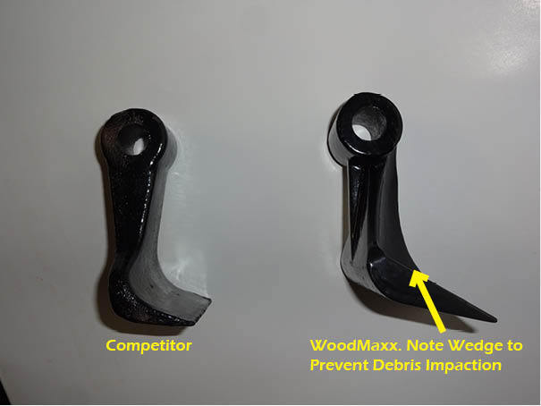

leonz, as you seem to be knowledgeable about the cutters I'd like to get your comment on this one:
I'm looking for a dual purpose solution as well. Lighter brush and field grasses. Doesn't need to be "finish" quality.
I've ordered a Woodmaxx with those cutters. I'll post the results after I get it. I also ordered a set of side slicers for it too.
