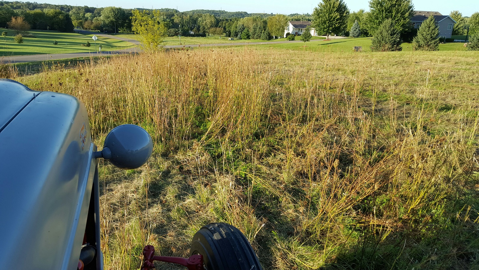

Got some decent mowing done today and took some pictures of the area I'm having trouble with.. The first picture is what it looked like after I mowed days ago with the mower high and how the tall stalks are still standing...

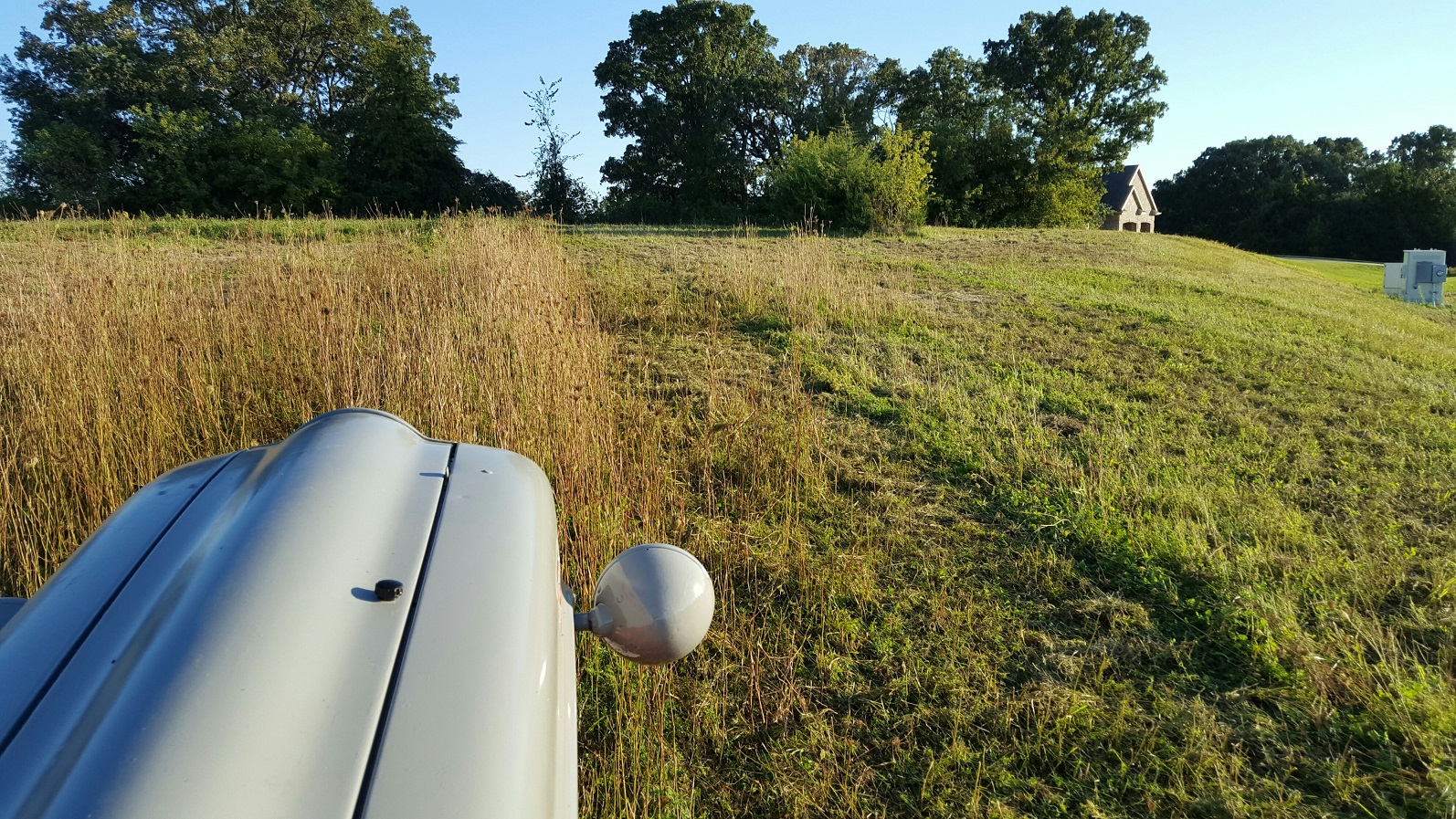

Second picture is after I just went over it again with the mower dropped low, got a lot of them but a lot still standing. The pass I just made is to the right of the tractor, and wasn't as heavy as what is in front of the tractor..
I later raised the front of the mower more with the top link and it seemed to do quite a bit better as I had thought it might, I may raise it even more but have to check the max length on my top link as I have it out pretty far right now..

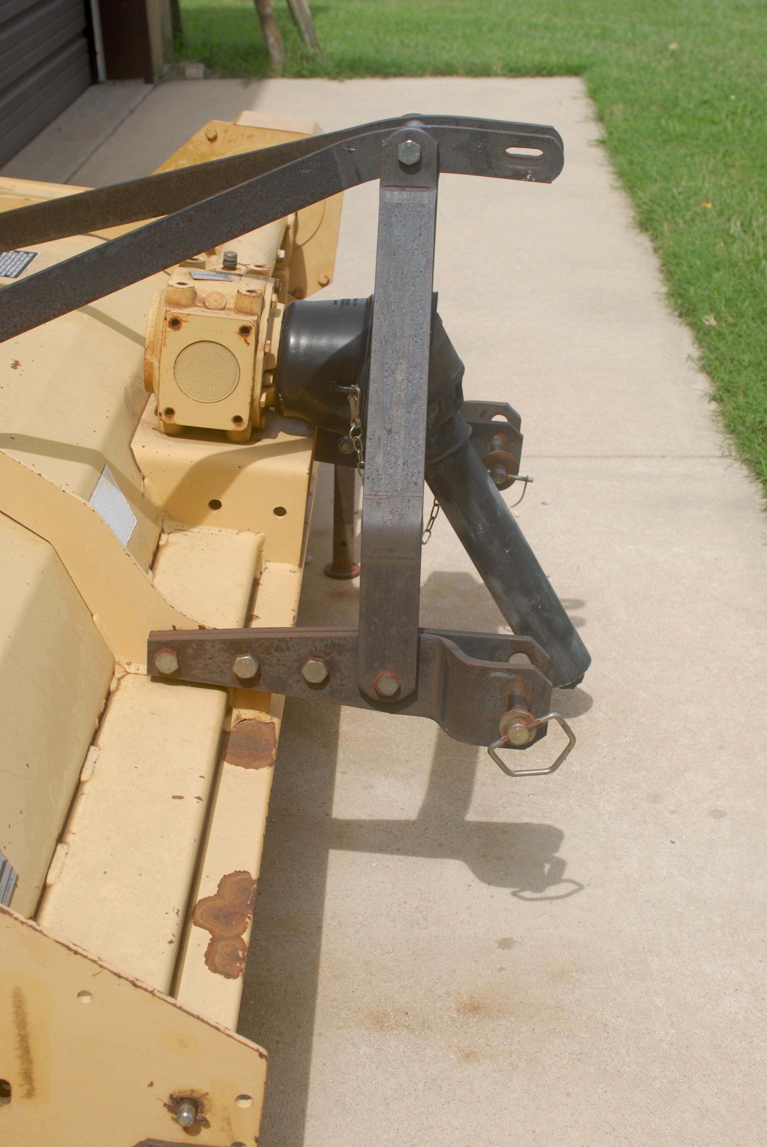

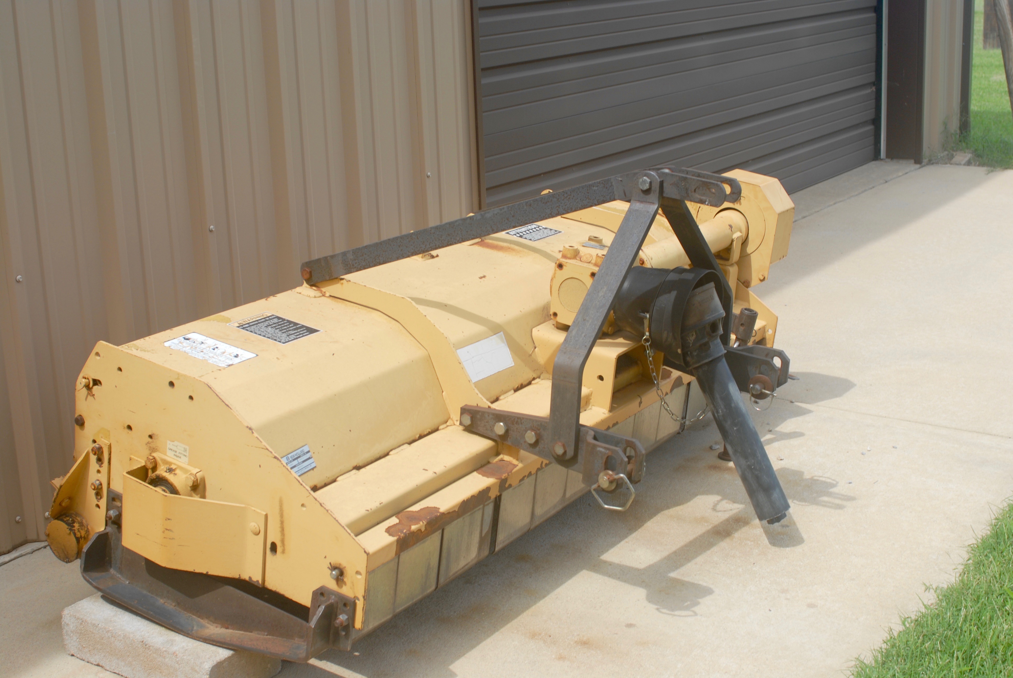

Don't claim to be an expert, as the New Holland 918H is the only flail I've ever owned or used. Both the top link and bottom arm pin connections are slotted, presumably to enable float? The slots allow the mower to rotate slightly in use. Has worked well for 16 years! VicDSC_0006.jpg[ATTADSC_0008.jpg
/ Let's talk flail mowers #3,513
Don't claim to be an expert, as the New Holland 918H is the only flail I've ever owned or used. Both the top link and bottom arm pin connections are slotted, presumably to enable float? The slots allow the mower to rotate slightly in use. Has worked well for 16 years! Vic<img src="http://www.tractorbynet.com/forums/attachment.php?attachmentid=480563"/>[ATTA<img src="http://www.tractorbynet.com/forums/attachment.php?attachmentid=480565"/>
