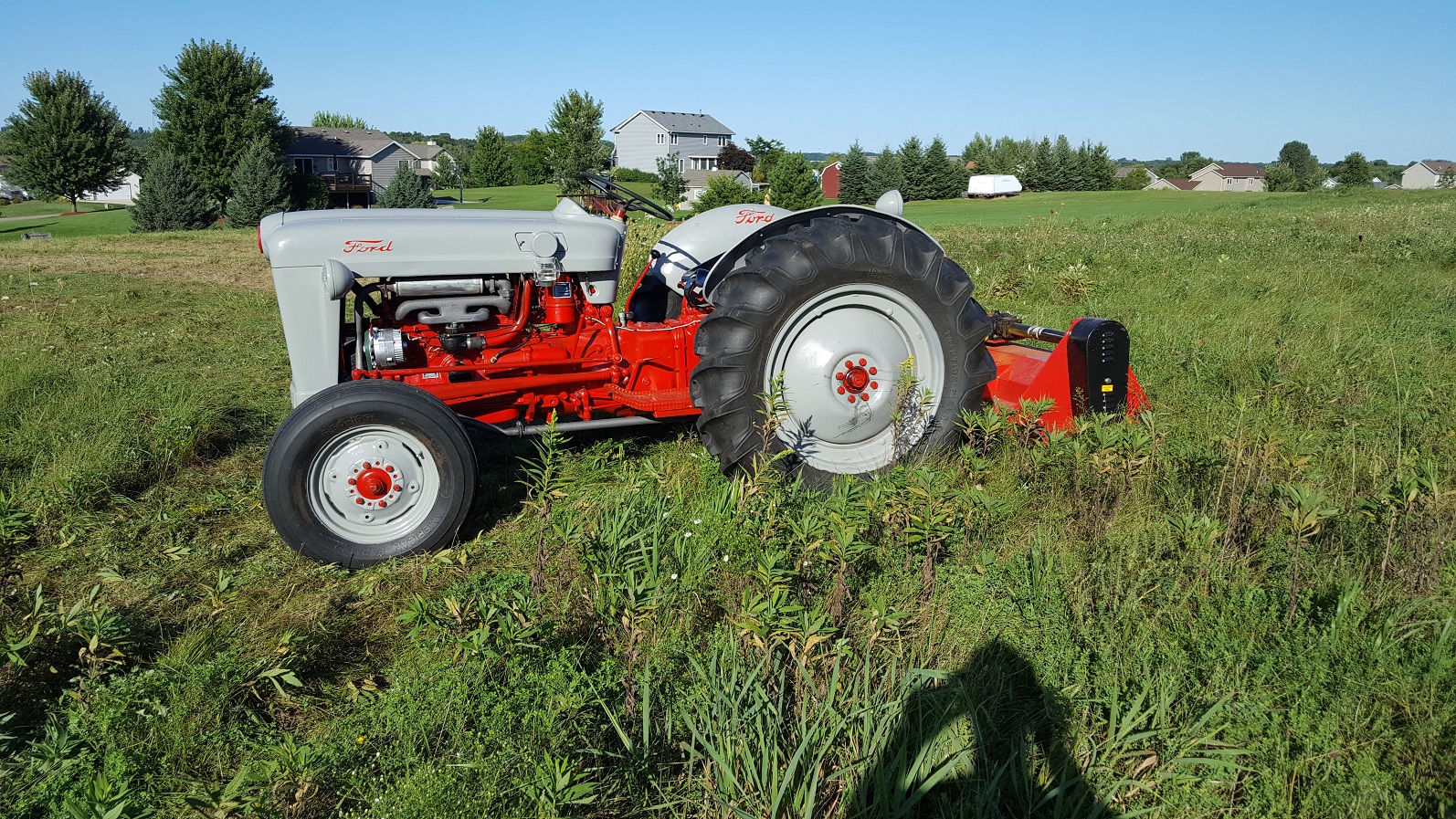

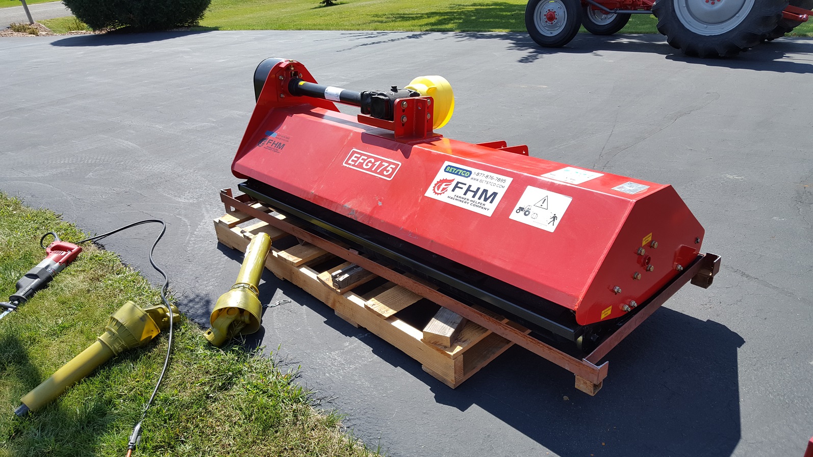

I haven't had a chance to take any pictures of areas mowed or anything yet, but figured I'd at least post initial impressions of my Value Leader EFG-175. It was pretty heavily protected in a welded angle iron frame that had to be cut apart. Everything seems to be heavily built, the only thing I don't care for is that one of the grease zircs is under the belt cover. It's only one bolt to remove, but that requires getting tools out and I have a feeling if removed over and over that one bolt will eventually be a problem. I'll be drilling a hole in the cover across from the zirc. I've mowed about 3 hours with it so far, I'm generally satisfied but not thrilled at this point. It leaves a bit more standing than I would like, especially some sort of tall weed flower with a thin stalk, just leaves a lot of stalks standing even after hitting some of it twice. It's certainly possible that some adjustments will help, time will tell. We've had several rainy days in a row now so I haven't been able to get out, today I tried mowing with wet grass and ended up having to cut about 30 lbs of wet grass out of the roller....won't be trying that again... :laughing: I'll have to get some pics of it on the tractor and some mowing shots of course, but for now here's what I have..
Since I've had almost no experience running 3 pt implements I need some advice. I have it hooked up right now without stabilizer bars on the lower arms, thinking allowing some movement would be best. Of course if I'm on any side slope and lift it the mower flops sideways a bit. I have stabilizer arms that I can add that triangulate the lower 3 pt arms and will take pretty much all the sway out of it, but for this type of implement what is recommended?

I always leave my stabilizers tight all the time. I hear leaving them loose when plowing is good to let it move around obstacles a bit, but I don't plow.

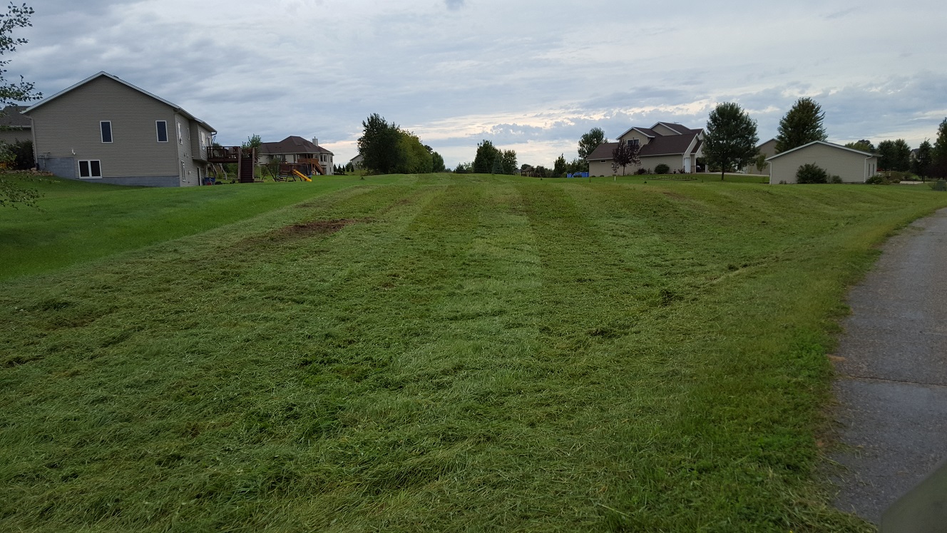

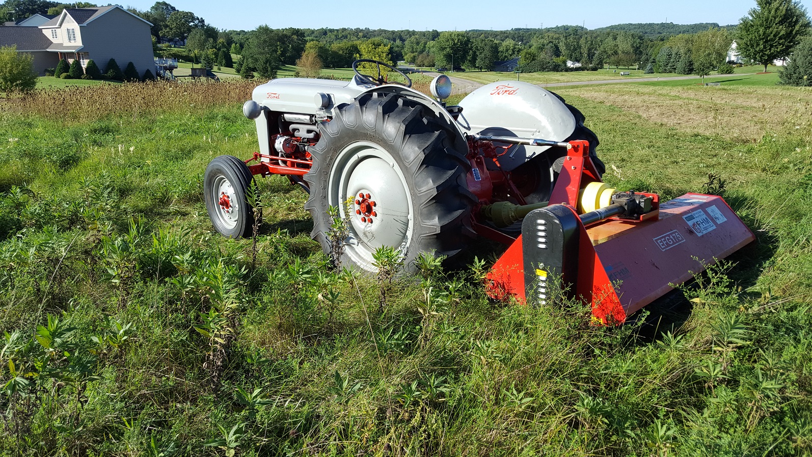

I thought I had gotten a picture of some of the stuff that it leaves standing, but apparently didn't.. Anyway, I've figured out the problem, it's the same as when I mowed outlots earlier this year with a Gravely zero turn. The problem is stalks that are tall enough that the front of the deck pushes them down, and the back of the deck (the roller in the flail's case) gets to it and keeps it held down before the front clears the end of the stalk (never has a chance to pop up inside the deck). It passes right under the blades or knives and pops back up behind. I have one area that still looks terrible after mowing, and more passes doesn't do much either. So far I've had the mower set fairly level and also high, I'm going to try dropping the back of the flail low on the roller, then using the top link to lift the front so the flails are more 'exposed' to the incoming material. I'll try to get more pictures tomorrow and report if the change in angle helps or not...
/ Let's talk flail mowers #3,489
View attachment 480088View attachment 480089
Hello Dan,
refresh my memory, do you have the scoop knives or the side slicers?
Are you mowing at the 540 PTO engine speed? Your brush is not that high.
Have you tried half cuts?
Do not hesitate to mow backwards with a full width cut to get rid of the crap. You would be surprised how much will get shredded when mowing in reverse and then driving forward while mowing to shred it even more.
When my father used his 36 inch towed/ motorized lawn Genie(8 HP B+S) to make a jogging path for my mother in an old pasture the golden rod was 12+ foot high on average and once he got the grass and brush down to 2 inches the crap was gone and she had a safe path to jog on when she was still well.
If that rear roller is adjusted to 2 inches the mess would be nothing but a carpet of clippings if the engine speed is set for the 540 RPM PTO speed.
side slicers
At or near, mower seems to cut the same even considerably lower, but the tractor is happier a little above..
I can only lift it about 6-8 inches or I risk the pto shaft separating, doesn't seem to make a difference with those stalks.
I can try it, but if I have to stop, shift, back up, shift, go forward, etc.. over and over through large areas then I bought the wrong machine..
I don't think dropping it straight down would make any difference with the tall stalks as the front of the deck and roller are keeping them pinned below the knives, never having a chance to get cut. I'm planning on experimenting some tomorrow if it doesn't rain with different heights and dropping the back, raising the front as I think that's the best chance to get knives on those stalks.. :thumbsup:
/ Let's talk flail mowers #3,491
side slicers
EDIT: I looked at the image with your mule and mower in the foreground and I will assume that the three to four passes that were made on the edge of the field were by you using the ford and the flail mower??
IT does not look bad for a first mowing but the brush will need to be shredded up again to dissolve the clippings quickly into the soil
Lower the cutting height to two inches with the gearbox level from front to back and mow once more with the engine speed at the 540 RPM engine speed. If you have too slow down don't worry your going to love how it looks as long as you adjust the mowers cutting height properly.
Do not hesitate to mow in spiral to allow you to recut the material.
EDIT:
My father used a ford Jubilee with a 7 foot JD25A finish mower to knock down
12-15 foot golden rod in old pasture to good sod, it just takes more time
EDIT:
Hello Dan,
What I mean by half cuts is simply lowering the flail mower and using half the cutting width as something is very wrong, there should be nothing but clippings and your mowing does not seem to be working.
Set the mowing height at 2 inches and mow with the rear roller riding on the ground as you are losing the mowers ability to create the negative pressure gradient(suction) needed under the flail mower shroud to lift the clippings up and over the flail mower rotor.
IF it does not sound like a vacuum cleaner at the 540 RPM engine speed with the roller riding on the ground its not cutting well.
End of edit:
I hate to ask but which way is your PTO shaft rotating??? some of the older PTO mules had right hand rotation.

Ahh...thought you were talking about raising for a partial height cut first.. I went out and verified that the knives are rotating upwards in front as intended. I also dropped it down much lower in hopes of trying again tomorrow (forecast is calling for rain...). I did find one mistake by the Value Leader engineers...dropping it down lower of course also needed the skids to be raised, but in front you can't get to the bottom bolt hole on the skid as the curve of the skid is such that it hits the side of the frame before you can get to the bolt hole. I was able to raise the back of the skids and it will work fine with some angle to it, but thats kind of a ridiculous oversight..

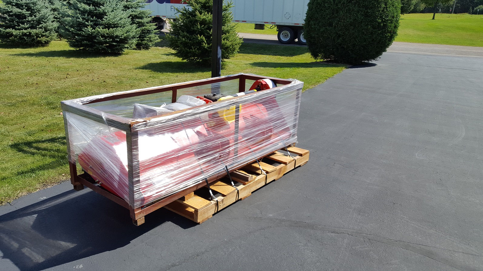

I went out yesterday with the grass wet to try the lower height and mowed an area that was only around 12" tall so I wouldn't get grass wrapped up in the roller again...it cut pretty nicely...
Today was nice and sunny all day, was going to go out late afternoon and mow a taller area but the tractor wouldn't start. After some troubleshooting I narrowed it down to the starter and took it apart, definately needs a rebuild with worn down brushes, corrosion on the commutator shaft, and one of the brushes had the wiring almost broken completely off (did come off while I handled it)... I'm surprised it was working at all, hoping to find a rebuild kit locally tomorrow otherwise I'll have to order and wait..
