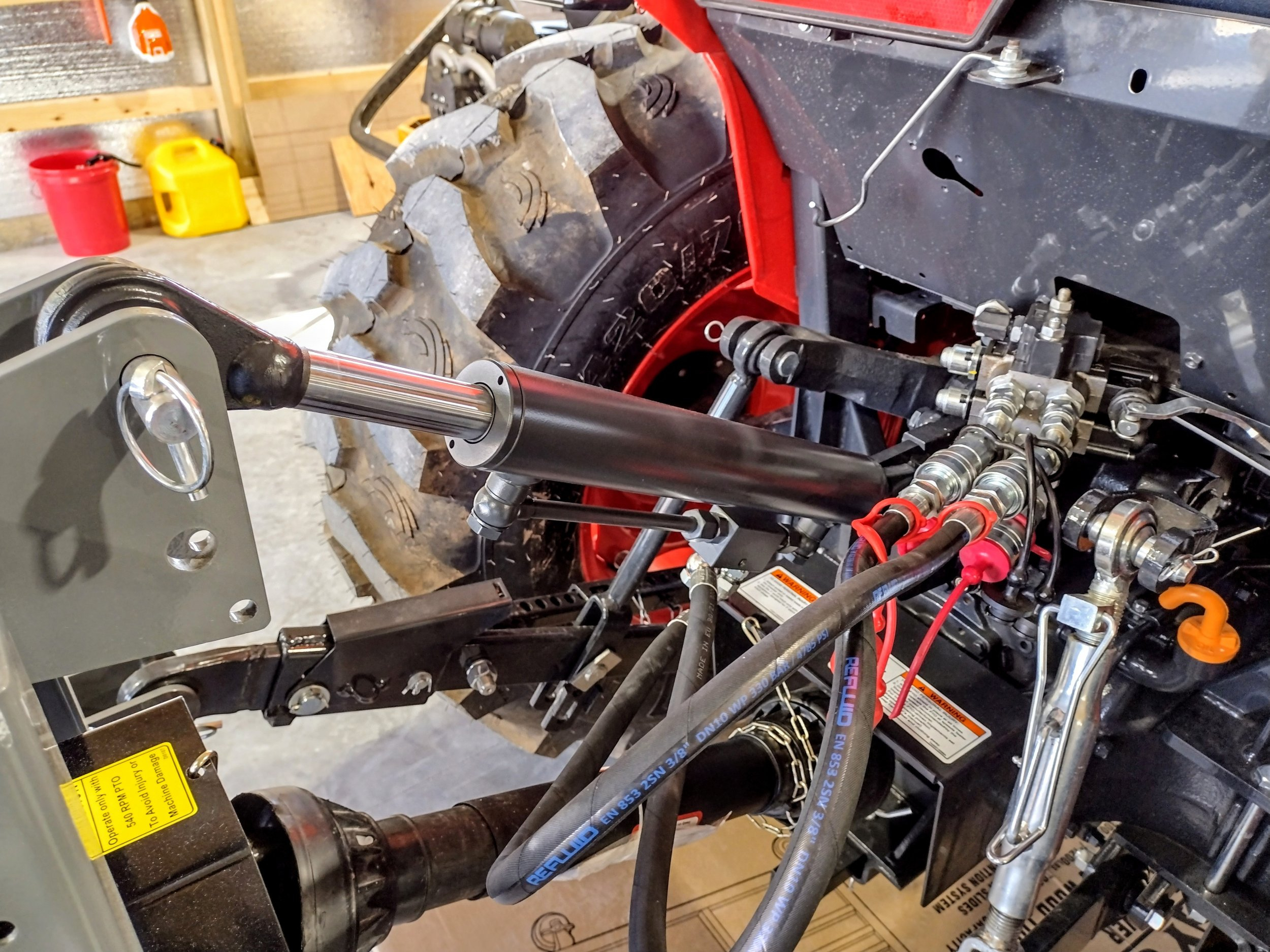

Since I cant post the video... The cylinder cycle takes 5 seconds with the remote lever at full deflection. So, 2" per second or so... Nice and slow.

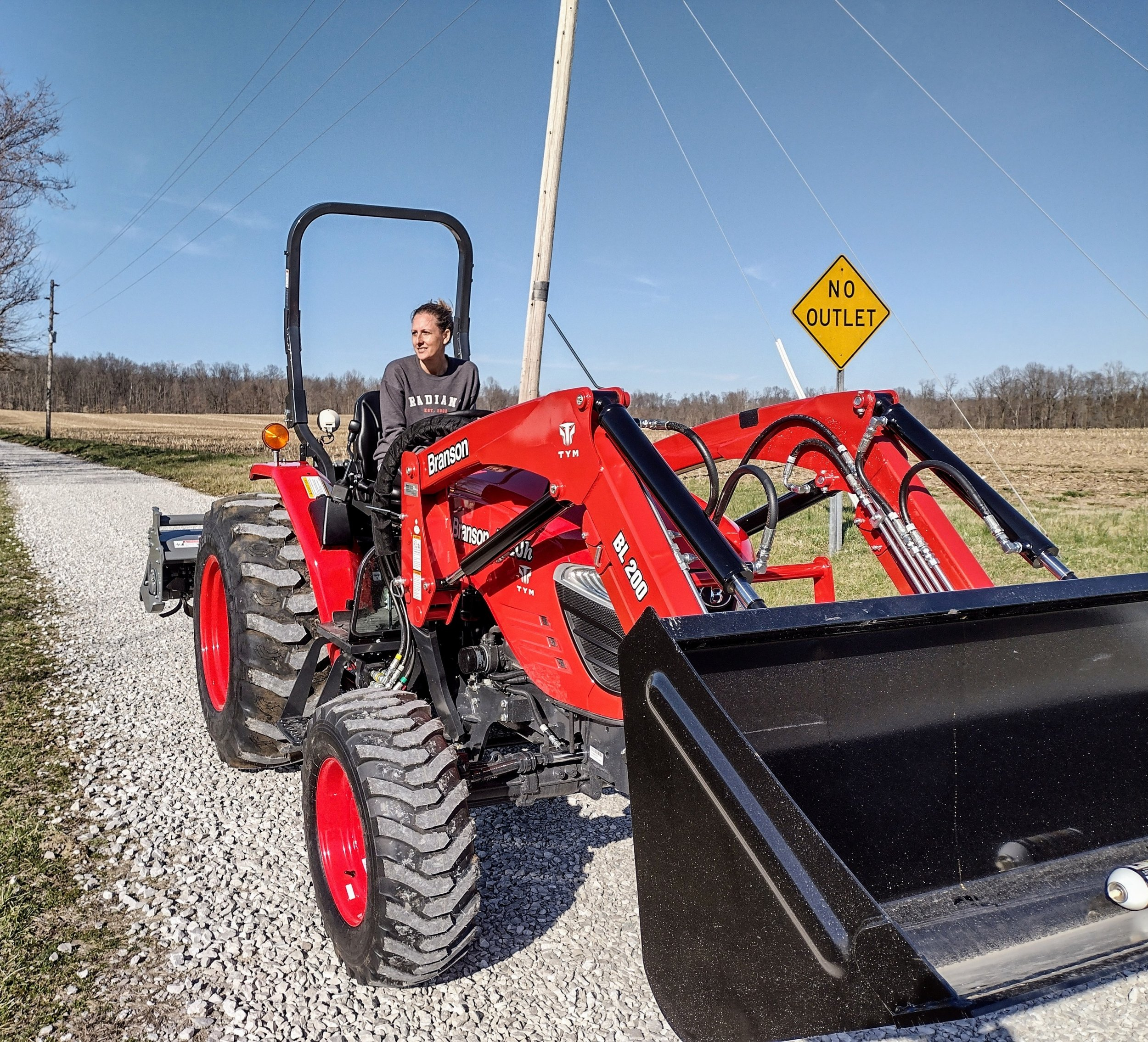

Finished cleaning up the paint and getting ceramic protection on it. Purrrrty

I'm following with interest, looking at either a T494 or the Branson 4820h. Had my heart set on the 494, but now I'm thinking harder about the Branson. Yours is one beautiful tractor. Congrats.
Bill
Thank you. I'm looking forward to actually putting it through its paces if it ever stops raining. For now she just sits in her warm, dry barn

Yeah like everyone else has said - that's a "good looking" tractor! I'll bet she works as well as she looks too! You've gotten me extremely interested in the TYM/Branson brand!! Following this thread to hear how all works out once she's "out" of the cozy garage and actually doing some grunt work; but I'll bet she performs as fine as she looks! Enjoy!!

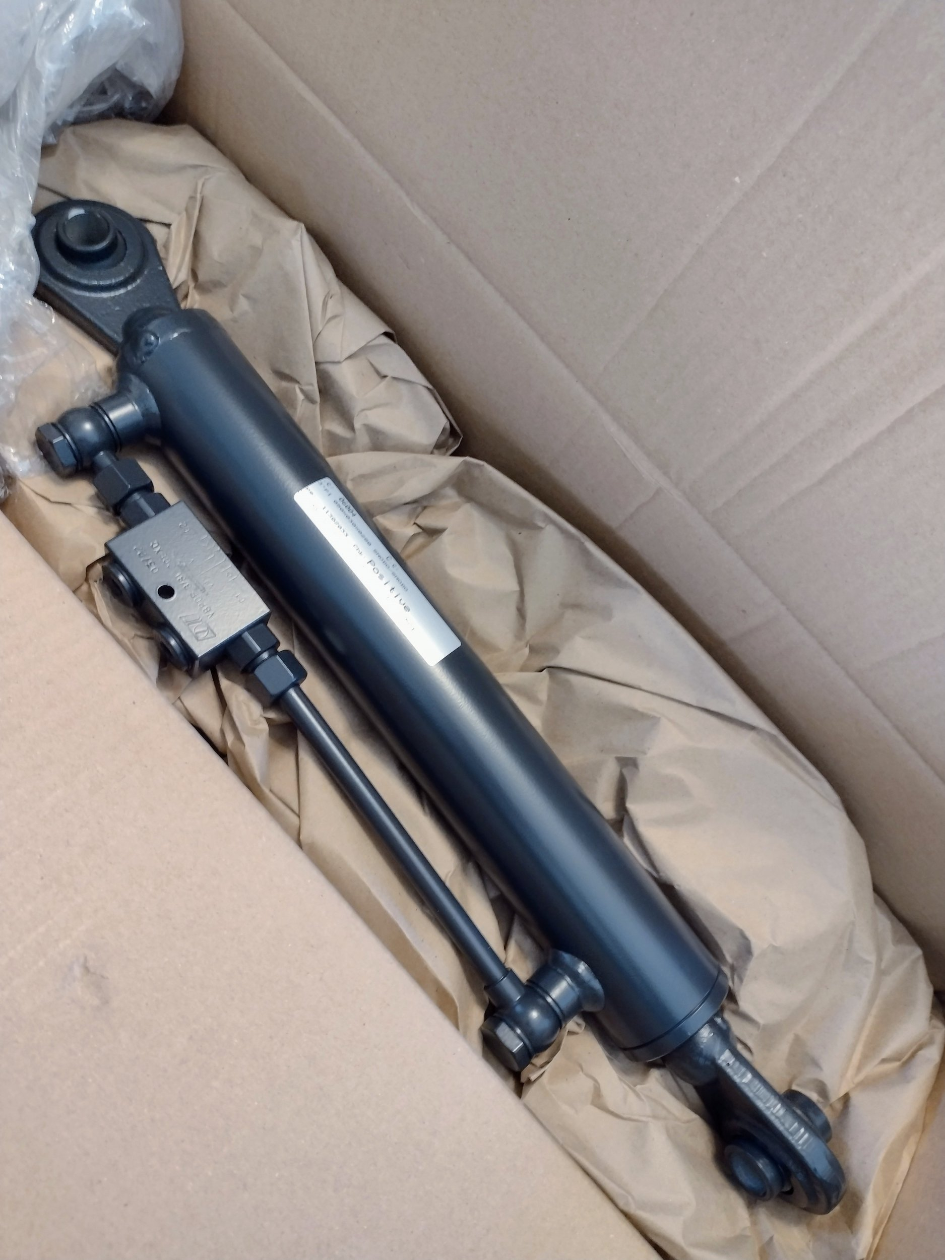

Ok, sorry for being a newbie (I'm shopping for my first tractor). What is this top link? Doesn't the tractor come with it?
This is hydraulic, so I can adjust it on the fly from the seat. For tilling and box blading

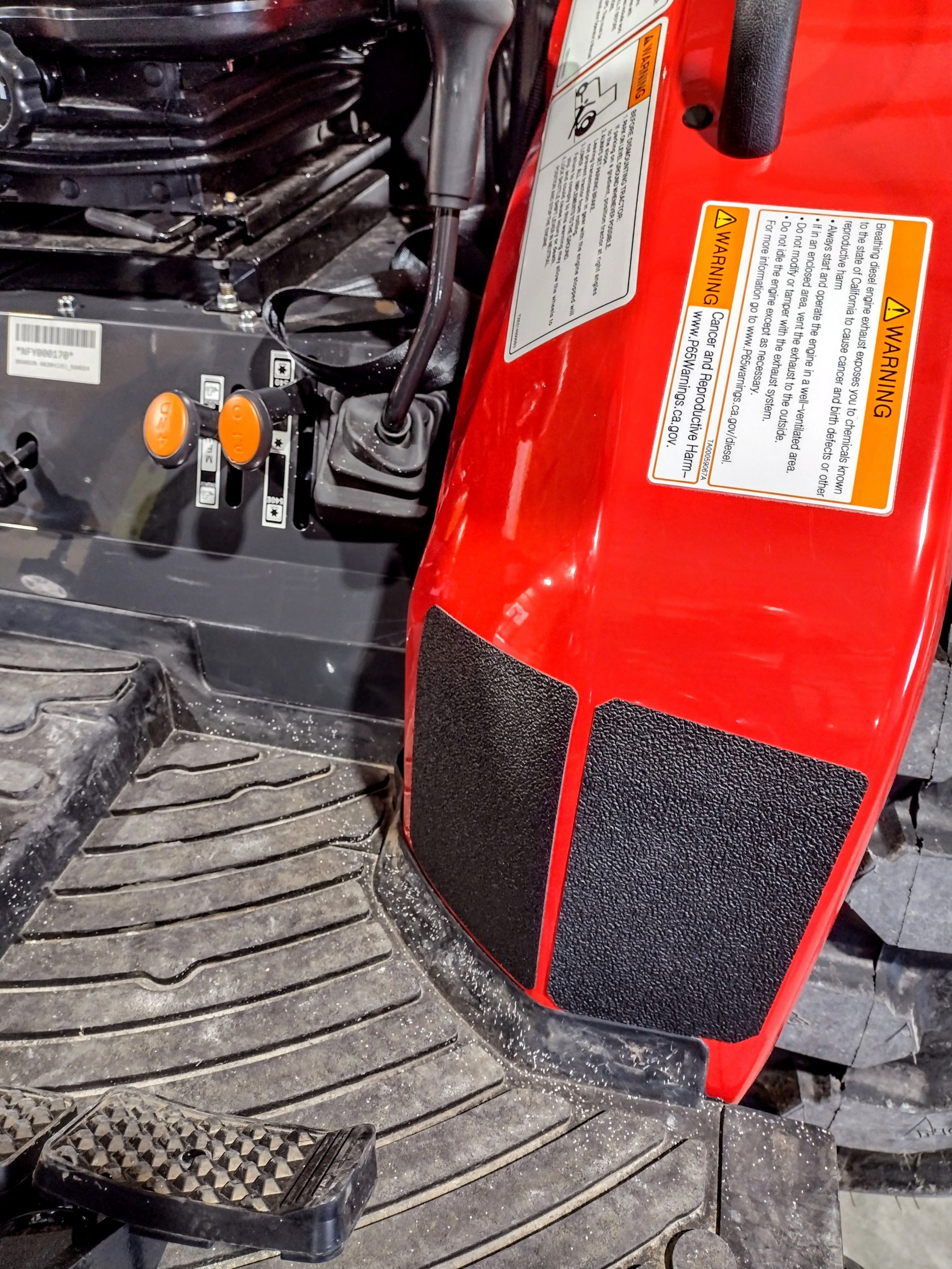

She took it just fine, right? It's quite a difference in noise and fuel consumption.
Yes, and the TYM tractors didnt have this option. I can see using it with a flail mower too. Again, while breaking ground it wasn’t really possible. But now, it’s easy to run along in 540E and sip diesel
/ It’s here! #98
Ok, what am I missing? 540E is just lower rpm in B range, correct? There is no switch is there?
/ It’s here! #99
540E is just another gear for the PTO. Not related to the range gears.
The common PTO gear that all tractors have is 540, which usually requires about 2500 engine RPMs to achieve 540 RPM at the PTO.
540E requires about 1800 engine RPM to achieve the same 540 RPM at the PTO. It will deliver a little bit less power, but if you're willing to go a little bit slower (not even needed most of the times), it will save quite a bit a of fuel, wear and tear on everything and a lot less noise.
Alternatively, can be also used with 2500 engine RPM, which will put the PTO are 750 RPM. Not many implements use 750 RPM, so this is kinda irrelevant.
Another great benefit, is that you now have a PTO selector lever with 3 positions: 540 - Neutral - 540E. This allows you to put the PTO in Neutral, so it will free spin which is great when hooking implements. Otherwise, the PTO brake won't let you spin the shaft.
