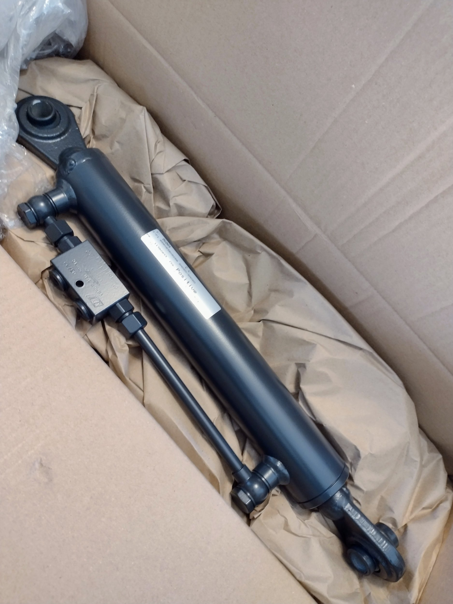

Ordered a couple inline restrictors from England. At this point I sort of wish the cylinder was US made, but it is what it is and BSP threads are all I have to work with. These are .031” orifice restrictors That I will install near the QD couplings. I thought about an adjustable restrictor, but read they can be tough to tune to such a small orifice, and they are quite large. That is a problem when having such limited space already on the back end. These should slow down the cylinder, eliminate chatter and be very compact

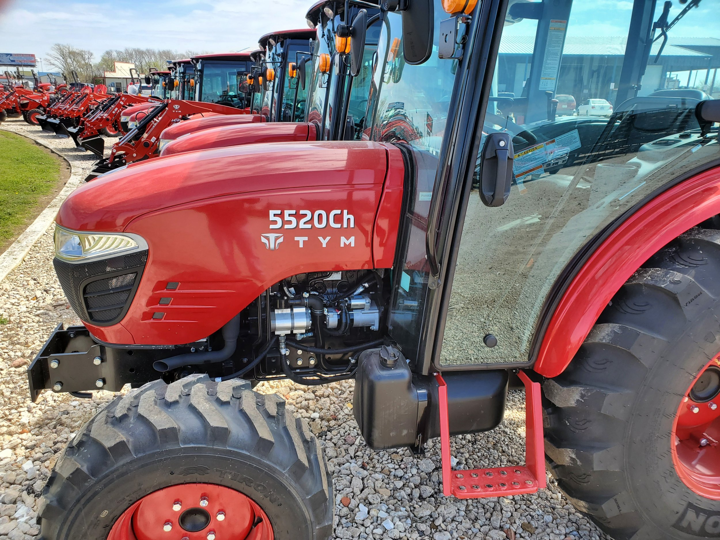

Thought you might like to see this...the 'new' 5520. It has the TYM red.
/ It’s here! #65
It was cool to see both types side by side. If you zoom, you can see they still have both old and new on the lot.
Which one are you picking? :)

Hoping to get the hydraulic restrictors placed in the top link lines this weekend… maybe even get the QH on

Well I got the hydraulic restrictors installed!!! Amazing performance now. No more jerky action and choppy extension.
I installed a couple 1/2" BSP restrictors with .03125 orifices, new Dowty sealing washers and 1/2" BSP couplers. Such a clean install!

I can’t post the video here, bummer. It is so smooth and controlled even with the remote lever full deflection
