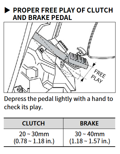

Hopefully, a linkage adjustment on the clutch pedal will fix it, albeit, once it starts slipping, it might be a bit too far gone. Should be a matter of following the linkage on the clutch pedal and you should see some sort of turn buckle adjustment. Get about 1" of free play on that pedal.

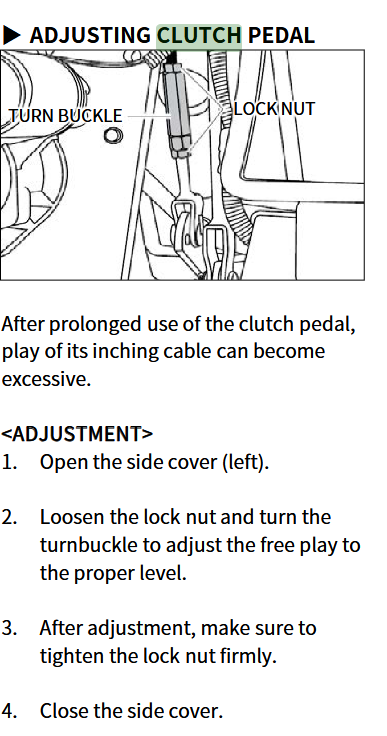

Anyway, somehow, I only have the workshop manual for the HST model but I've found something on the operators manual. Not a very good picture though.
View attachment 3201454 View attachment 3201455

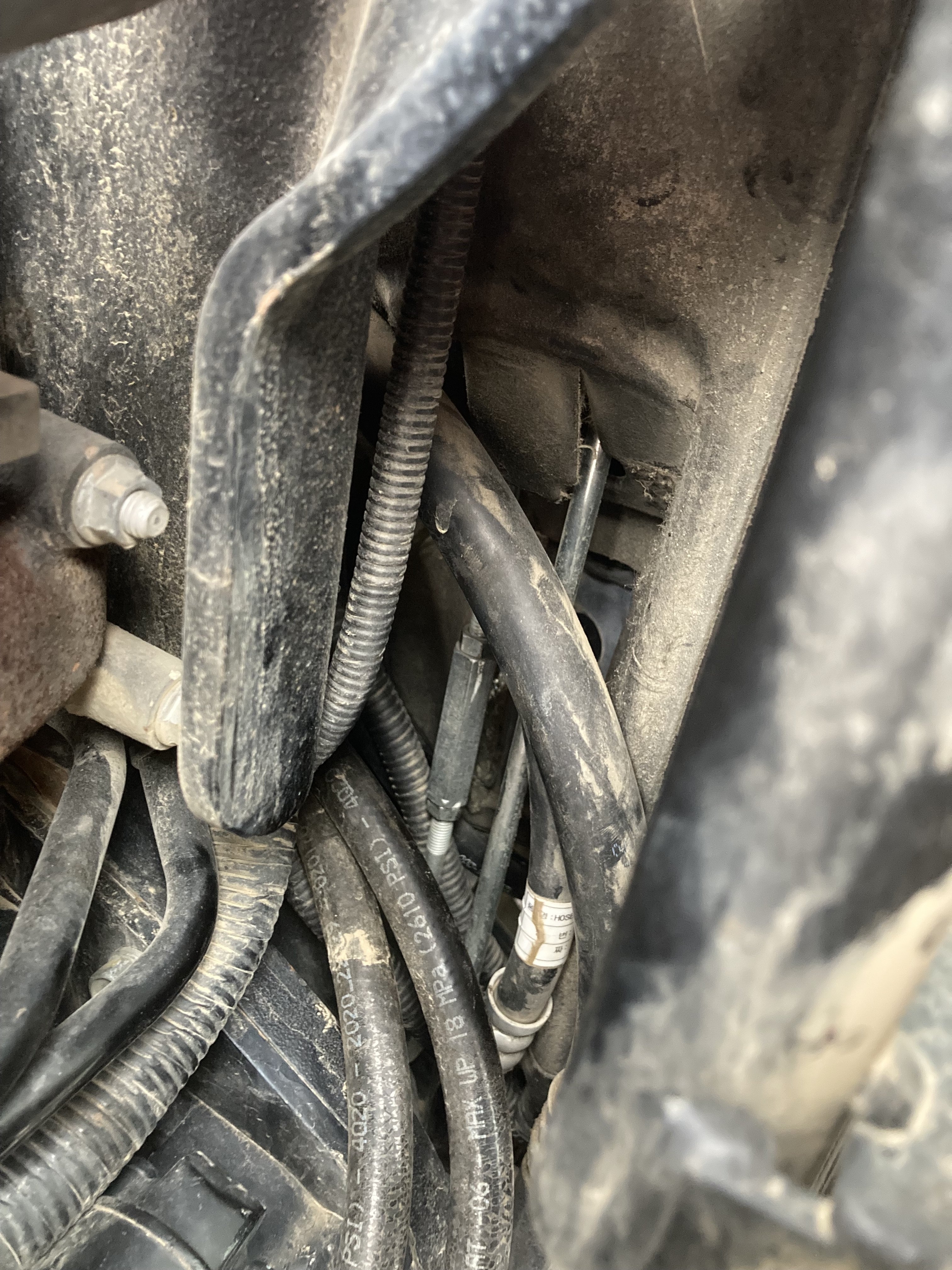

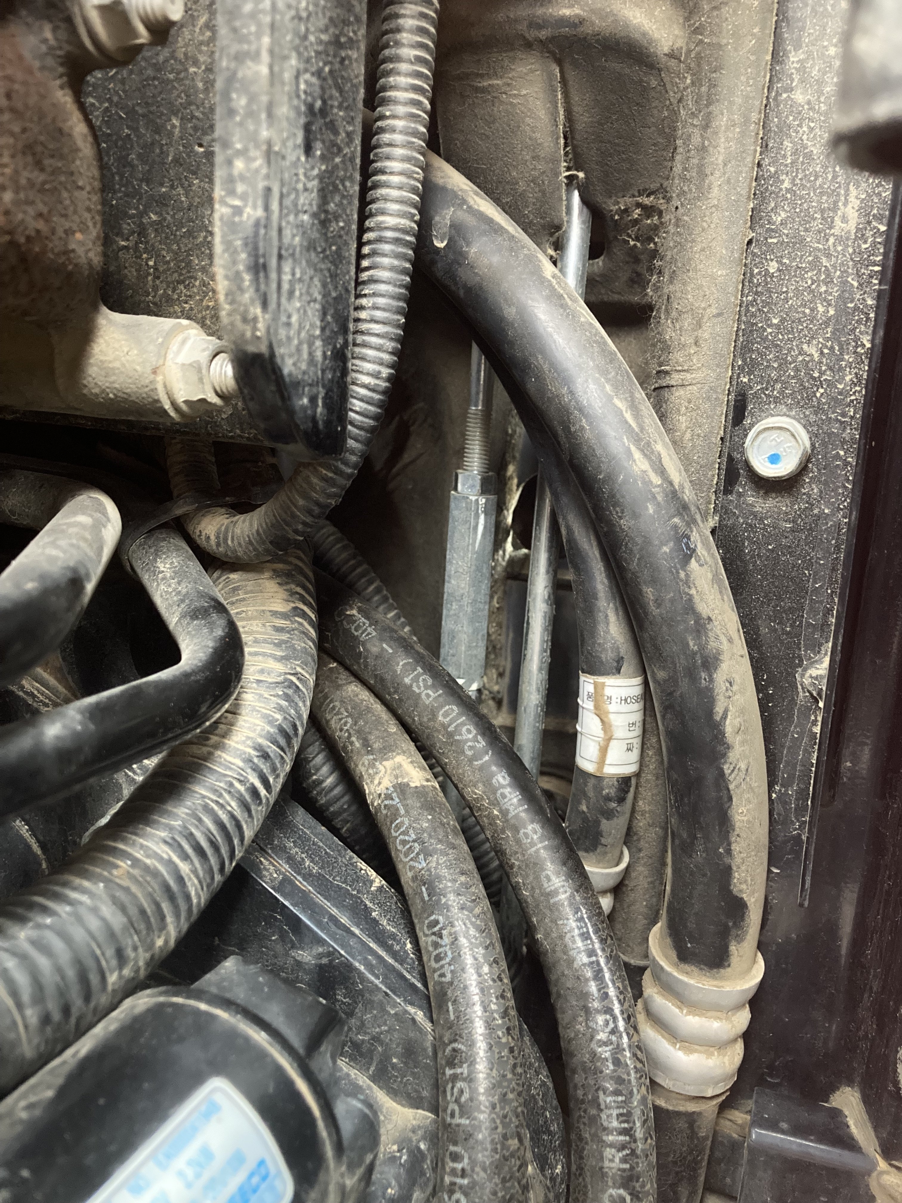

Hey there,
This is an update. I fixed it!
All of the nuts and everything were tight. But I loosened up the turnbuckle and lengthened it quite a bit and the clutch is engaging pretty good now. I had to lengthen it a few turns and it wasn’t super biting so I had to lengthen it a little more.

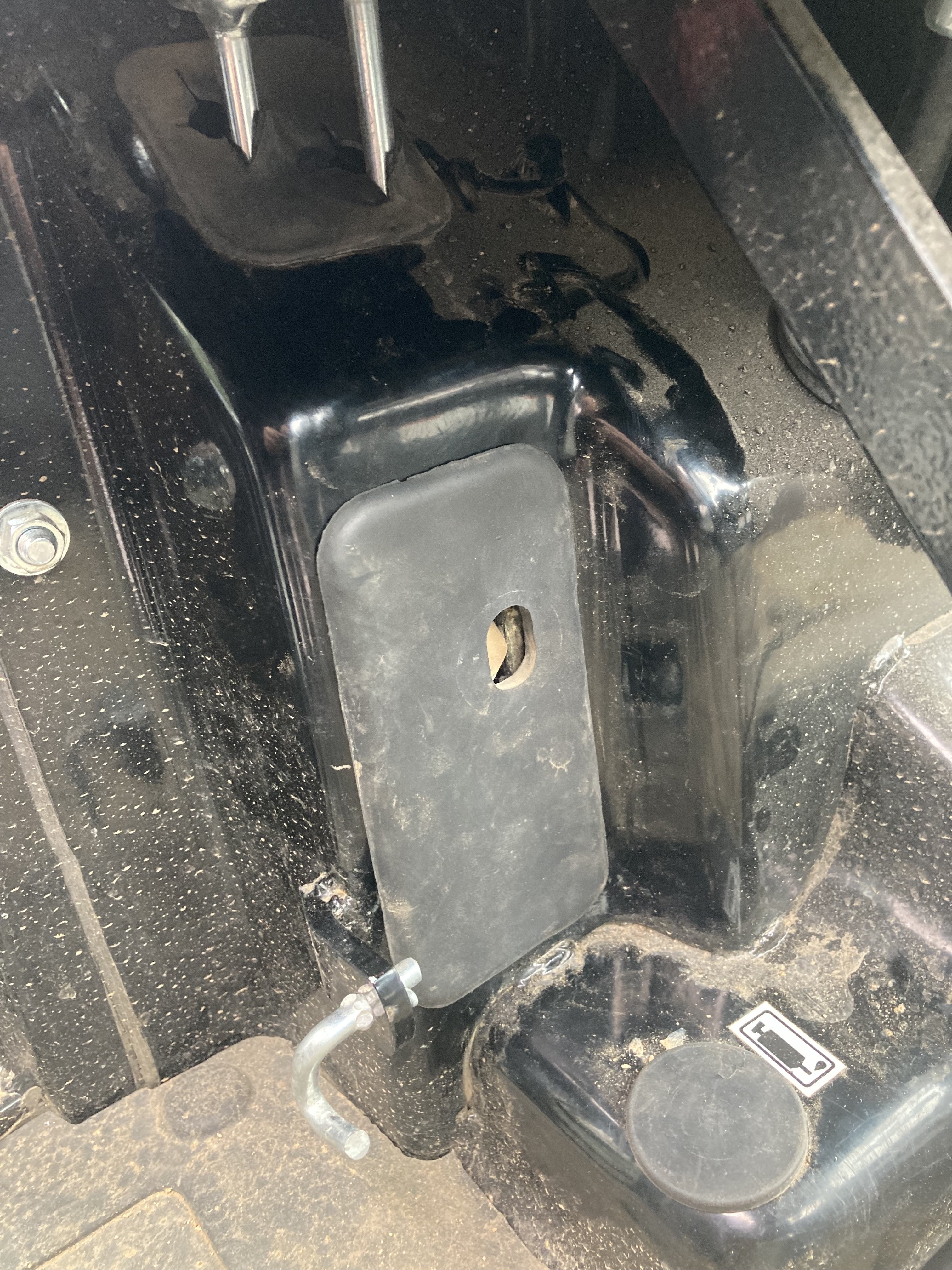

You can access it from under the hood, but there’s also a little rubber panel to pull out by the clutch pedal. It’s a 12mm for the locknuts and 14 for the actual turnbuckle, but bring along a 15 cause there’s not a lot of room to turn it and you need a little bit of slop. The top nut is reverse threaded.

Like the manual says, you need about 1" of free play on the pedal, before you can actually feel it pushing on the pressure plate. If there is no free play on the pedal, then the clutch will slipping and eventually wear out fairly fast.
