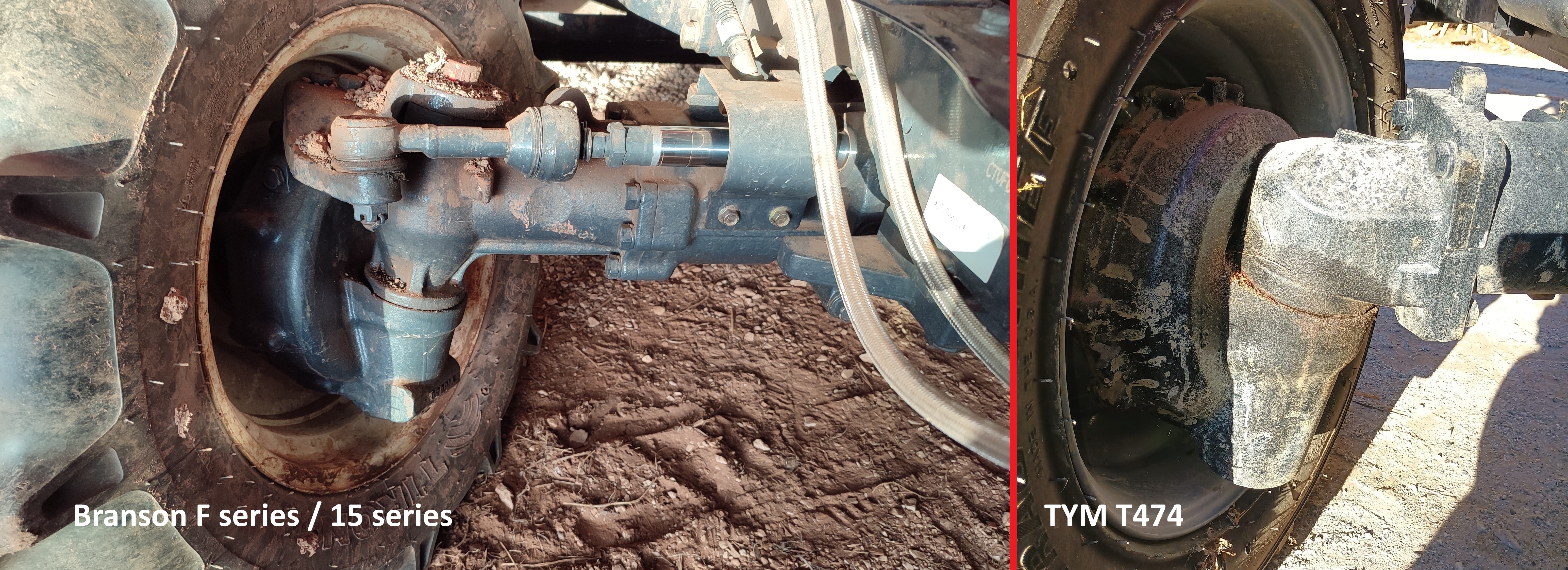

While Branson and TYM are technically one now, the tractors are actually fairly different.
Branson tractors are actually better built all around compared to the TYM ones.
The castings are heavier built, controls are a lot sturdier, the front axle provides a lot more support to the knuckle and I've recently discovered by going through service manuals that TYM uses ball bearings on the rear axle while the Branson uses tappered roller bearings which are much better on an axle that sees so many forces in so many directions.
Here is a picture comparing the front axle on the 15 series vs a T474:
Anyway, back to the shuttle lever. The RK37 uses a bowden cable, which can get more play and doesn't give that snappy shift feel. Not really a fan of it.
The Branson 20 series, uses a bit more complex linkage but shouldn't have that much play at all. Its a vertical shaft, that goes through a couple U joints and then a short linkage. In this one, you have to lift the lever slightly to move from all 3 positions ( forward, neutral, reverse)
The 15 series, like mine, uses a straight rod from the dash to the bell housing, then a short lever and fork moves the actual fork to change directions. Really nice and crisp shift. Even makes that satisfying clunk when it shifts.

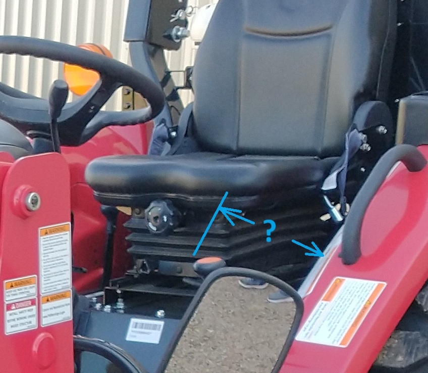

The problem was due to the new 4-speed range selector. With the 'H' shifter in 'C' range (where '3' is on a four speed trans), the lever is at it's furthest forward AND furthest right point of travel ... and that has that lever encroaching on the operator's left leg.
Here's a picture that I happened to take before I test-drove the 5520 that does show the problem.
Note the considerable distance from the fender to the far side of the shift lever. I didn't park the tractor there and don't know for sure what gear the range selector was in at the time of the picture, but I'm guessing 'C'.
So when running in range 'C', my left leg is squeezed between the range shift lever on the left and the steering wheel on the right, and there's just not enough room.
I'm not sure, but I guessed that I would be in a low gear in 'C' range when mowing (which would be the primary use of this tractor). So I don't think I can just use the other ranges and live with it.
It's a shame that if they hadn't upgraded from 3-range to 4, I would have fit since all three ranges would be in a row with the range selector shift lever up against the fender.

Maybe you could cut and weld the shift lever into a better position.
/ question for shuttle shift owners #7
What Eric said or even just heat it and bend it to another position. Not an ideal situation but it it what it is. For how well built those tractors are, I think it's worth it.
Thanks for the feedback. It might work out that I take a second look at the 5520. I'm a hobby welder and could probably adjust and/or shorten the range select lever a bit.
