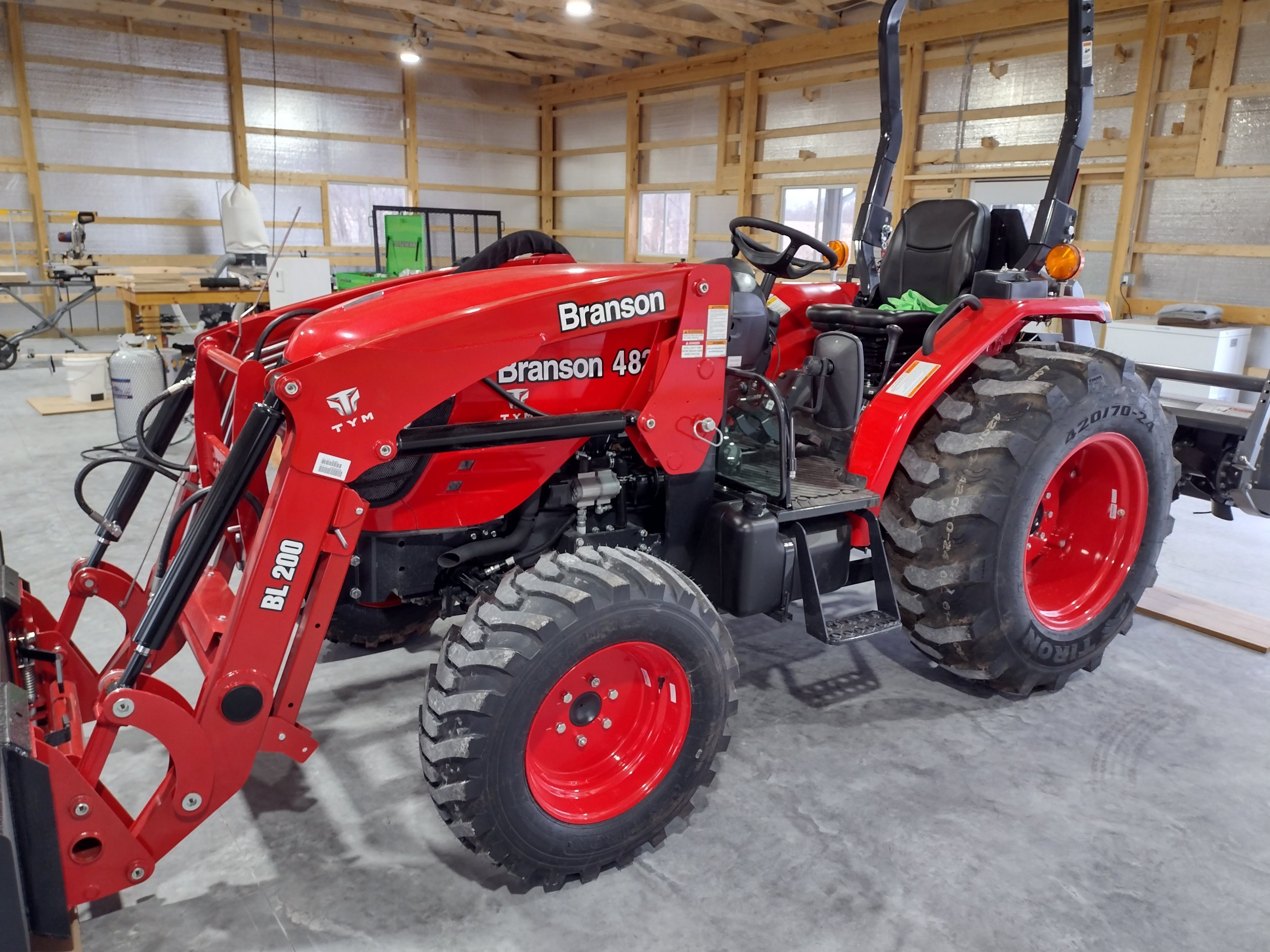

So one rear remote lever is quite stiff… it’s the detent lever. So stiff I saw the bracket underneath flex a bit. I then discovered that the bracket for the linkages was not properly installed. It is a large “L” shaped bracket with two bolt holes for the side of the transmission and two on top of the transmission. Thus the “L” shaped bracket. Well, the top bolts were not installed.
I can get some bolts and do so, though it appears I’ll have to remove the seat pan area to get good access to the bolt holes. Not insurmountable, but disappointed a little. A long reach pneumatic wrench will likely do the trick.

Got the bolt specs for the remote valve bracket from the dealer today, so I may find time to fiddle with that. Not insurmountabl, but I may need my wife’s hands to get in there

Service department claims they installed both bolts, but they must have rattled out… when the tractor has only run for perhaps 15 minutes since install. No, they didn’t, please just be honest. They sent me the spec for the bolts, however I bought the incorrect length… so they bottomed out well before tightening the bracket. So, back to the drawing board. I should have the parts needed by next week to finish up the bracket install. Getting to the bolt under the seat may require some ingenuity

I got the two bolts installed under the seat pan for the bracket for the remote lever mechanism.
The Italian made top link arrives tomorrow. One day ship, free ship! And, it is the same color as the Branson charcoal gray.
Tonight I will be working on the 3-pt quick hitch upper hook, as the Harbor Freight hitch needed an aftermarket hook. I still need to clean and maybe ceramic coat the paint… but we will get there.
