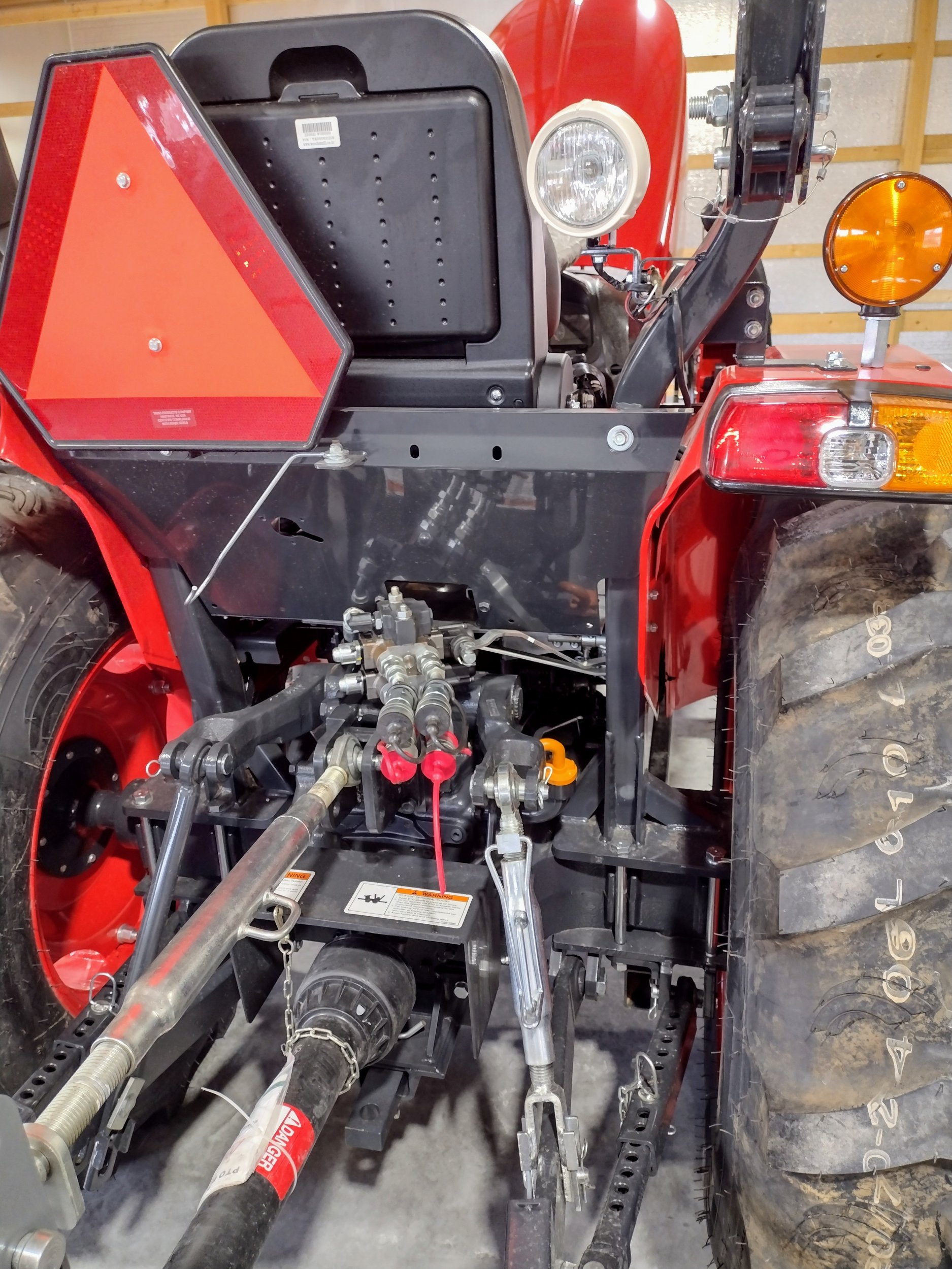

HYD Top Link installed
/ It’s here!
#47
The bushings for the tiller will be here today… so I’ll get the 3-pt quick hitch installed this coming weekend!
They didn’t seem to have cut down the PTO on the tiller, so the extra 4” of extension needed for the tiller should be fine.
The TYM diesel doesn’t even make a revolution before it starts… so easy starting and with the DPF still installed, I’ve never experienced an odorless diesel running. That is sort of nice.
There is some chatter in the top link when extending with a load on it… which seems to be a result of the check valve with heavier implements. If I move it slowly, it’s fine, but without feathering it will chatter on extension. Research has shown this is not uncommon.
The assembly and install was easy. Torqued the banjos to 30ft/lb and no leaks.

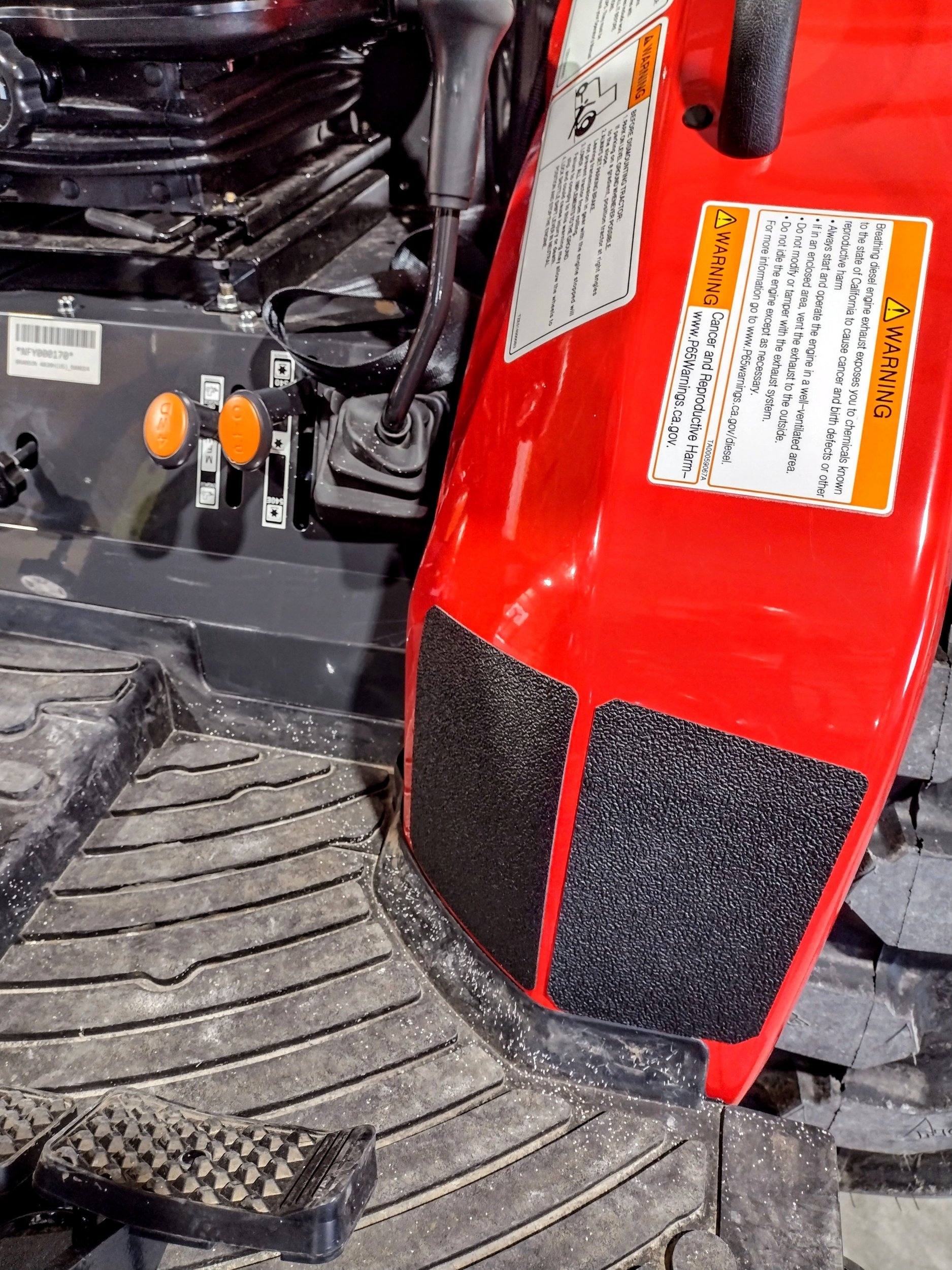

Added a couple kick pads to the fender, as it’s easy to kick when you mount and dismount. Yes, I’m trying to keep this unit for a long time, and care for it well.

Clover, I sure like those kick pads and that thought! Where did you source the pads from and what are they called? Thanks Greg

Amazon. They are from Tech Spec and are called Hith Fusion. They are grip pads for motorcycles in fact. The adhesive won’t transfer to the paint. Buy the generic kit as I did, it comes with a couple large sheets of the material. Make sure the paint is clean and free of wax where you apply to get good adhesion

Thanks for the pre-advice. Pads 1st, wax 2nd.

Looks like I’ll be installing a hydraulic flow control valve on the top link. It cycles very quickly, and it seems that the chatter on the extension is due to too high of a flow. Read posts here on TBN regarding this and the seller of the cylinder has valves available that are adjustable, so I can adjust the flow rate to the cylinder to control the cycle speed and eliminate the chatter on extension.
/ It’s here! #54
That'll do it. These double pilot check valves are known to do that when the rod extends faster than the flow can push it out, ie: Extending the top link with the weight of the implement pulling on the rod.
Plus, the Branson remote valves have a spot in the spool which will open the return port to tank before there is pressure from the pump on the other port. This also will contribute to make the chatter worse.

Looks like I’ll be installing a couple .031“ orifice restrictors, but I can only find the BSP threads overseas. This should help all aspects of control of the cylinder. The cylinders are Italian built, so everything is BSP 😏
