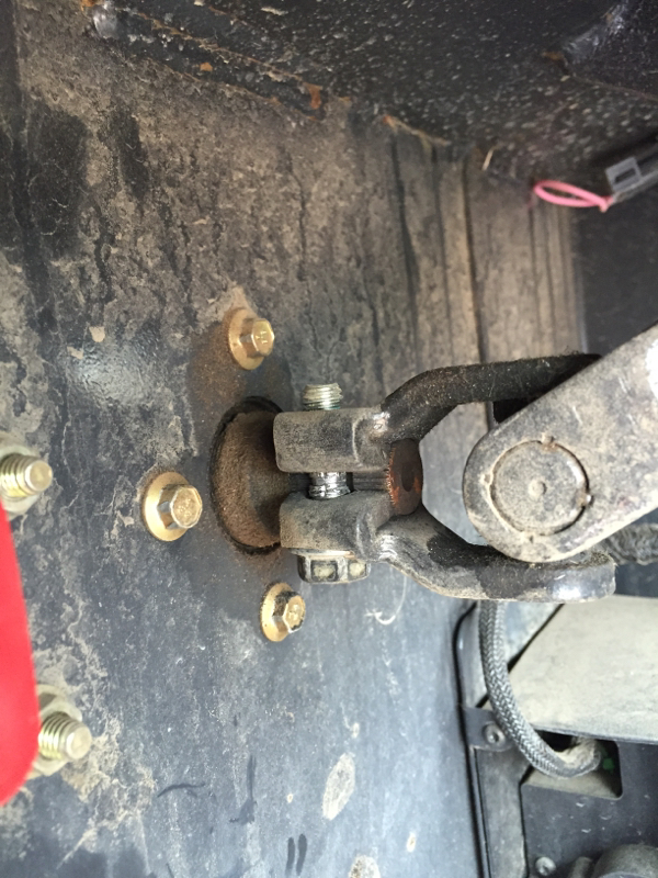

Hello, I'm new here and joined to get some help. Although I hope to buy a tractor in the future, right now I am borrowing my friends Toolcat 5600. I was using it today to move some dirt, while in 4 wheel steering, I made a turn after dumping, and the steering stopped all together. I can turn the steering wheel in either direction as much as I please and no movement what so ever. all the tires are at close to max turn so I can't try and put it into 2 wheel drive. All the hydraulics work i.e. bucket and bed, but the steering. when turning the wheel, at a couple points in sounds almost like it is binding for a second and then is free again, when it does make the "binding" sound, the wheels seem to momentarily move until the "binding" sound is gone. Any ideas on what this might be would be greatly appreciated! I look forward to hearing from you.
You say the bed still works, try raising it all the way up and hold it till you hear the relief valve, then down till you hear the relief valve. Do it a few times, see if it moves and sounds the same each time.
Then try turning the steering wheel.
Mine won't steer unless it is moving, but the steering wheel won't move. There is a thread here about that.

Thanks for the responses. Faxman I'm with you, although this put me in a time crunch since I have a barn going up Friday, and still needed to clear a pad for the lumber (barn pad is finished).
So after I spoke to bobcat, and ordered the part, back to the tractor I went. I traced all the wires going to the steering valve, found no chafing, put the bucket down and raised the front end off the ground and turned the wheel, kept hearing that "binding" sound. So I followed the sound this time. I'm embarrassed to say I found the problem right under the dash. The crimp bolt from the steering wheel rod that connects to the shaft going through the firewall had backed it's way out just enough that the teeth were no longer grabbing. Hope this helps someone else, I canceled the order on the part, and the cat is running like a champ again. I really appreciate all the help from everyone, this seems like a great place, I will indeed stick around!!

Thanks for letting us know what solved the problem AND, taking a pic. Glad it was a cheap, relatively easy fix.

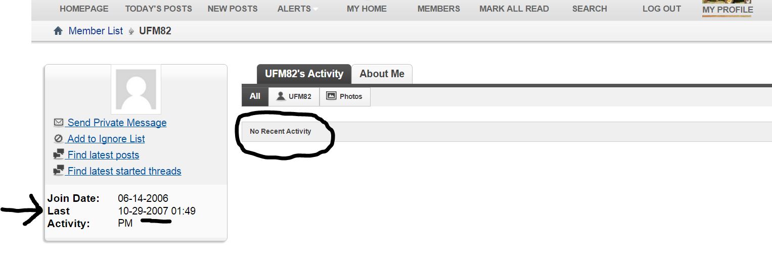

Well you won't get a reply from UFM82, since he hasn't been active since 2007, but I can tell you your 5600 is a B series.
Maybe someone with B series experience will see this and can answer your questions, if not, start a new thread.
