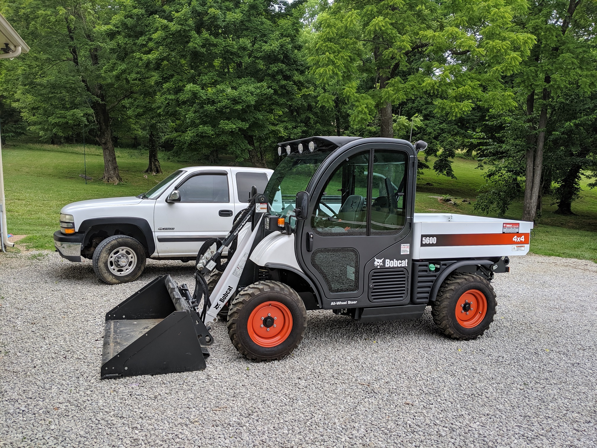

Well, after years of lurking around reading about toolcats, I finally have one in my barn! After I checked out a new model with no lower door glass, I realized that I preferred the lower windows and was able to find a new 2018 5600 that had a few demo hours on it. Dealer made me a good offer and I took delivery this week! Thanks to everyone on this forum for taking the time to post about your machines. You all just cost me a lot of money..... :)

Congrats!

Yep, congratulations. Now you need a grapple and a mower for it!
Looks great. It looks like it is loaded up with options too.

90 inch bobcat finish mower has already been ordered! I have a 72inch cutter already as well as a grapple that I ran on my CTL. I'm afraid it's going to be too heavy at nearly 1000 lbs to run regularly, so I may be picking up a lighter weight one in the future
