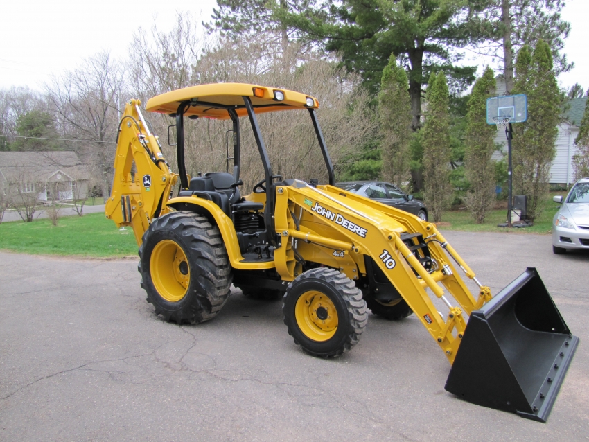

If you were unimpressed with a 7000 Lb excavator, you need at least JD110, L39, L48, L45, M59.

If you were unimpressed with a 7000 Lb excavator, you need at least JD110, L39, L48, L45, M59. Or get a small farm tractor and a used beat Full size TLB, hope the TLB does not break, and sell it when your done with it for more than you paid for it. (Win) (Or it breaks down and your really ____ed)
The excavator he rented was stronger than a JD110 or L45.

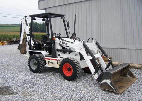

You might be able to find one of these older Bobcat TLB's in your price range.

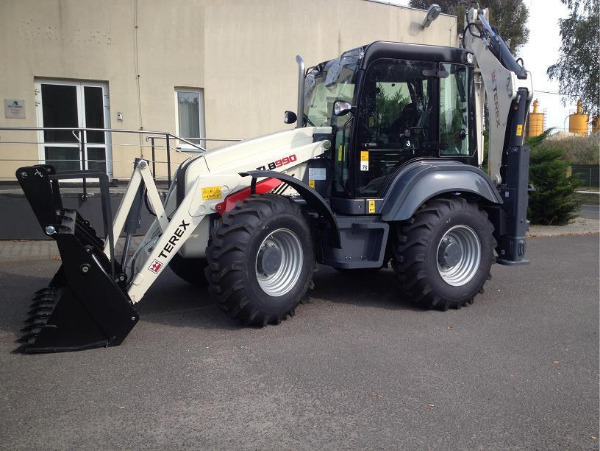

JCB makes a line of tractors in the size you are looking at but I"m not sure how the hoe attaches and if it can be removed easily. They come in several configurations including backhoe and box blade on the back

The Bobcat B200 would be stuck at every stump hole imo.
I thought about mentioning JCB as I seem to remember they offer a wide variety of options.
I looked into JCB and Terex before buying the 110tlb, both had some good options or pricing at the time. The first time I looked at the 110 I was not impressed and was considering a Cat 904 loader and 304.5 mini excavator. Just did not pencil in well with the extra moving costs for my jobs.
Still have not seen larger tlb's that are big enough to make a difference. JCB looks pretty good imo.

FWIW a 7000 lb. excavator won't do as much as your M59 but may be more capable than the 110. Splitting hairs here. The 310SG is way more capable than a 7000 lb. excavator pulling on a stump.
