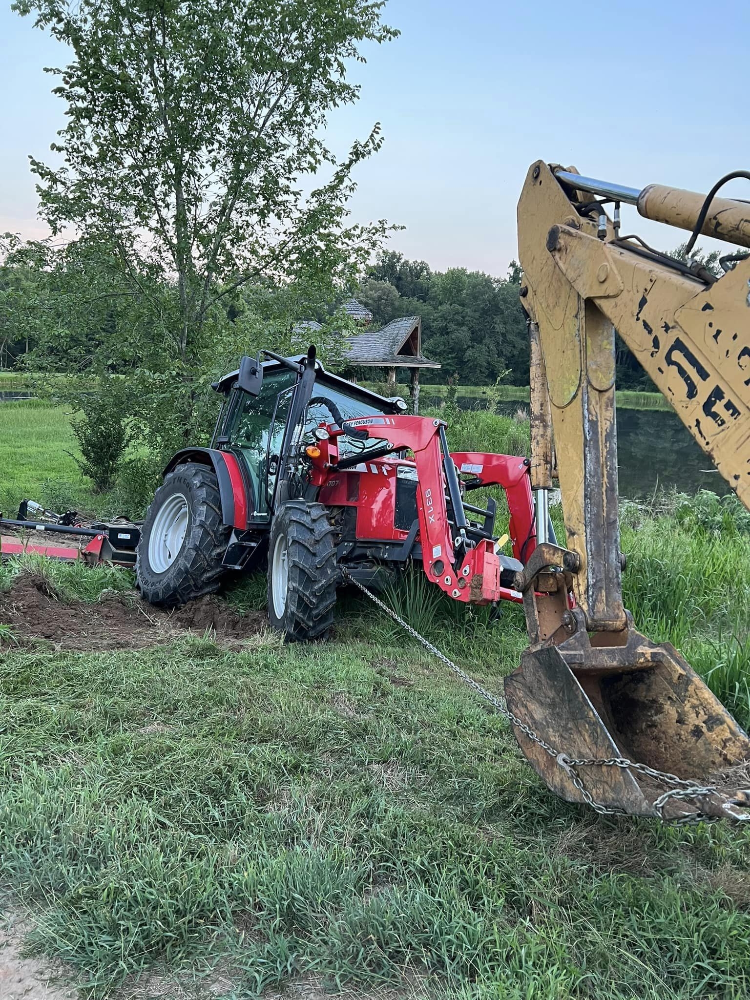

Also a backhoe is an excellent “rescue” piece. I have gotten a farm tractor stuck twice in 20 years and the only thing that could get me out is a backhoe. It was driven, over the road, into the field, and pulled my stuck ag tractor out using the dipperstick and a strong chain.
An excavator would have to be loaded, chained down, driven to site, unchained, pull out tractor (tearing up field with steel tracks), reloaded, chained down, driven home, unchained & unloaded.

I use my backhoe to pull my tractors and lawn mower out of the mud all the time. It's almost become a joke how often I get my zero turn stuck when mowing next to my pond. The walk of shame to get the backhoe is the worse part, but once I'm on my backhoe, it's pretty easy to pull anything I have out of the mud.

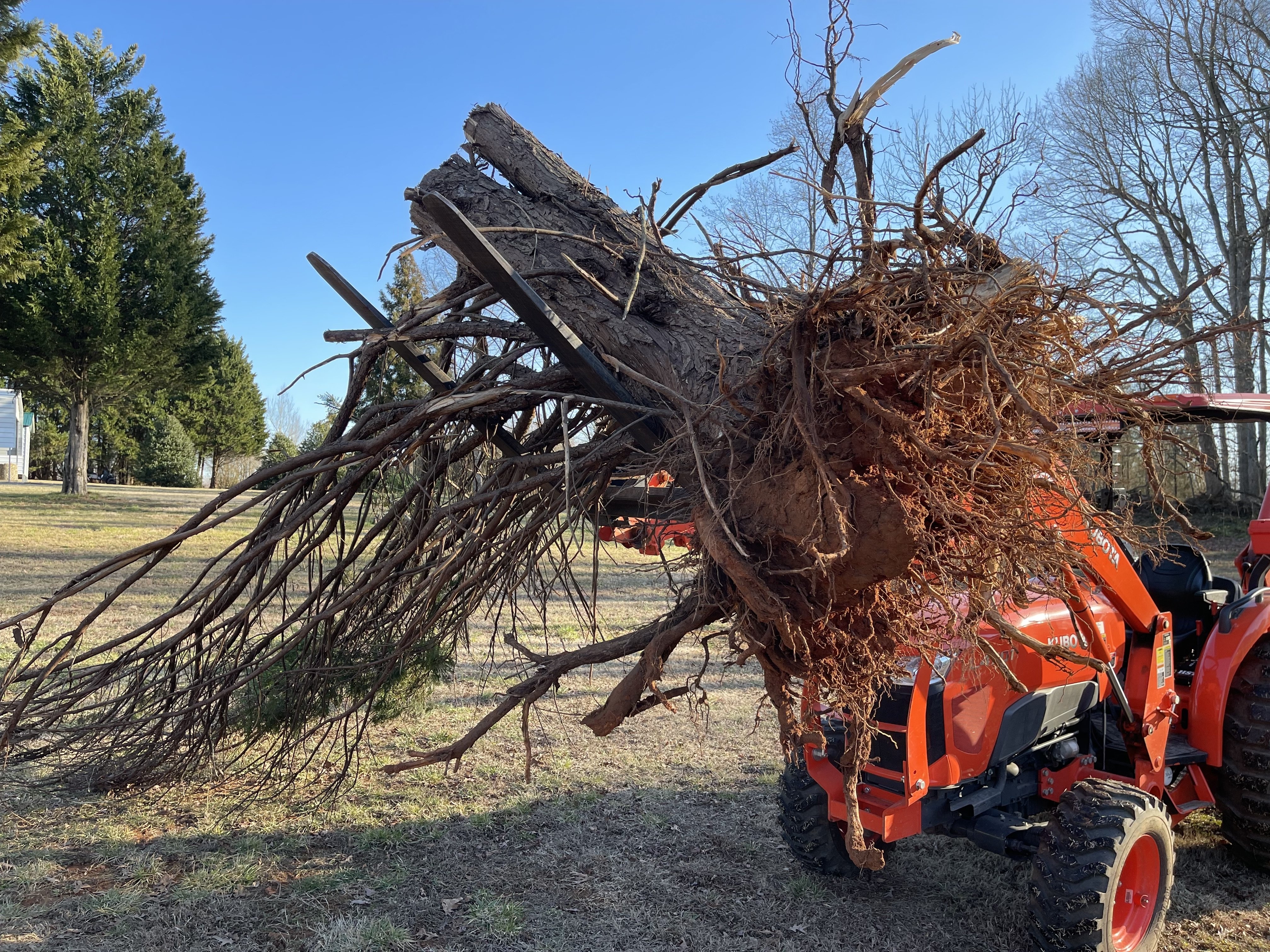

So this all came to be rather quickly. Monday went to look at and yesterday dug my first stump out with the new to me 1975 Case 580B I just paid $6,700 for with delivery. You are darn right that backhoe throws the tractor around. Was fun but Ive got a lot to learn. Now Mi just needs to warm up a bit.
My little 8,000 lb. L39 TLB has small R4 tires that break thru the grass roots on soft wet soil and it just sinks. As it is a TLB, it can pick itself up an swing sideways/pull to get on solid enough ground to get unstuck but what a mess it makes. Over the same ground I can drive my 3,000 lb. Ag tractor and not leave deep ruts, at least a few passes. I have used my excavator to pull the TLB for sliding/rolling down a 15' steep gully, etc on more than one or two occasions.
I have pulled/lifted stuck cars, trucks UTV's, other tractors, with the TLB when I can keep it on firm ground but it is only 1/2 the strength of a full size TLB.
The dipper stick on a backhoe is crazy strong once the stabs and loader bucket are down.
My friends JD210 backhoe, which is their smallest full size hoe, pulled my stuck farm tractor out of deep mud effortlessly.
WOW! WHAT A BEAUTY THAT IS ! LOOKS NEW !... and the price ...CONGRATULATIONS.
I bet you could rig up a soft canvas cab and heater real easily for winter.
In good weather I do prefer an open station with an insulated canopy like yours has.
Nice machine. I think you will be amazed by how much work it will do. And how much fun you will have doing it. If you ever need to install an infiltrator type septic system I can give you some pointers. I don't know how your hoe controls are configured. On my machine the swing control is from foot pedals. It is easy to swing the boom inadvertently on my machine. The boom swings FAST. It is important to keep people far enough away from the machine so that they cannot be struck by the boom. I have had folks come up on me while I was operating the machine and I didn't see them until they were inside the radius of the boom swinging. That really scares me because that boom could kill someone. So now whenever I am operating the machine I make sure to tell anybody that's around to keep away.
We got a log truck stuck on my job earlier in the week. I was impressed how easily my D3 dozer made the job look. There’s no way my rubber track skid steer would have done the job. We had the log truck suck worse the day before and the D3 didn’t struggle that time either.
