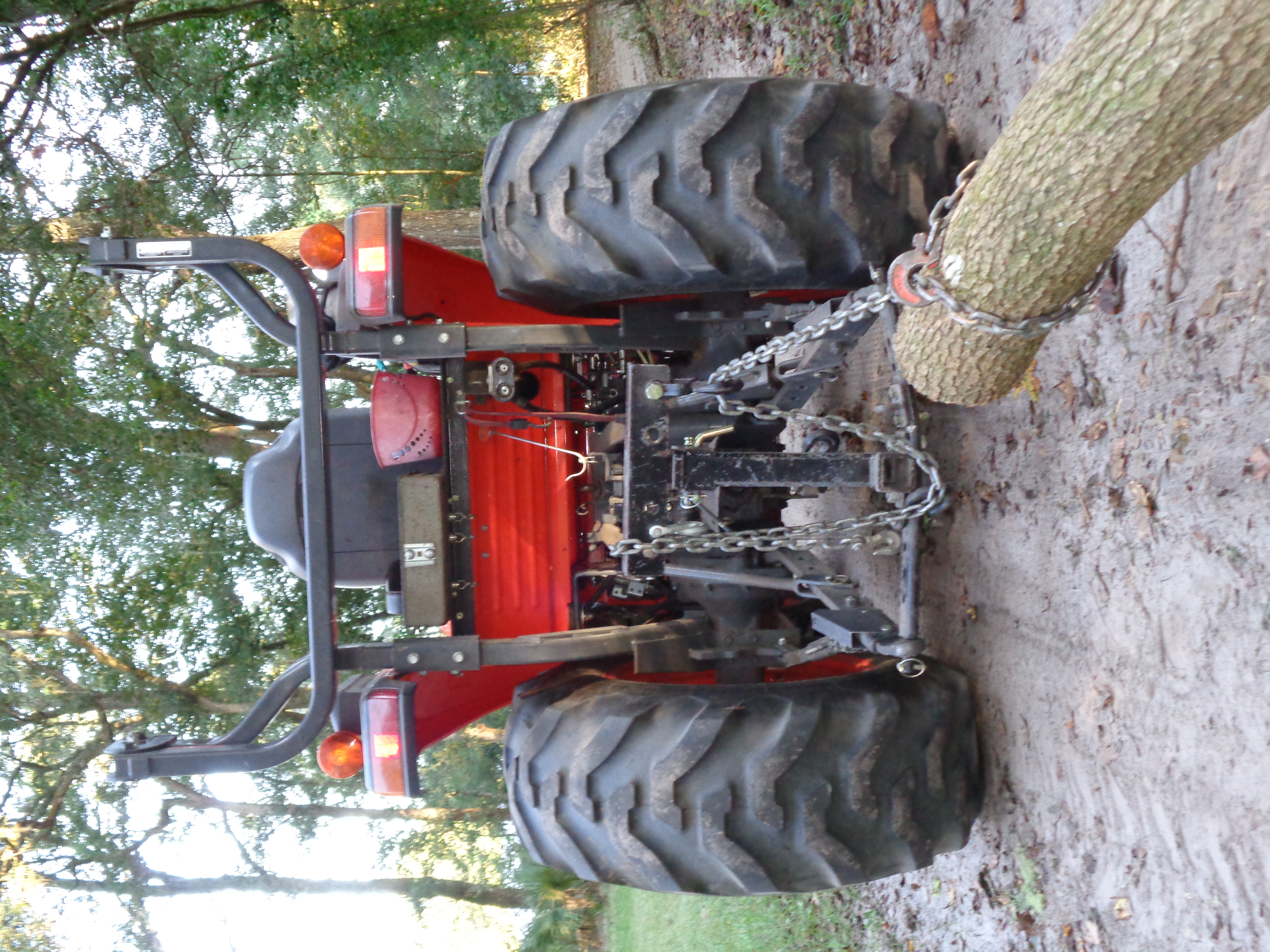

are the trees you need to move this large ?
This is an MX5100 and this tree was all the MX5100 wanted.
The Rears are full of liquid and I was bouncing the rear off the ground

Are the trees you need to move this large ?
The Rears are full of liquid and I was bouncing the rear off the ground.

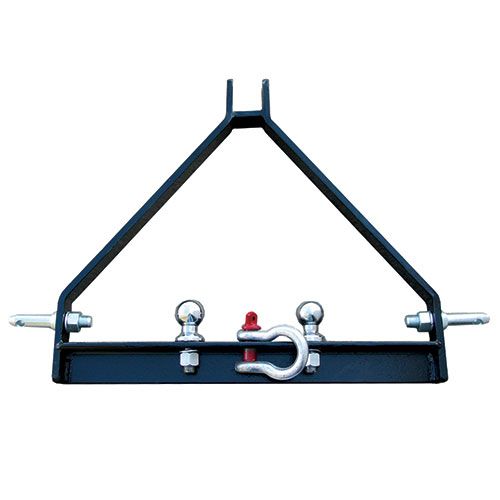

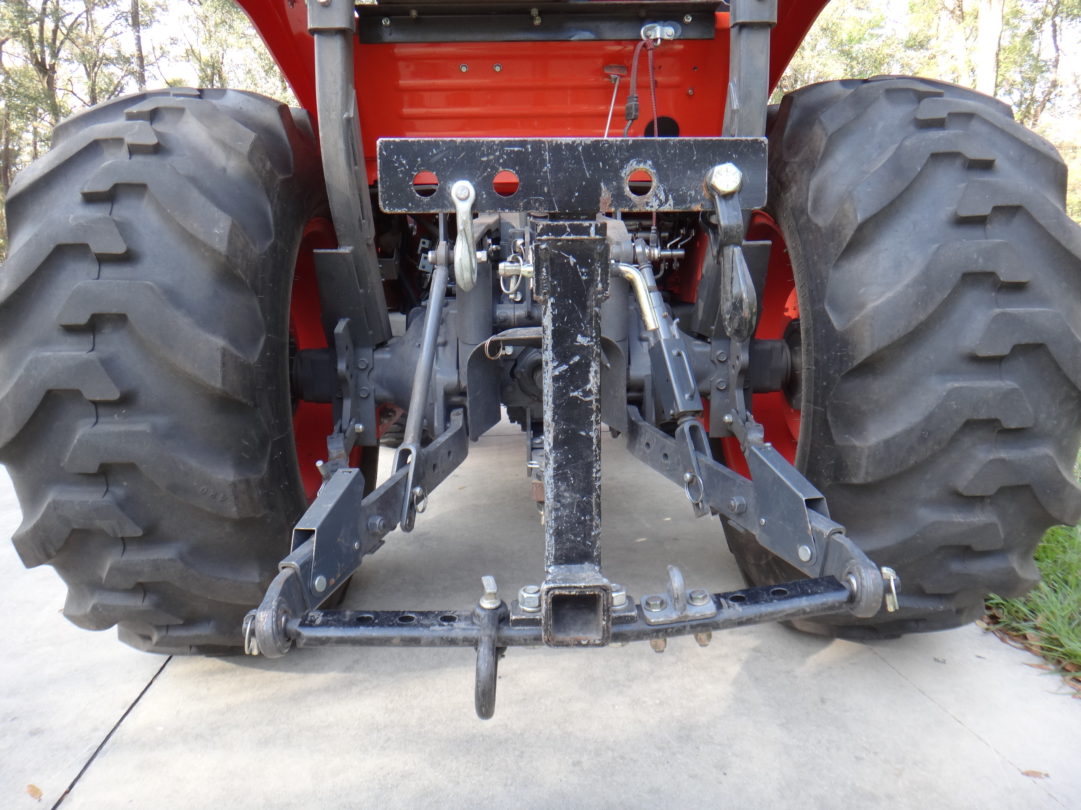

I have a 100 acre timber farm pluis10 acres of mixed fruit and nut trees, and a 2 acre family food plot.
-Dragging out the odd fallen tree, I will not be logging myself but will always have use for fallen trees and the odd times I may fell one for some use.
With chains elevating 50% of trunk length from a TPH cross-drawbar you could readily pull a tree weighing 50% more over the ground.
MORE: https://www.tractorbynet.com/forums...awbars-illuminated.html?highlight=ILLUMINATED
