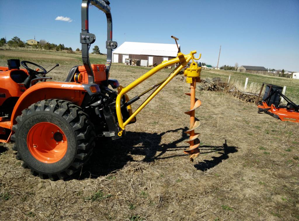

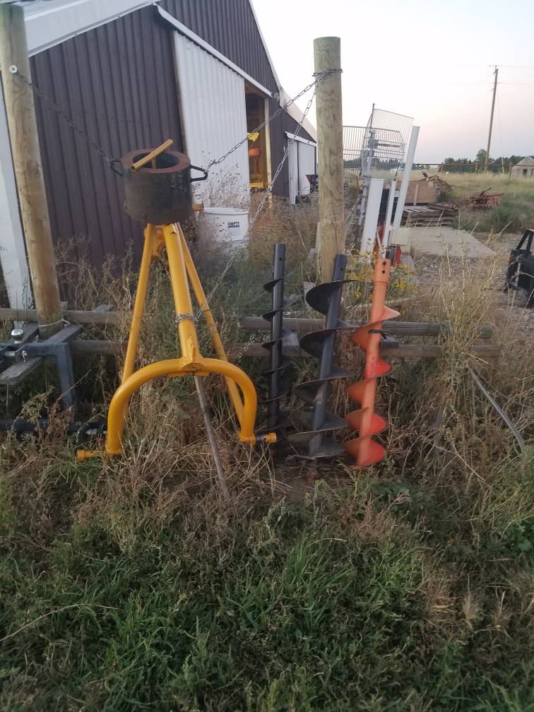

Look at a hydraulic PHD. A PTO PHD is $600-800 & a pain to put on. Additionally it doesn't have any downpressure so might not dig in a lot of situations.
A hydraulic PHD will be pushing $2k or so depending on mounting options. You can reverse hydraulics if they jam in the hole. My 40hp L4060 with 10ish gpm has noticably less power & speed with my hydraulic PHD than my old 32hp L3200 had with a PTO PHD. The flexibility & usability, not to mention ease of hook up makes it worth it. The bigger hydraulics on a TBL might offset that letting you get a PHD rated for more flow. Hydraulics mean you can hook the PHD up to your hoe or the loader giving you lots of flexibility.
Augers for hydraulic PHDs (2" hex or almost 3" round) are 30-40% more expensive than PTO augers (2" round), but are that much heavier & beefier at least.

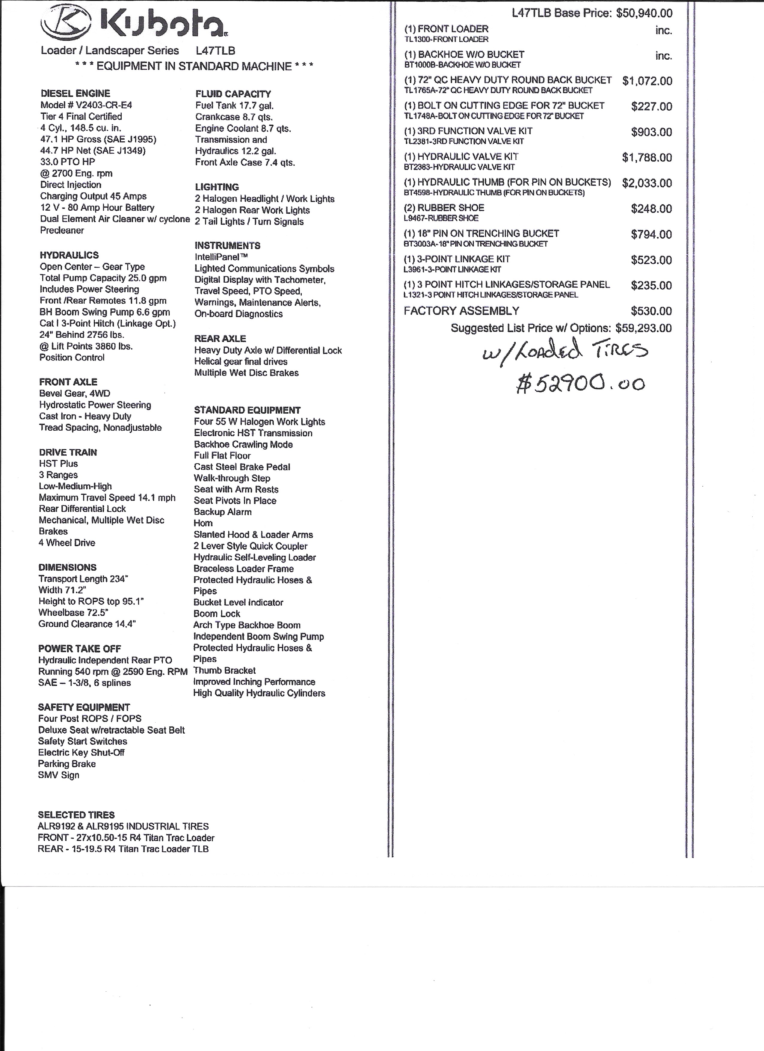

This is what i bought . I also got the 4 in 1 bucket 517538d1501941433-kubota-l47-price-comparison-001-jpg.jpg

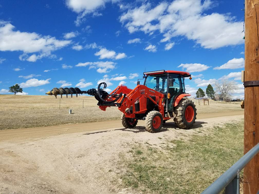

Interesting idea and I went off to research. Here’s what I found out:
L47TLB has an 11.5gpm flow up front and that may be shared with the loader so I don’t really think that helps me with a hydraulic phd nor will it really give me the ability to run at speed and put downward pressure.
In addition I found many folks online who are saying that if you need to push down on the auger with any kind of serious force than something is wrong with the bit.

My L4060 has 9-10gpm or so, pretty much the same as you. 2500psi * 10gpm = 14.5hp. Ya, flow is anemic compared to a skid steer, or the 25pto HP in my old L3200. But I can keep up or outdo the holes per hour I could do with the L3200. The usability & visibility of the reversable hydraulics up front on the loader beats killing your neck looking over you shoulder & working about getting the auger stuck & having to dig it out.
I rebuilt my old 3pt PHD to be quick hitch compatible on my old L32pp due to the pain in mounting & to get some hydraulic downpressure. I also added 200lbs of ballast over the gearbox for more downpressure.
To some degree what you hear has some validity. You need sharp teeth appropriate to your soil conditions. But in many soil conditions like the clay I have, good unworn shart teeth aren't enough. You need downpressure to drive that auger into the ground to get a bite.

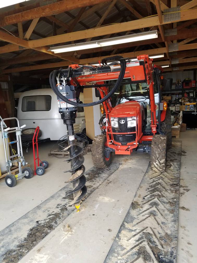

View attachment 539893View attachment 539894View attachment 539895View attachment 539896
Which hydraulic PHD is that and what are those tractor wheel mats in the garage?
Danhuser. Don't remember the model, but it's the 2" hex drive & GPM range for my (your) machine. Easy to figure out if you browse through the models.
I got some chunks of conveyer belt a while back. My intent was to have it chewed instead of the concrete when I had chains on. Haven't needed to put the chains on in the past 2 years though. I actually rolled them up & put them away a few months ago as they got in the way sweeping the dirt out & generally being a tripping hazzard.

A few items:
- Which grapple is that in the max rock pic?
- OEM Lights: I think it comes with 2 front and 2 rear and I can buy more I guess. Seems like the base four points give me enough to replace some/all with multi-direction LED banks or similar.
- Regarding my question on the hydraulic quick attach, here's my understanding: the L47 FEL has a quick attach which is SSQA style spring loaded levers. I'm also getting a third hydraulic valve on the FEL for interesting attachments. Here are the questions:
a. anyone know for a fact if that third valve shares the hydraulic flow (of 11.5gpm) of the FEL? so running a post hole digger and moving the loader up/down shares the same flow for instance. I ask because the backhoe at the rear explicitly calls out independent pumps to swing and curl/boom/dipper movement.
b. there's an option called Hydraulic Quick Attach which says it's two button to actuate the SSQA style levers for around $1.5k additional. Looking at the part diagrams, that means that those levers have to connect to some hydraulic which I assume would be the 3rd function valve on the FEL. That's cool if I'm swapping buckets or to/from manual forks, but if I go to a PHD or Sweeper or other hydraulic attachment, not only do I get off the tractor to connect, I assume I lose the hydraulic quick connect as I would move that 3rd function off the FEL to the attachment instead of the hydraulic quick attach. Correct? This was my initial question and yes, it seems a super ridiculous scenario which I should pay more money for and just stick with the 3rd function and manual quick attach.

http://www.tractorbynet.com/forums/customization/321704-linear-actuator-power-ssqa.html is my linear actuator power SSQA build. Fundamentally hydraulics do the same thing in the same spot (handles might get changed, don't remember). You'd have to confirm it with the dealer but I'm relatively sure it's separate valving & plumbing from the 3rd function.
Personally I think $1500 for it is way to expensive, you can buy a good impliment or 2 for that. But then again I'm building my 2nd power SSQA myself. I'm looking at $300 for mine though.

6. At least a brush mower which I don稚 have yet. I was thinking about a post hole digger but can go front side on that. If just the brush hog the. I could get into some seasonal on/off swapping with the backhoe to reduce swaps.
8. Which soft can and how easy is it to swap?
Borgford grapple.
I'd go Wicked, their HD one or if you want to get a ok grapple at a great price, Check out Fea Bay! Really my boss got a nice one.
1. Not sure, on rear remotes. I don't have any. I though you could get a pair? Ask dealer or Kubota?
6. PTO & 3PT is sure nice to have, especial when its on my smaller tractor, a Max28, or one of my neighbors! BH is not that hard to remove, I am just lucky & lazy.
