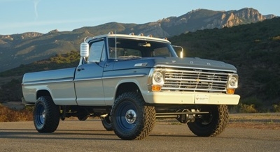

or truck:
... (many of which are manual shift) and not have to ask the seller to take them for a ride because they didn't grow up regularly operating a geared transmission.

or truck:

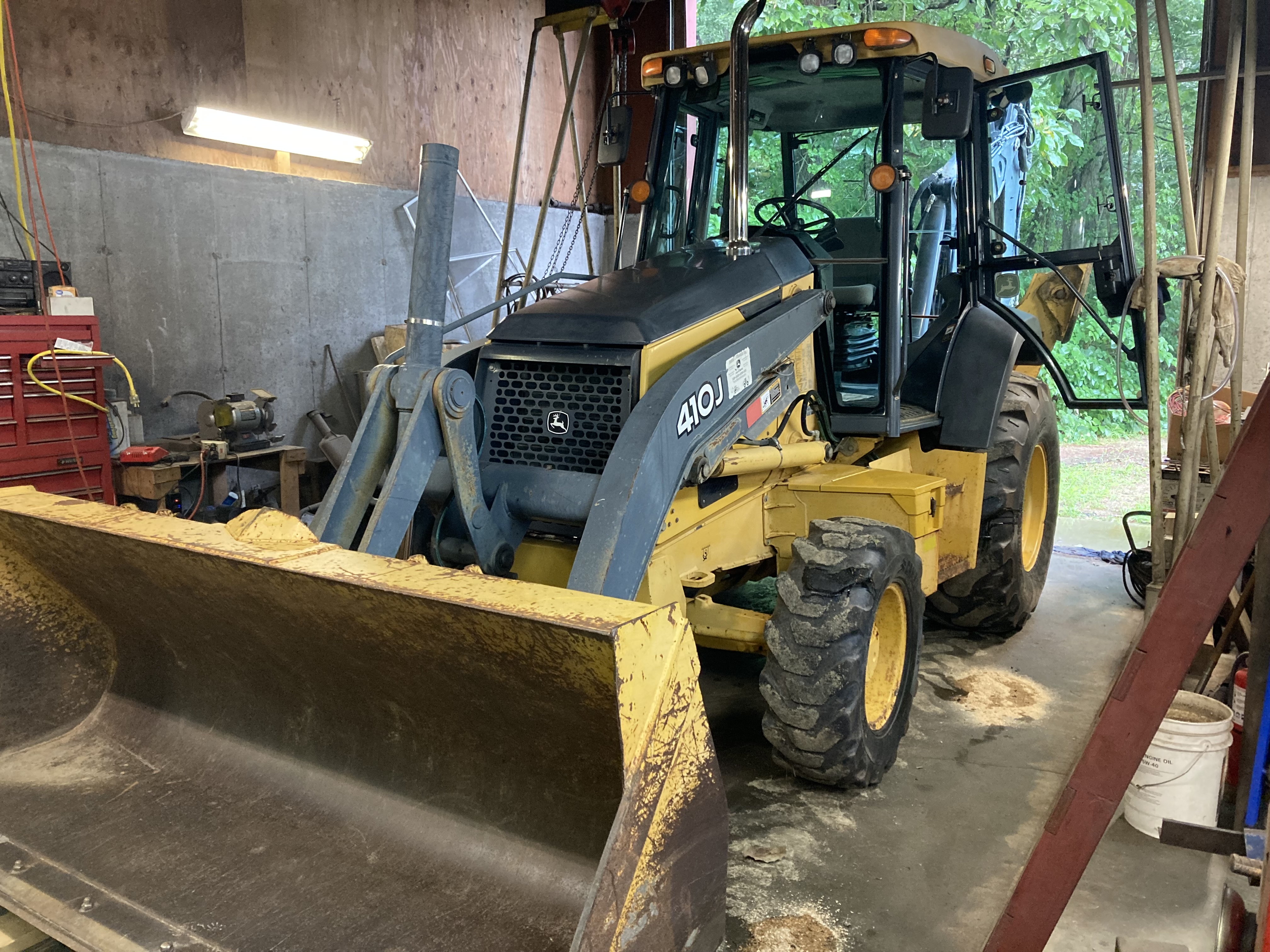

Our JD410j is as close to I'll come to an automatic with it's powershift. If I'm pulling a hill with a moderate throttle and roll the thumbwheel into 2nd the critter will wheelstand. It's marvelous to handle at low speeds in a tight area. To me it's the best of both worlds (manual or automatic equivalent).
   / Advice on Hydrostatic Transmission vs Gears #73
Agreed. We have an '07 410J and it is a dream to operate. It has a reverser, but no gears, just four ranges. Best of both worlds and super easy to use, and use well.
