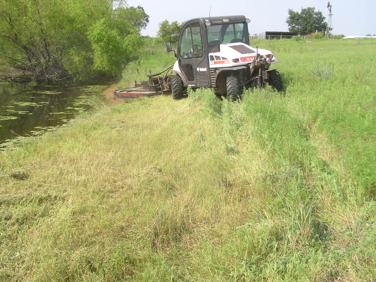

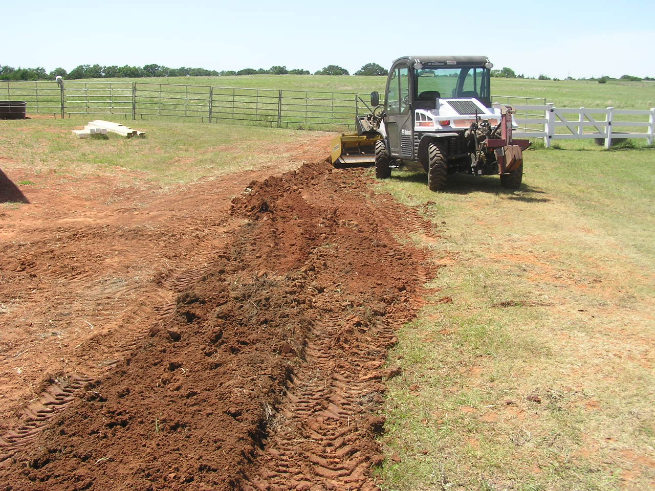

Xfaxman, I'd be all aboard with one of those IF it had a rear PTO (or hydraulic functions) to operate a mower.
The 5610 has a PTO but it is only rated at 25 hp. The red PTO shaft cover is barely visible in this picture:

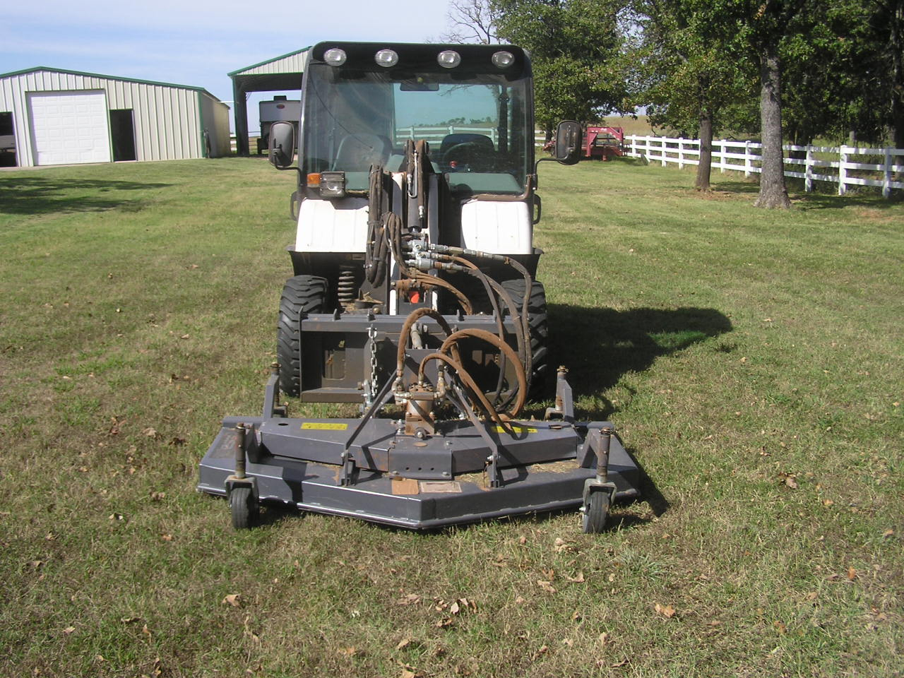

I like to have the mowers out front, crab steering the 7' brush hog mowing over the edge of the pond:
And the out front 6' finish mower:

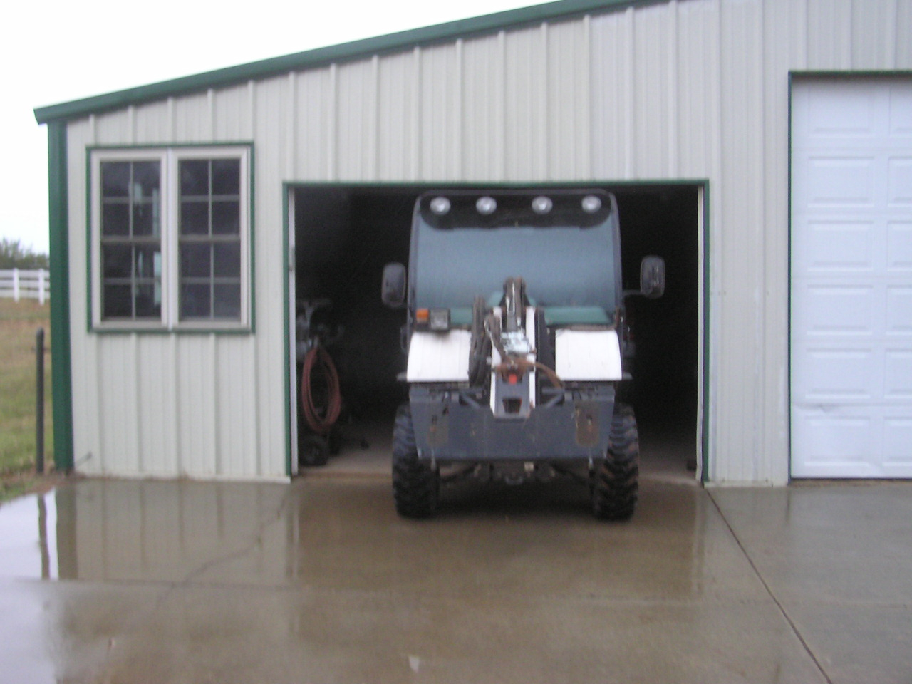

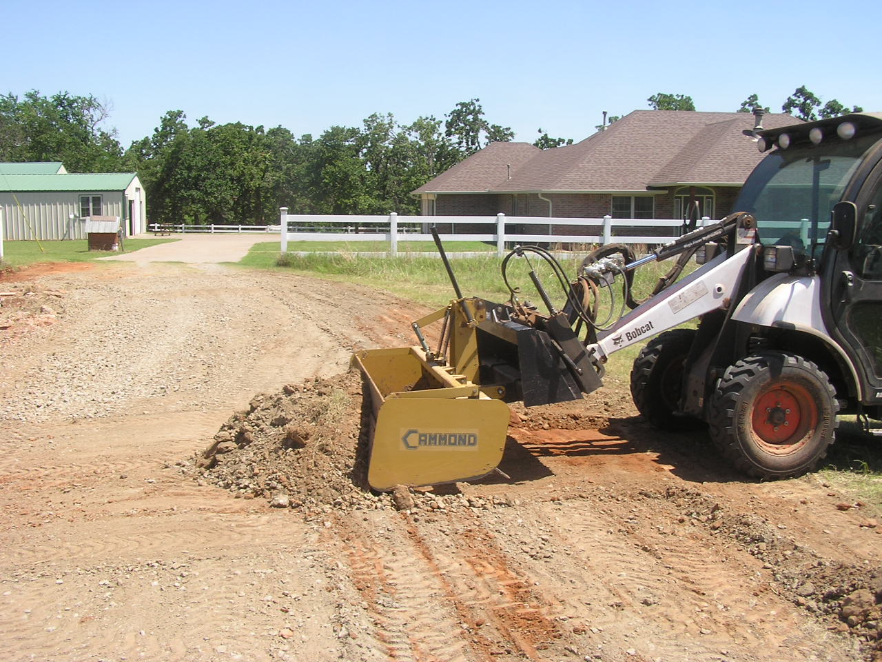

Some info on the Toolcat:

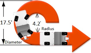

4 wheel steering:

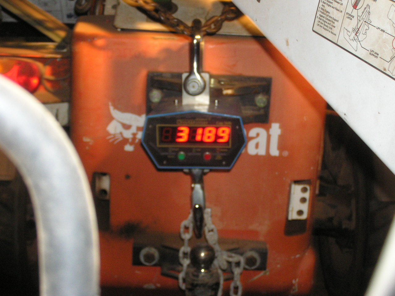

Lift maxed out at 3,189 pounds with the engine idling.
There are many comments about not using a cab tractor in the woods, but those tractors won't fit through a 7' high overhead door like the Toolcat does:
OK. I'm sold. Can you tell us ballpark how much a new Toolcat with that PU box runs? It will also need the basic implements: FEL with bucket, 3pt hitch, some sort of blade, and a backhoe...maybe a grapple if the whole package isn't too steep.

I just tested the lift on our G Series with the crane scale at 3,189 pounds:
Edit to clarify the picture. The scale is hanging from a chain on the SSQA and hooked to the hitch on the V417 that weighs over 10K. The scale is showing the max lifting force of the Toolcat loader at this boom angle. It will lift more weight at a lower boom angle.
