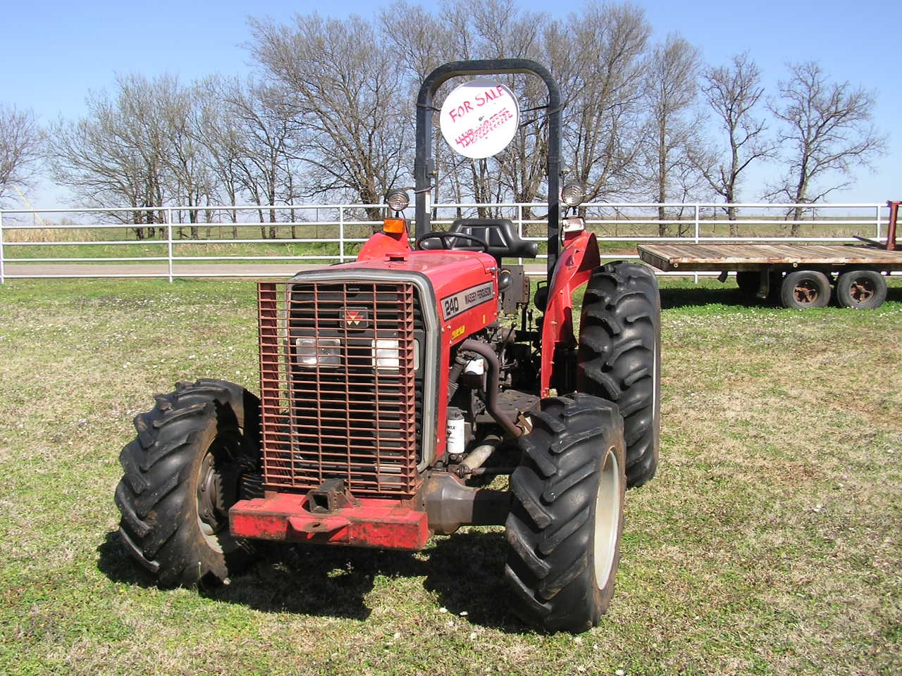

I think that since the OP is not going to be farming, he does not need a farm tractor.
I speak from experience, this is me 76 years ago on grandpa's Case VAC:
Since then I have owned more tractors than I can remember. This is the last one, a MF 240D, before I went to a better for me machine:

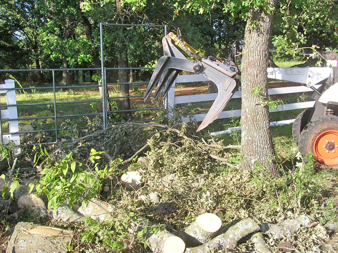

The Toolcat with a small grapple:

The very stable, not tippy, Toolcat with the Monster Grapple:

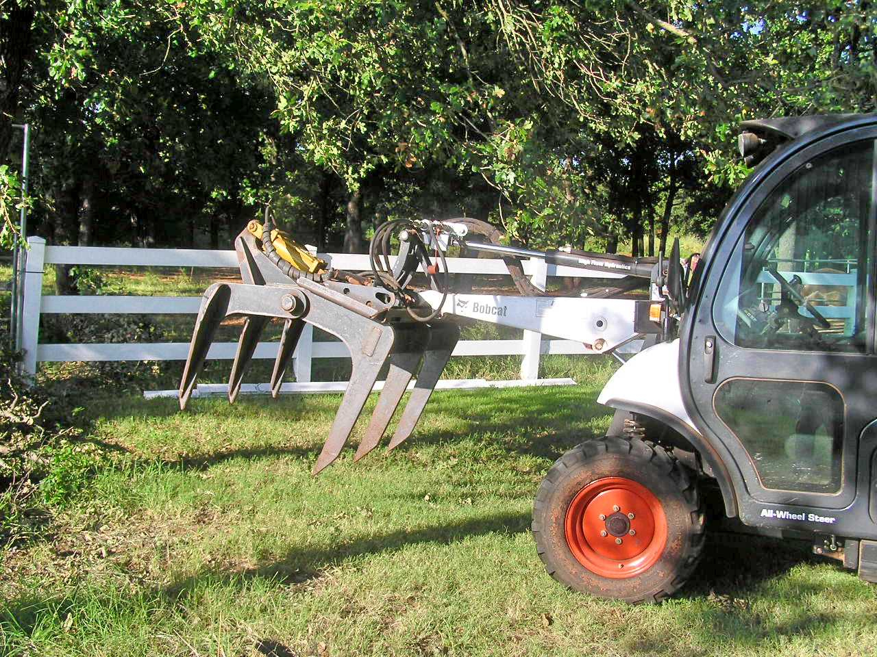

Some info on the Toolcat:
4 wheel steering:
Lift maxed out at 3,189 pounds with the engine idling.
