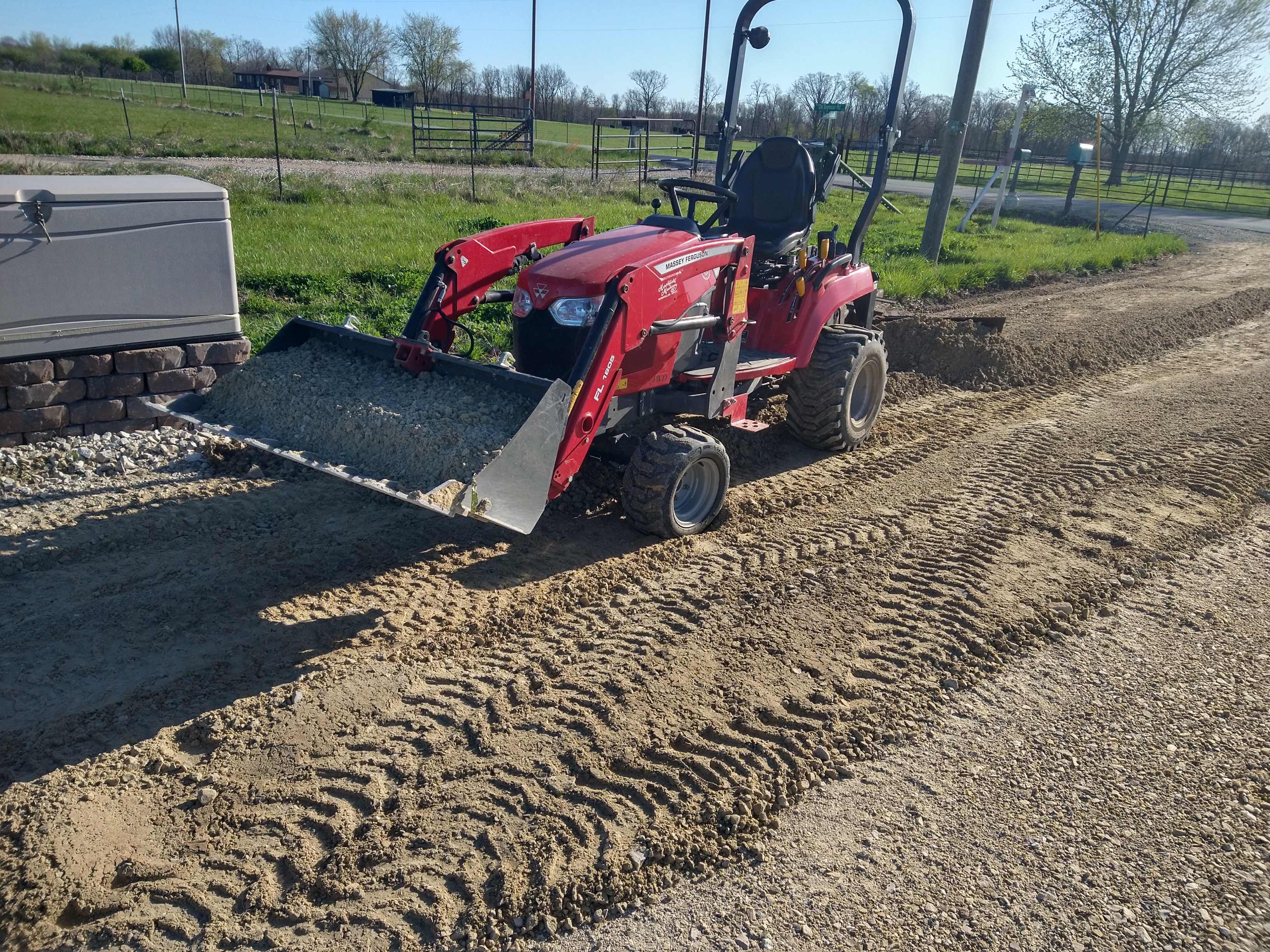

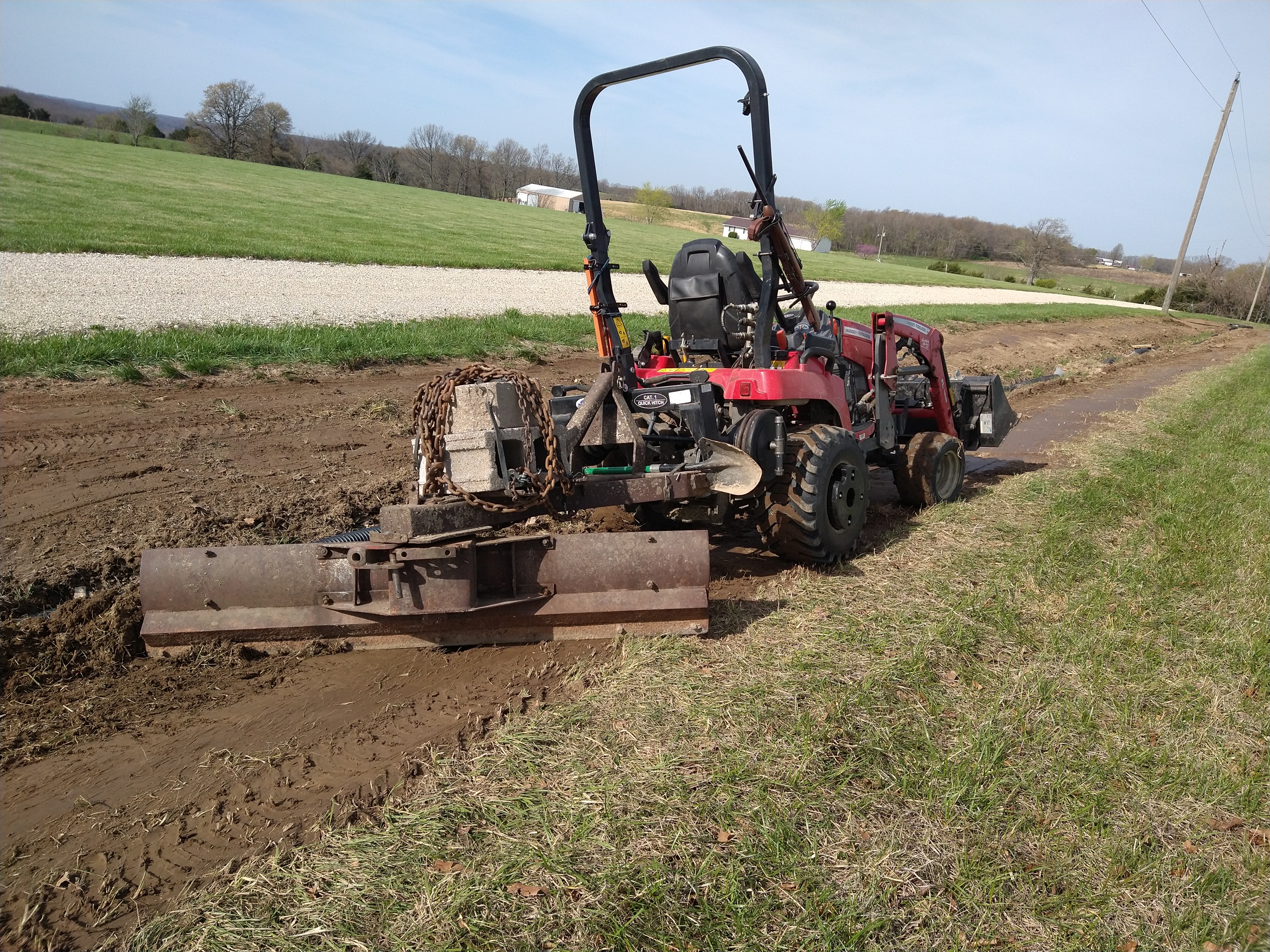

Because the edit function isn't friendly, here is a new post based on my personal experiences with both Hydro and geared Shuttle tractors:
1. If you are using the loader with forks to lift and move pallets the Hydro is far superior because it's a pain to creep up to the pallet slowly and position the forks perfectly so they slide in the slot without wrecking the pallet.
2. If you are mowing/bush hogging, Hydro is slightly better due to the ability to instantly change direction and speed. It's not as big of a an edge as #1 above, but it's certainly an advantage.

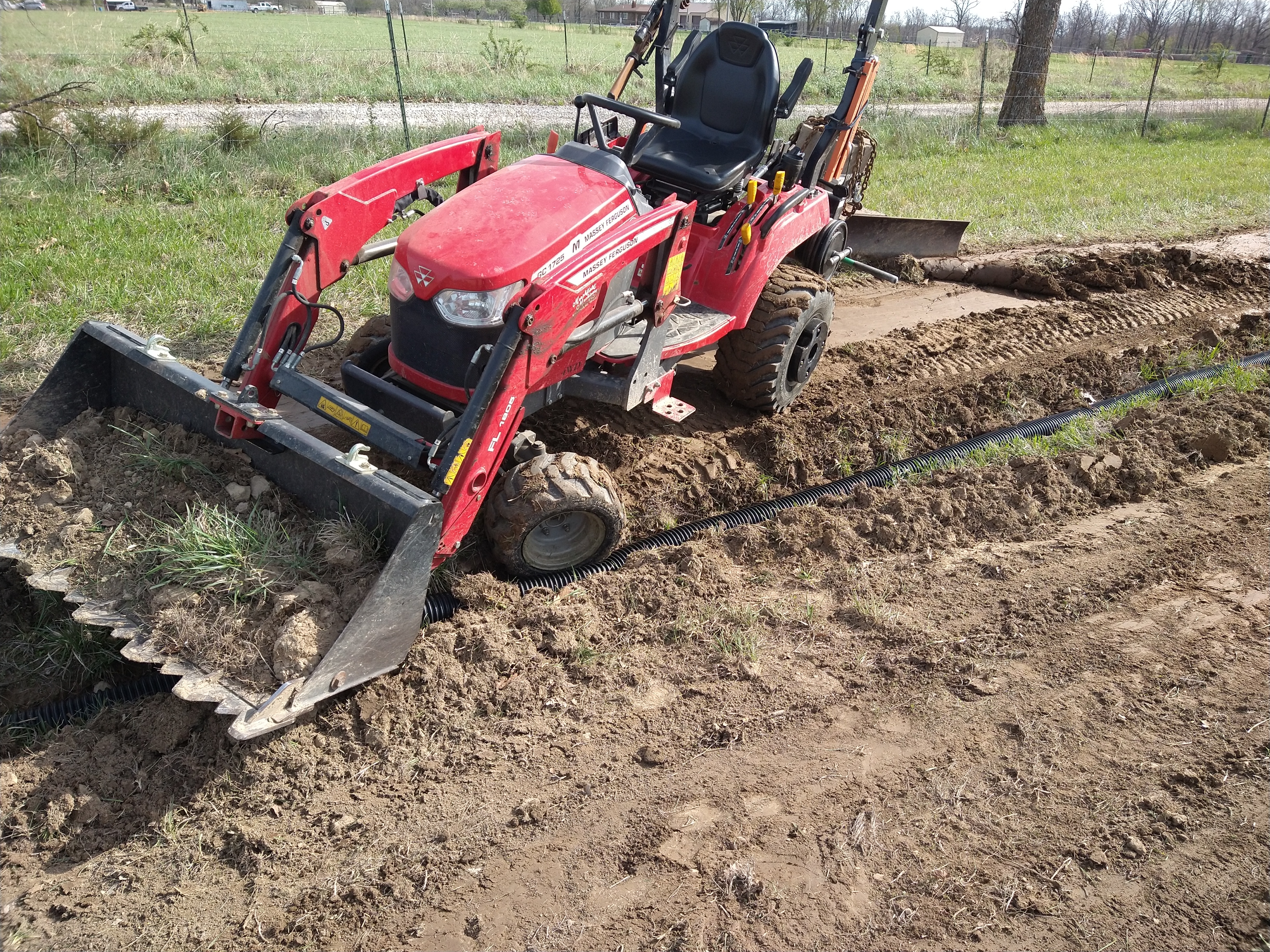

In order to have the grunt, you'll need to use low range in Hydro when digging into a pile, but after that, you'll have to stop completely to shift into mid range to get anywhere.
Maybe I'm doing it wrong, but to fill a loader bucket with dirt from a pile requires very little forward power, just enough to creep forwards a little bit while raising and curling the bucket.
In other words, the tractor may need only 5 hp to move, and the loader does the work.
Also, I can use low or mid range for that operation, and if I parked the trailer that the dirt generally gets dumped into even remotely intelligently it can stay in low range.
If it’s a fresh pile off a truck it scoops pretty easily but if it’s set for a while and compacted it’s hard to break loose.
   / Advice on Hydrostatic Transmission vs Gears #49
In my case it's generally getting the dirt from piles that have sat there for a decade or more.
If for some reason it's more than the L3800 would like to deal with, without using it as a dozer of sorts, I'd either get a smaller bucket or use the larger tractor. Thankfully that hasn't happened yet, but I'm sure it also depends on the type of dirt.
