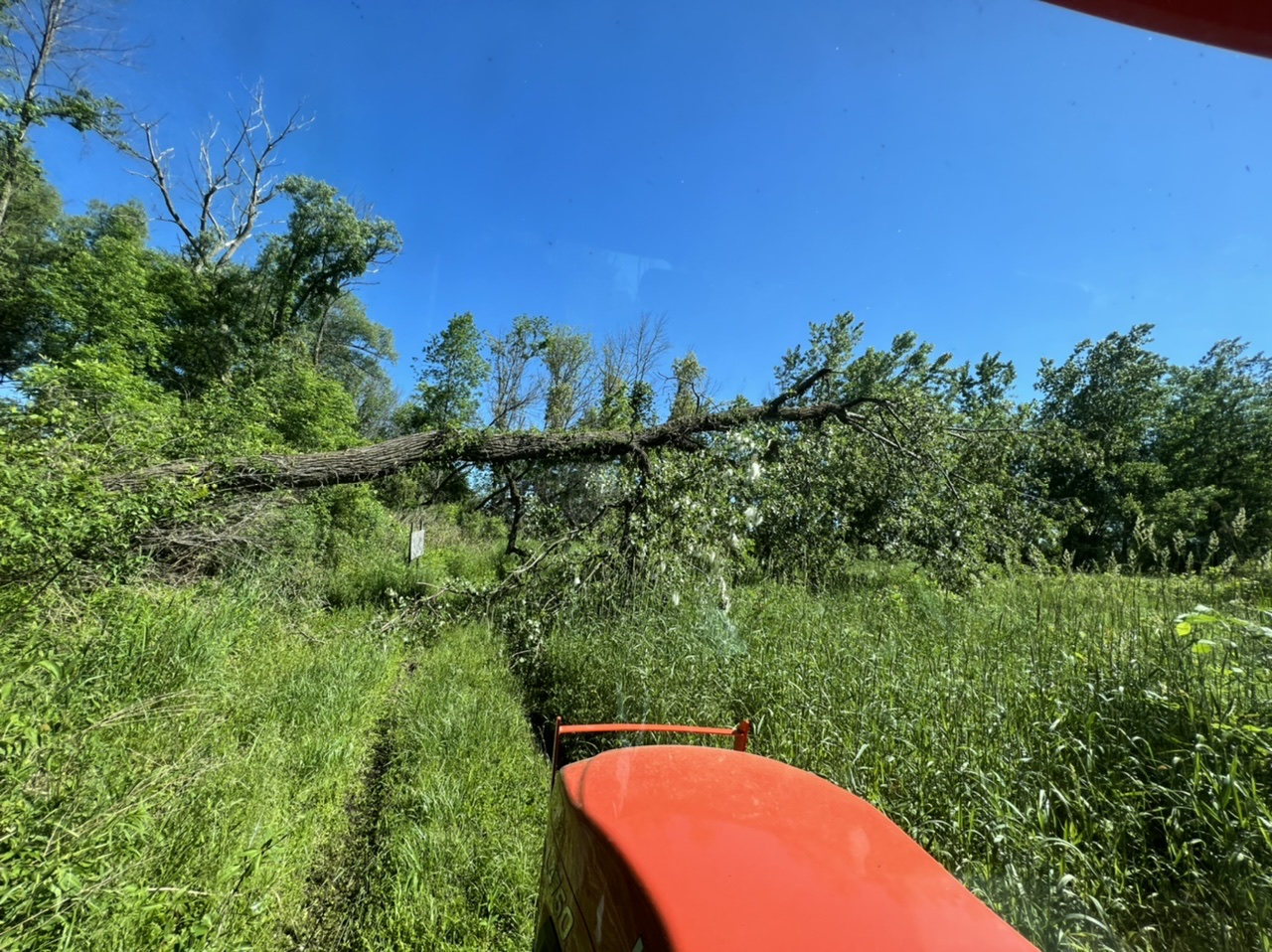

The guy says the top is 50' in the air. Ummmmm.......
I don't see where that was said.
I still think cutting at the base is the most dangerous. Even with clear escape route, too much uncontrolled happening at the same time. Those limbs could roll the log on you before you have a chance to move.

The top end is a good 50’ up in the air.

My photo analysis was way off.
The top did not look 50' high and looked to me like I could drive near the end and whittle it down with my pole saw.
/edit - but based on counting pixels that would mean the log just over the "path" is about 7' in diameter.

2 comments. 1) DON'T cut from the top back. This unloads the root ball and it can catch you by surprise if it moves suddenly. Locally a farmer was cutting up a big old macrocapa tree (blow down) from the top when it dropped back into the root ball hole and threw him. His injuries were fatal. The coroner calculated the butt/rootball weighed 5 ton.
2) Hire a professional to cut the tree, you can finish the job once it is on the ground. Risk minimised.

Gotta see how it’s laying on the berm and what kind of clearance that you can make. Then make a cut location and method.
Probably cut near the base where the tree trunk is closest to the ground. Might consider cutting out wedges from the topside of the trunk to avoid pinching the blade.
Biggest thing is proper access and egress to the cut location And bar length.

This cottonwood pulled it’s rootball and leaned over. I say leaned because it’s roots and a whole lotta earth are still attached. Then about 12’ from that it’s resting (left side of pic) on a berm built as a range backstop. Then you see the rest of this up in the air still. It is not supported to any degree by the limbs. Most of them are barely making contact with the ground. its held in space like this by the rootball still attached to the earth on the side it hinged down, the weight of the earth attached to the side that came up and where the truck is resting on the berm. It’s a big green tree.
I think my plan is to clear out a spot on the back of the berm where I have lots of room to escape and work free of obstruction. Notch the underside about 8’ from the rootball. And then slowly cut from the top down towards the notch. At some point it’s gonna want to have the heavy top start to bend down to the ground and the weighted root ball snap back upright.
I don’t know that I want to limb the top as I don’t know how much pulling up the root ball is doing vs the weight of the limbs holding it down.
lotta energy stored in this mess. Anyone else have thoughts on approach?

So - yeah - to get the whole tree in frame I had to use the macro lens on the iPhone so it's a bit distorted I think. And - the tree is about 2.5 - 3' over the path there... your pixel math is off becasue the bottom line is "high" because I didn't mow the 5-6' tall grass down - so you are to the top of the grass - not the ground. If the limb infront of the target you see wasn't there - I could drive under this with the L4760 - and not be remotely close to the trunk. And while it looks like the trunk is supported somewhat by the links (because they are in the grass) - they are just barely touching the ground - the tree is held here by the trunk on the berm and the massive sized root ball still attached to the earth.
I'll post more pics when I get back down there to assess a bit more. We have a whole house generator going in later this week - so the priority is moving things in the basement where the panel is and doing some prep work where the generator will be located before install day Thursday.
That said - I do like the one idea above... notch less that 1/4 thickness of the trunk underneath at the berm. Then make a cut on the top maybe 4-6" in... and walk away - wait a few days - come back - see how much it opened up - make another little nibble - walk away - wait a few days... etc... AND that approach actually works in my schedule for this week!
Also a few guys were suggesting nibbing at the top with a pole saw... I think I might be able to hid behind some MASSIVE trees and pole saw at the top - so if anything went sideways - all that would be at risk would be the pole saw itself - and i can live with that.

I'd probably go with a 100ft of 6" wide semi sling strap and a heavy truck to pull with.
Tie on about 2/3 of the way up the tree and pull on it on a 90 degree angle driving down the existing path. Take it super slow the first couple pulls to see what it does, gradually increase the pulls until it twisted and laid flat on the ground. Then start digging out the rootball if needed.

First of all - did you trim everything on the upside? Or did it grow that way.
I'd start at the top with chainsaw and pole saw. Cut a bunch away, haul it off, repeat. Keeping a clear path in case it moves. Trimming the branches back to clear 5' or so of stem at a time, then cutting off that part. And might put a good stout rope "down trunk" so if it stands up it would help cutting down more pieces.
If it "stands up" during the process I could easily get out of the way, then cut it at the base and have a rope to assist.

First fill in the hole behind the root ball so the tree won't stand back up.
Then cut on the berm so the top falls to the ground.

@hslogger - I have doubts every tree I drop - probably why I have managed to not get hurt. I have ideas on this one - I just get extra wary anytime something isn't "clear cut" because of how much stored energy these things can have. And I always have a plan and a second plan for the third plan.
