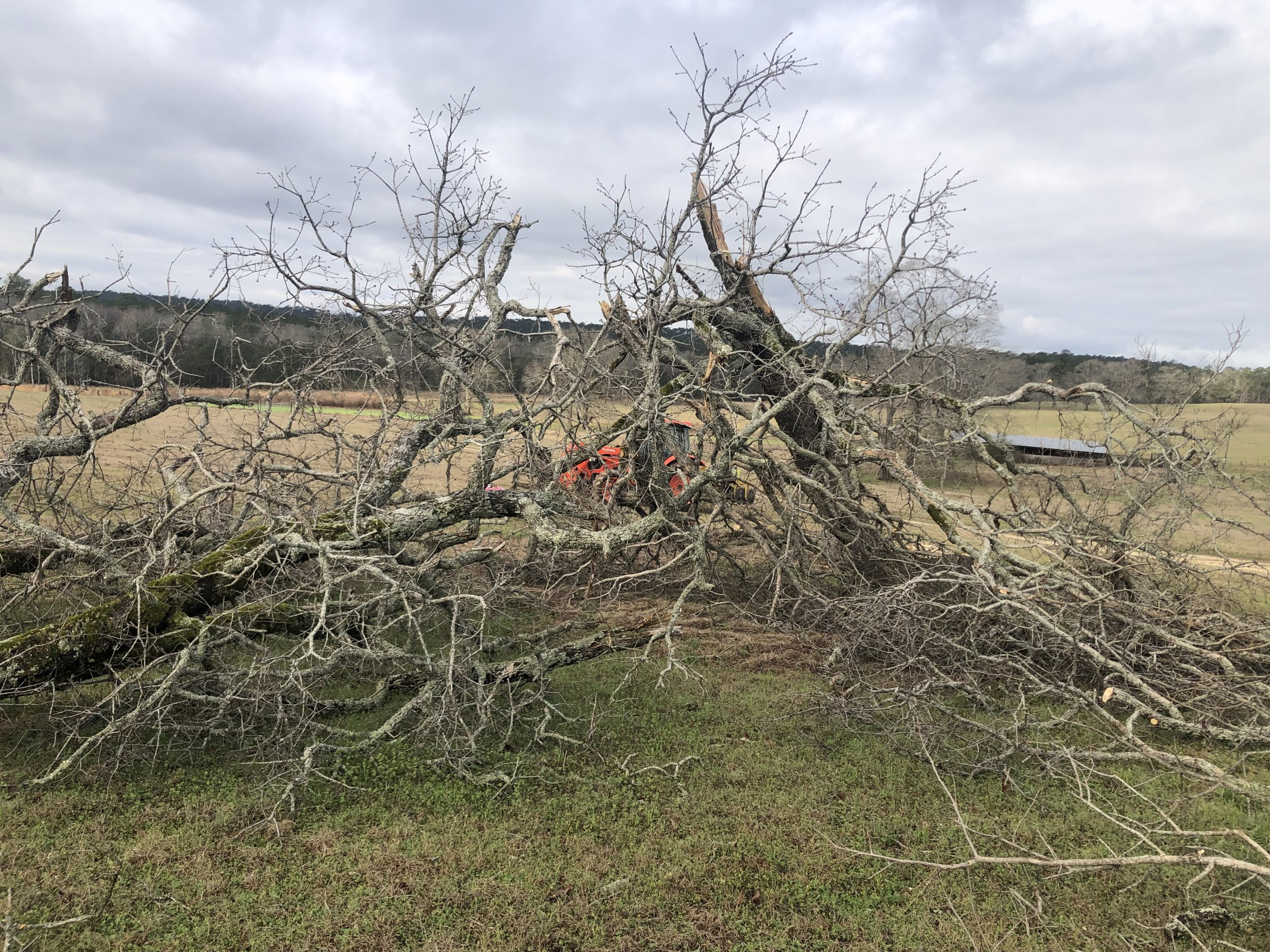

This cottonwood pulled it’s rootball and leaned over. I say leaned because it’s roots and a whole lotta earth are still attached. Then about 12’ from that it’s resting (left side of pic) on a berm built as a range backstop. Then you see the rest of this up in the air still. It is not supported to any degree by the limbs. Most of them are barely making contact with the ground. its held in space like this by the rootball still attached to the earth on the side it hinged down, the weight of the earth attached to the side that came up and where the truck is resting on the berm. It’s a big green tree.
I think my plan is to clear out a spot on the back of the berm where I have lots of room to escape and work free of obstruction. Notch the underside about 8’ from the rootball. And then slowly cut from the top down towards the notch. At some point it’s gonna want to have the heavy top start to bend down to the ground and the weighted root ball snap back upright.
I don’t know that I want to limb the top as I don’t know how much pulling up the root ball is doing vs the weight of the limbs holding it down.
lotta energy stored in this mess. Anyone else have thoughts on approach?
I'm thinking that the root ball will stay where it is. No snap back. You will probably need a machine to push the root ball back in place.
/ How would you fall this? #64
Start cutting the “lower top” branches (on left in pic) that make contact with the ground and work towards the top of the tree (on right). You’ll going to know right away if they’re supporting the main trunk in the air or not.
Sometimes only a couple support the trunk and others are free. Be advised , if they are supporting the trunk, they can snap and whip or pinch your saw as soon as you start cutting them. Know which direction they want to whip and/or if the kerf is opening up as you cut or closing up on the saw.
If no tension in them they will just fall.
Usually doing this, the trunk will slowly lower itself inch by inch as each supporting branch is eliminated.
By starting low and cutting support limbs towards top you’re not adding as much tension to remaining supporting limbs than if you work in other direction as the top limbs are usually smaller and more bendy as trunk lowers.
Being still connected to the root ball and on berm means trunk may stay elevated after limbs touching ground are cut. This is idea for cutting up, but if too high, place some pieces of wood underneath trunk before you cut it at the stump so it stays off the ground when you cut root ball off.

Cut 4 acres of big fallen trees just like this, wicked storm came through, most of the stumps stood right up and fell back into the holes when cut at the roots. Made the mistake of cutting some in half first, then I had 15'-20' logs sticking up in the air, that made things more dangerous to drop IMO.
If you want to tackle this, clean up the tree top removing as many branches as possible without removing too much weight to keep the tree down. Then cut the trunk. I'm just a do-it-yourselfer so this is not a professional opinion, just learned from experience.

Work on the rootball first! ......When you see the trunk start to lay down you know you are once again working with the gravitational energies of the tree. There is no way to know what kind of 'bound' energy is in the fall until you see it begin to move on its own. ....Bound energy could force that trunk to 'slab' on you during a cut, or create a wild shift in the log as you cut it.

I have done quite a bit of this type and scale of work here in the mountains outside of Asheville. If I am interpreting your post correctly, this would be my approach.
Clear a walking route to where the tree rests on the berm. Make a 6" of so cut from the bottom on the right side of the berm contact point, in a comfortable and stable standing position, then finish the cut from the top down. Go slowly as you approach finishing that top down cut and gauge what is going to happen. Most likely just a quick uprighting on the root ball and base of tree. Then fell the base log if you wish, or leave it for habitat. Deal with the upper portion according to your skills and equipment.

Bottom notch where you can stand. Plunge cut everything leaving a tab about 2 inches or so thick on top, nip the tab.
Same as a leaner. I wouldnt be worried about a barber chair so much as the rootball figuring out it just lost a lot of weight and dragging half of the tree with it. Saw, limbs, and you included. With the plunge cut done, when you nip the tab, the stump and tree will be apart. Things will still happen fast if they do so pay attention.

Let me offer an alternative approach. Limb the top as best you can so that the top can fall freely. Then plunge cut the trunk right on top of the berm, down to within an inch or two of the berm. If you can reach the top away from the berm, cut it into sections. If not, cut the top at the berm just above the plunge cut. Depending on the weight of the root ball, it may just let the top fall off or it may try to stand up, so be ready for the top to move backwards. It will start to open up first. Ideally it would just fall off. But if the root ball stands the tree up, you can drop it just like any standing timber. Or, if it is out of the way, just let it stand there.

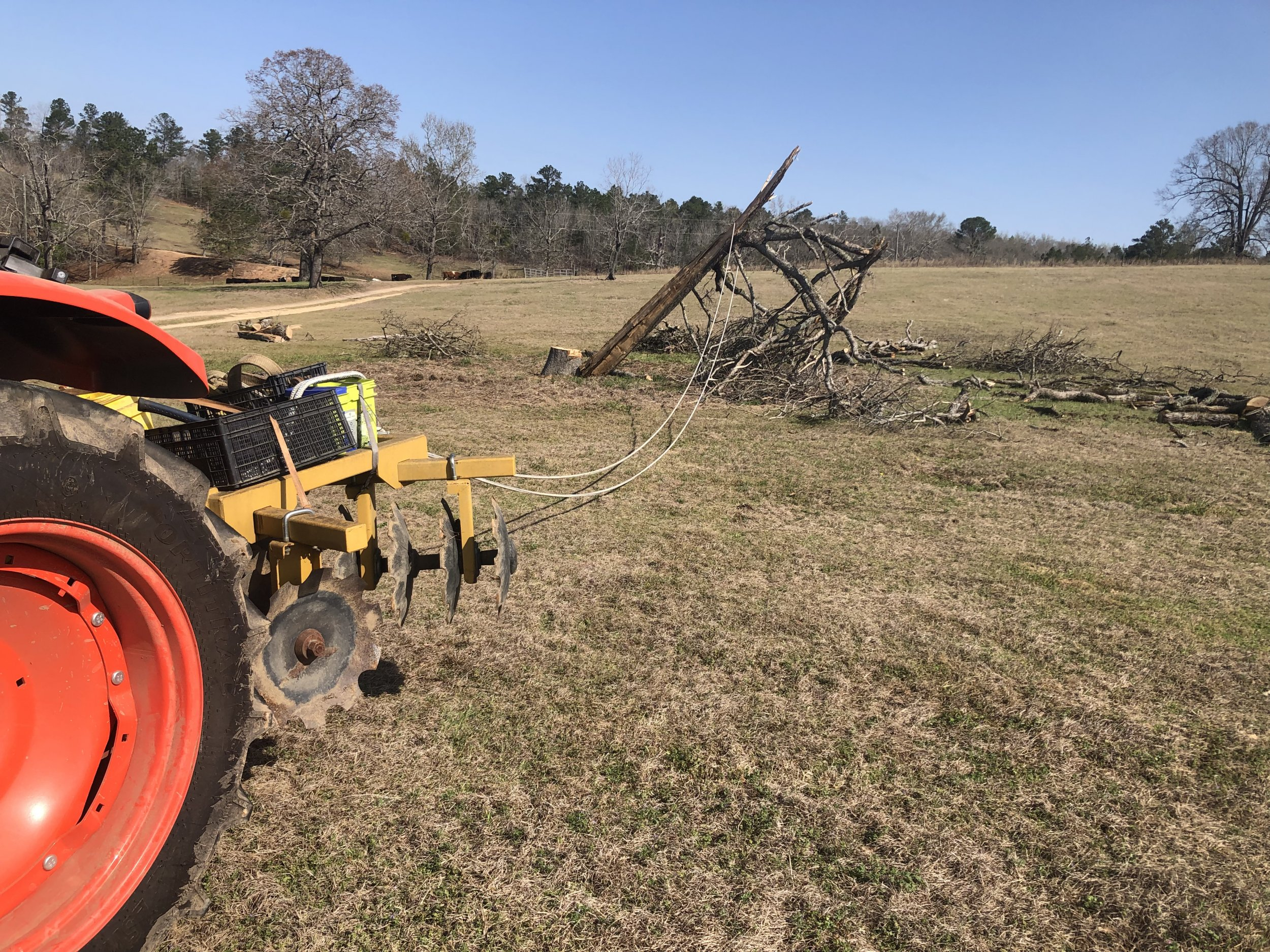

I just finished a week long stump pulling project, and have roots on the brain. Lots of good advice here and much depends upon your tool kit. If you have a backhoe and good access around the root ball, some decent distance work pulling soil away could gradually loosen things enough for it to complete its fall. Also, with a great many roots, wrist thickness or so, involved, if enough are exposed, another incremental approach might be to cut them one by one with a pole saw, until what's left can't hold it up. Just another idea to mix into some great variety of ideas here.
/ How would you fall this? #80
Start with the simplest and safest options first, then escalate if you have to. Based on the limited information available I would get some straps or chains (not rope) strap to that trunk about 2/3 of the way to the top and try to pull it sideways. if that works you may break enough roots to get it to lay down into a safer working configuration. If not, nothing but a little time invested.
