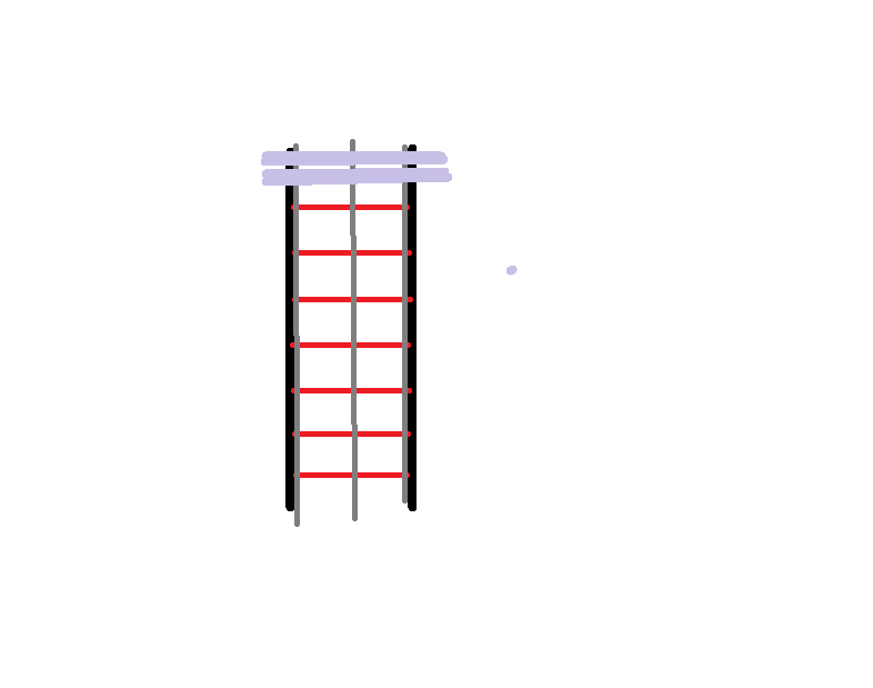

If you can secure the track where it will not separate you could cut 2bys to span inside the rail and then run another 2by6 beside the rail to give you a stringer to nail too. then your planks can lay on top and fasten
/ How would you build this bridge? #3
Pardon the rudimentary drawing but you should get the drift .

Right. I had thought about something like that. Keeping the rails from separating is another issue that I'd like to incorporate into the final structure as well. I suppose some kind of cross section welded in would accomplish that but I don't have a welder and it's in a pretty remote spot to get at.
In the past we've had a pretty simple wooden bridge here but the stream really rises with a good rain storm and that washed away often. The iron is quite a bit higher now and given the extra weight the hope is that even if the water were to get that high it would stay in place. Probably add some kind of "anchors" to make sure of that.
Looks interesting but not quite sure what I'm looking at with respect to materials?

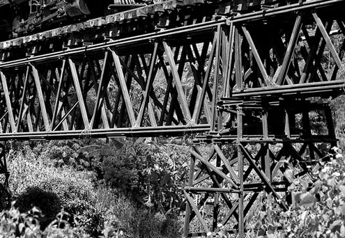

I think you will put a lot of effort making these rails work for you. Treated 6" round for posts, treated 2x12's 1 ft on center for spans. If you google rail road truss bridges, you can see it's a real simple concept and real strong.
