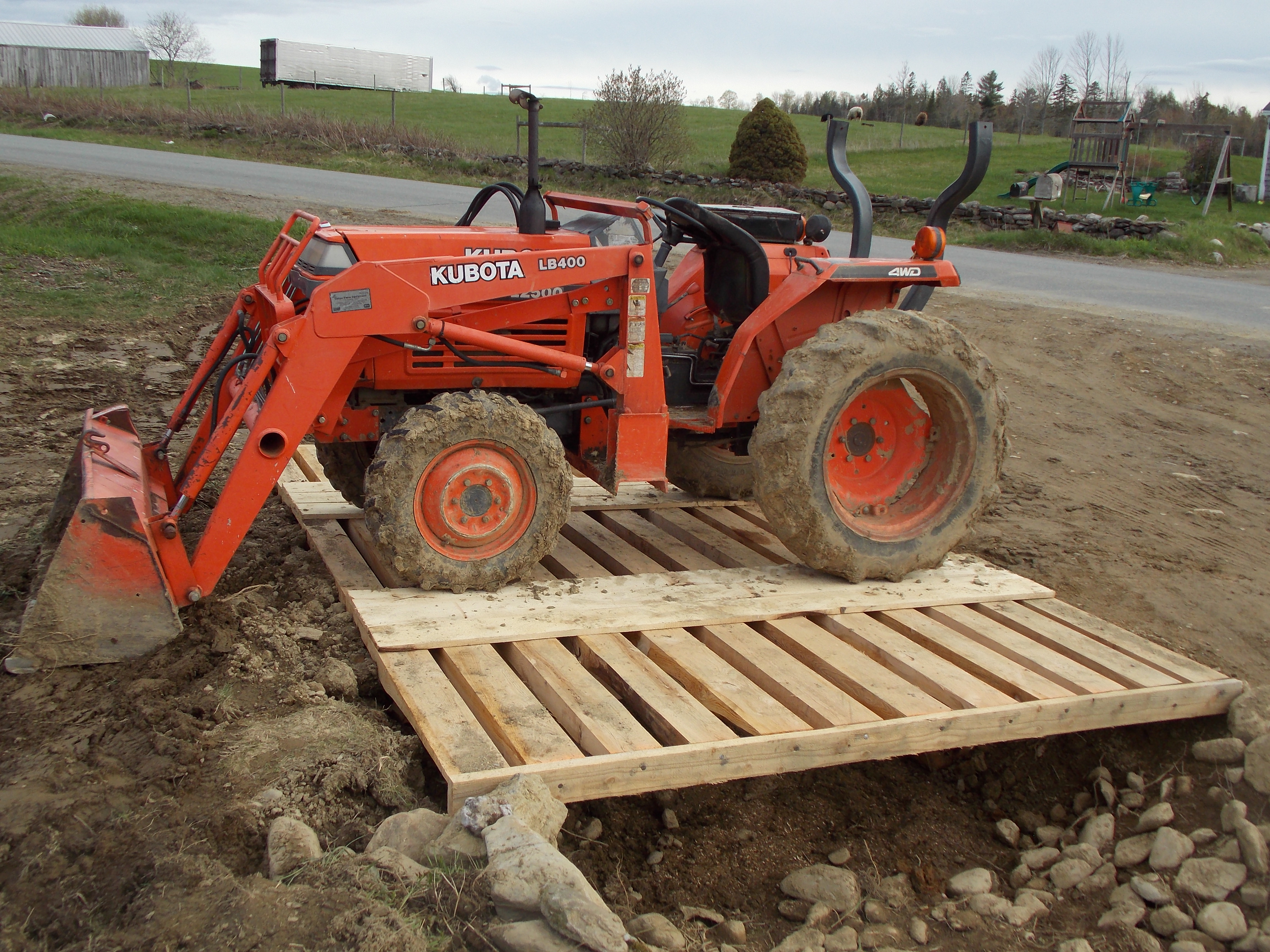

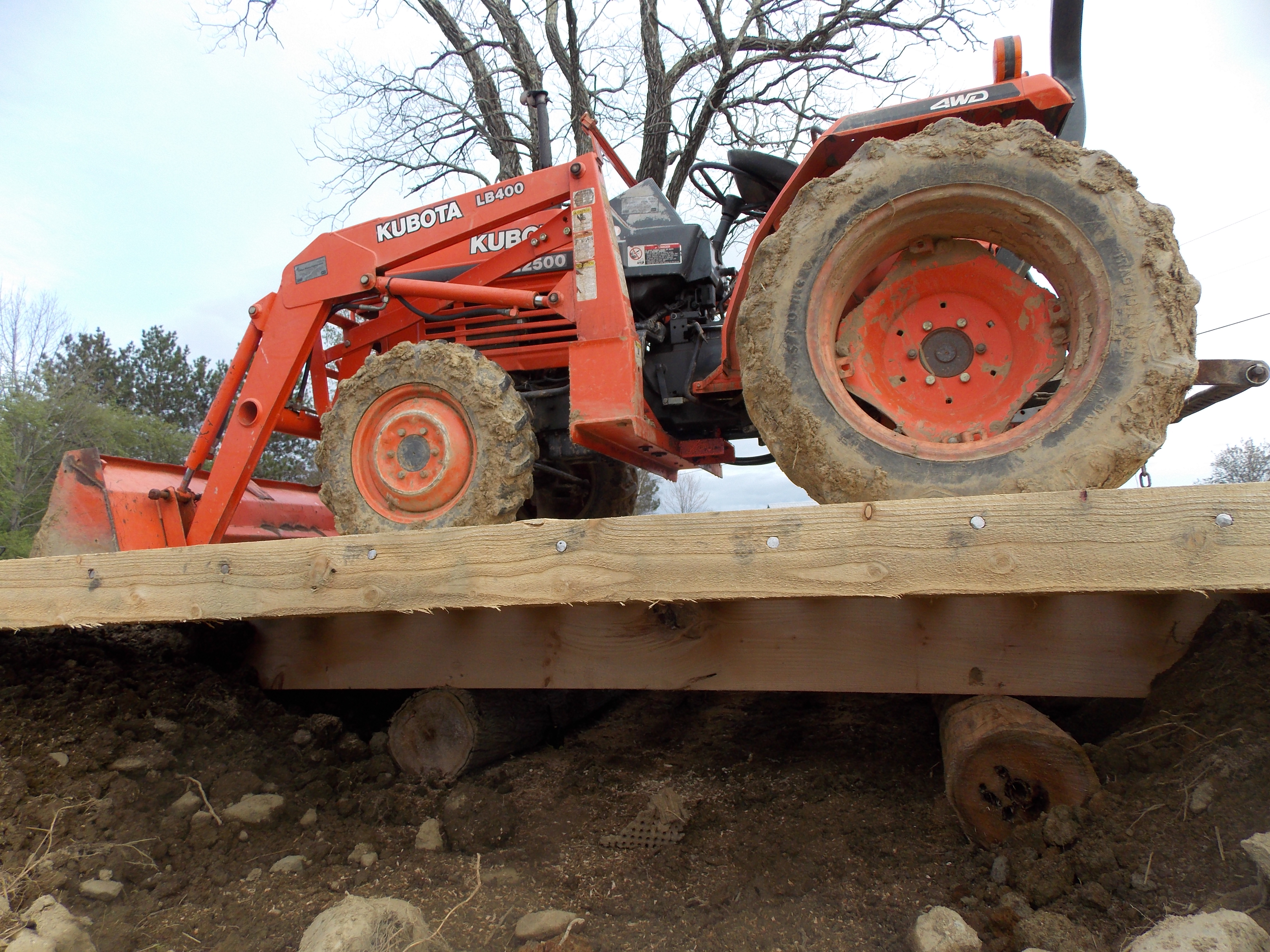

I built a bridge similar to what you are talking about. I used (2) 5x10's spaced 5'-6" apart for the main supports. This was set a bit wider then my tractor, and a bit narrower than my truck, all made out of cedar and hemlock, rough cut. The planking is made out of 3x6 inches, with boards as runners just to show me where to center the tractor/truck when crossing the short bridge.
With my 3000 pound tractor, or truck, it does not even flex.
Cost was $12.50 as I have my own sawmill. The cost was in buying the spikes which were 6 inches long.
It took me a day to make it, sawing the lumber in the morning, and then framing up the bridge in the afternoon. (I did have the logs hauled out of the woods, and beside the sawmill before the start of the saw/build day.
