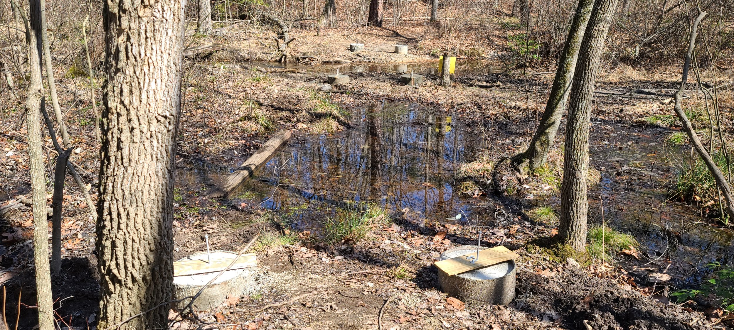

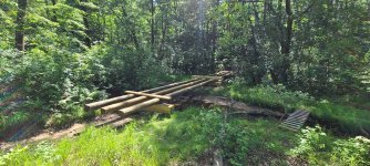

Thanks Everyone. It is certainly a spectacular time of year. A couple weeks and everything will be naked! Here is a cool shot just a little down stream from the bridge where it opens into the cove. Look close and you can see one of the Great Blue Herons doing some morning fishing. :) Now that I can easily access this side, I may do a little fishing myself. :)

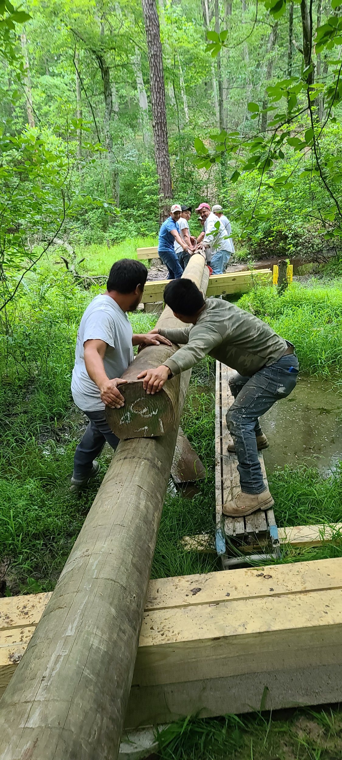

A few pics now that some snow has settled in.

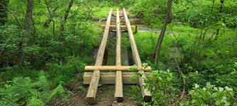

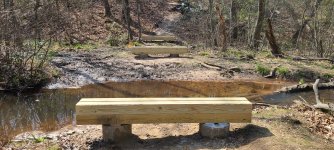

Beautiful Bridge. I would put a Centre Support of Concrete Blocks or 6" capped steel pipe placed on heavy Patio stones or a big length of 8" Channel Iron. Old age sags!
I will keep an eye on it, I am hoping the those large treated poles will hold shape for a while. It would detract from the aesthetic of the bridge to have to throw another support in there if I don't have too.
