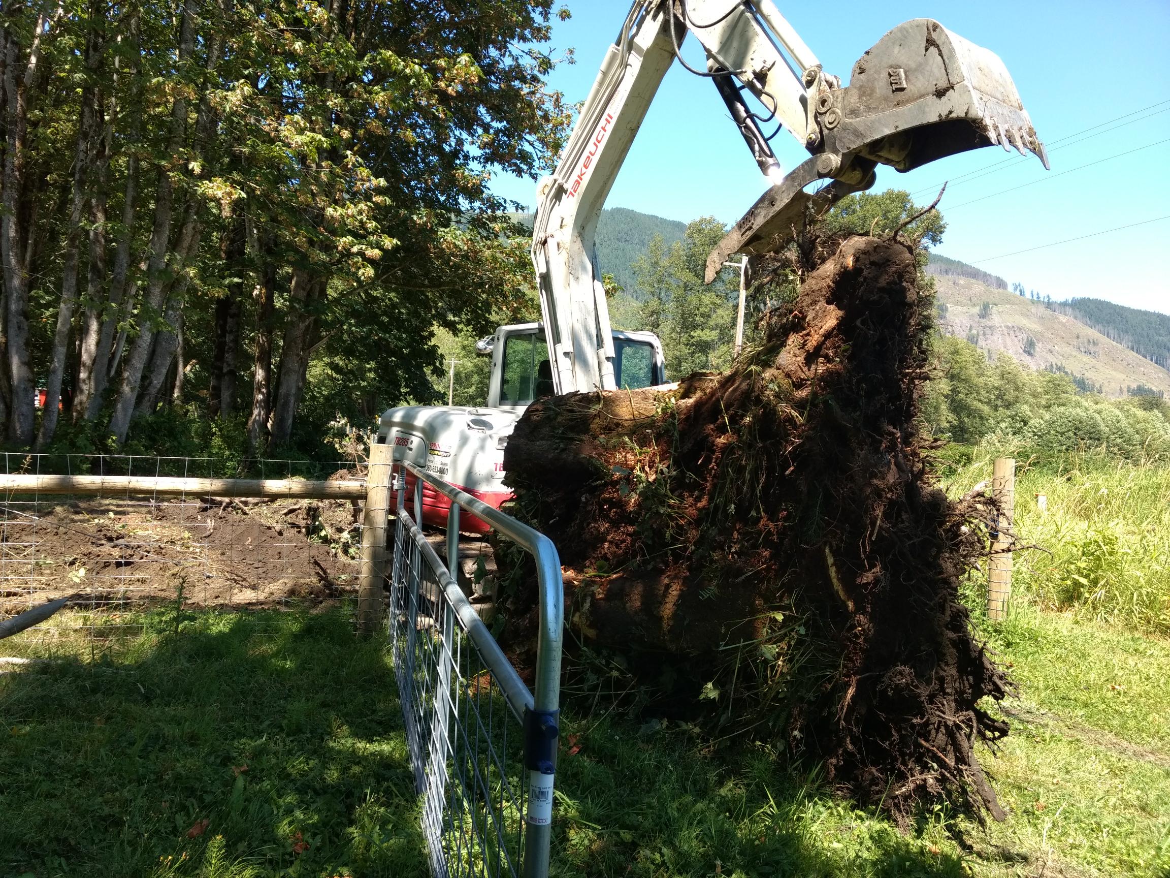

Took me less than 1/2hr to become reasonably proficient using an excavator: not a one-off, in which case that learning experience has paid out over many years now (several projects). Heck, even my dog picked it up pretty quickly:
I would agree that a bulldozer is a different beast: and that's also a good idea to consider hiring one out.
My dog thinks it’s a good place to take a nap.
