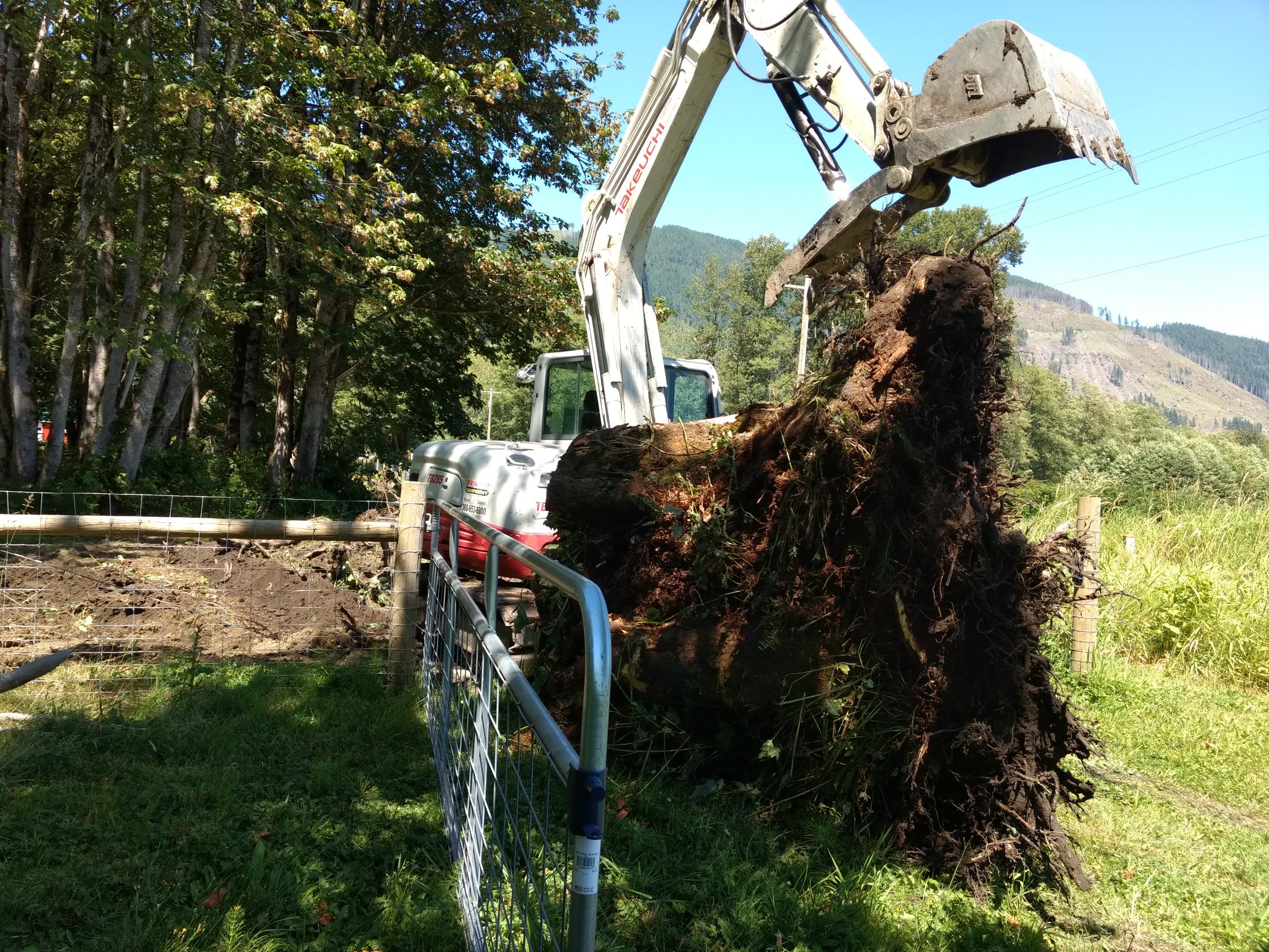

Excavator. Period! Rental cost for a day* is going to be a lot cheaper than if you break something on your own, non-commercial-grade equipment. Dig out roots from attack side and then just lower the blade and, with the bucket pressing up on the trunk, push the tree over. 9k unit, pretty common, should work fine.
* Maybe $500. Task done a LOT faster and safer. PLUS, excavators are fun to operate (once in a while- wouldn't want to day-in-and-day-out as they can wear you out).
And when you have to get out bigger stuff, ONLY an excavator will do (19k lb Takeuchi)!

A 19,000 pound excavator would be better but a 5 ton excavator would make quick work of this job.
