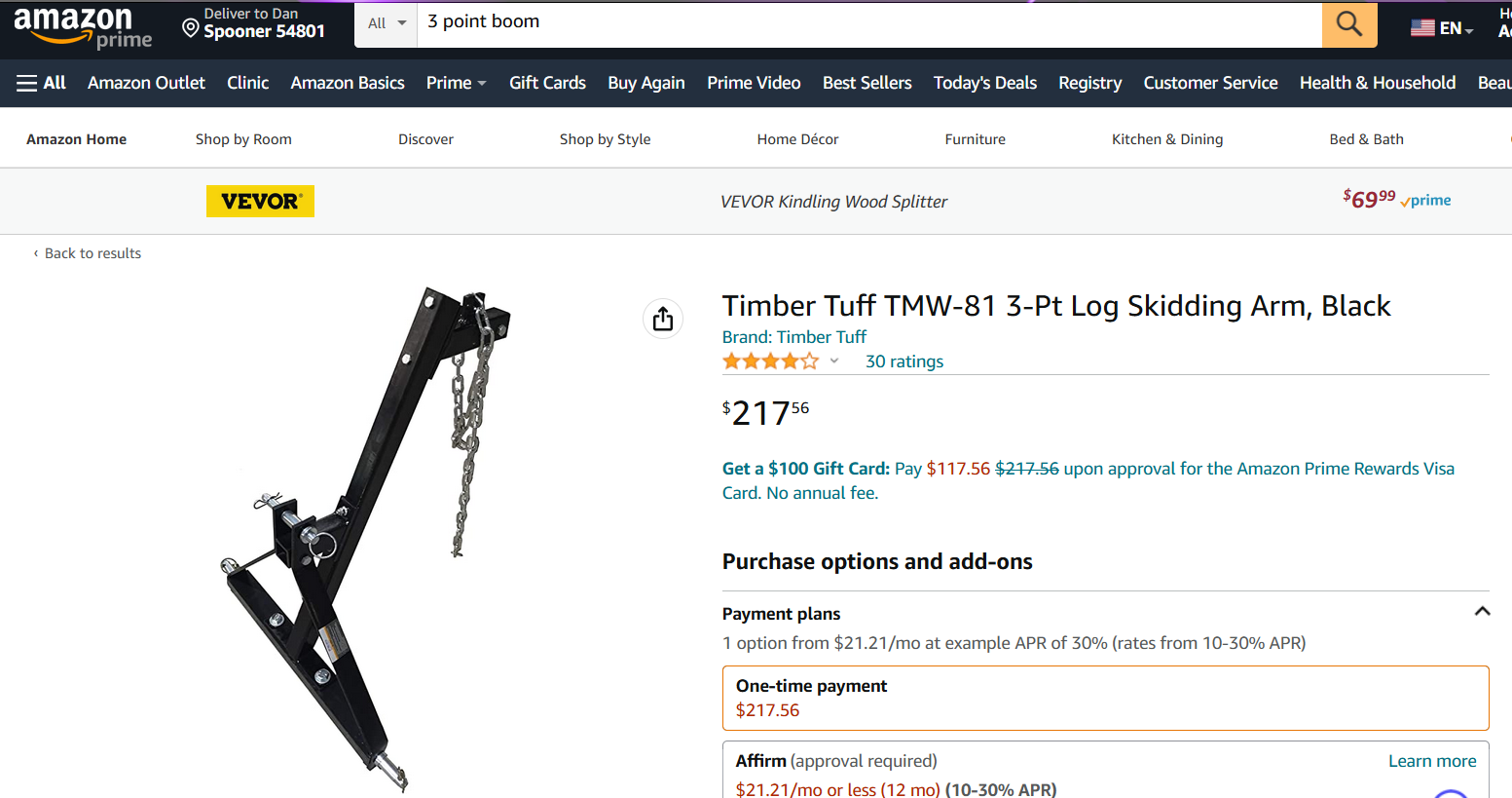

Does your 1066 gave a backhoe? If yes, attach the skidding tongs to that.
If not, put a short boom on a 3pt trailer mover, and use skidder tongs.

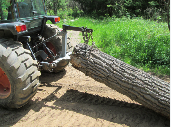

Using what you have, a logging arch is worth considering or at the very least, some kind of skid plate to keep the butt end of the log from digging in while being towed. Back in the day, the cheap way was to use an old car hood.

Just skid logs the way that loggers have been doing for years. Limb the tree, then skid the logs with a cable choker fastened to a clevis on your drawbar. Logging tongs are ok, but don’t grip the log as securely as a choker. And chokers are cheaper.

Using a rear blade is clever
No, the backhoe is my JCB industrial.
1066 has a flexwing attached to the rear and a speed multiplier attached to the PTO (it's a hydraulic mower). I don't even have ... what's it called..... the mower is attached to the drawbar BUT, if you remove that, there is a trailer hitch that goes between the two arms. I don't have that.
I now see the pictures above (and had seen that prior) but looks like it's CAT-1 rated? Tractor is Cat-2 as I recall.... Any issues with that? (I do have bushings for my tiny box/blade as I can't yet put $$$ into a Cat-2, approx 6 footer heavy duty that I'd want to get...)

I've pulled trees with by back blade - a 6' CAT 1 - I removed the blade to be able to lower it closer to the ground. Pulled maybe 10 trees like that - not a lot but it works. Just a pain to get the trees chained/hooked up every time.
I would get a setup like the video 2 in post 11 to drop over a log without getting on/off the tractor.
