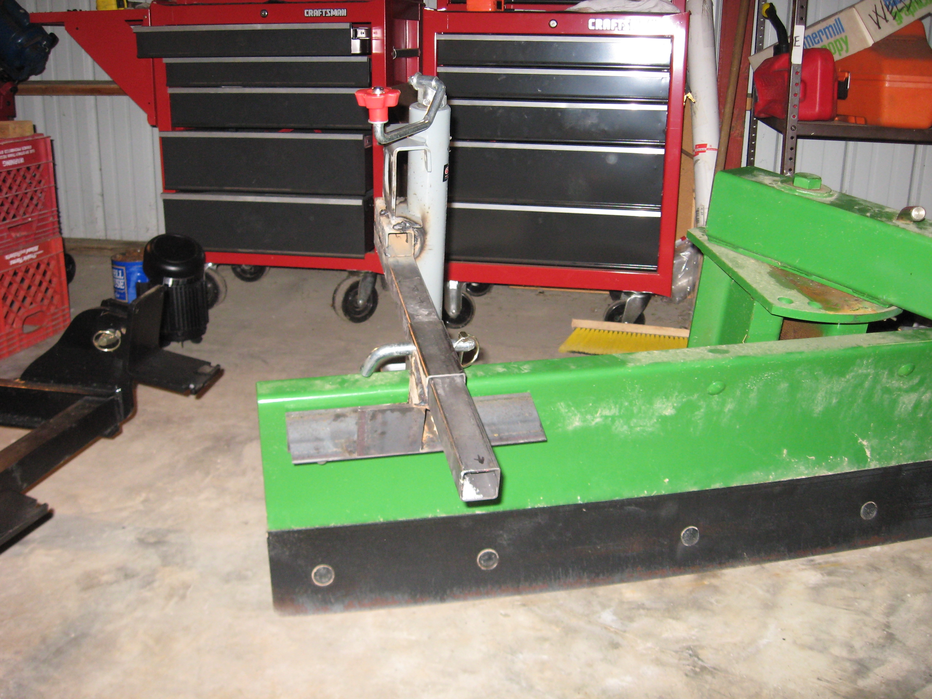

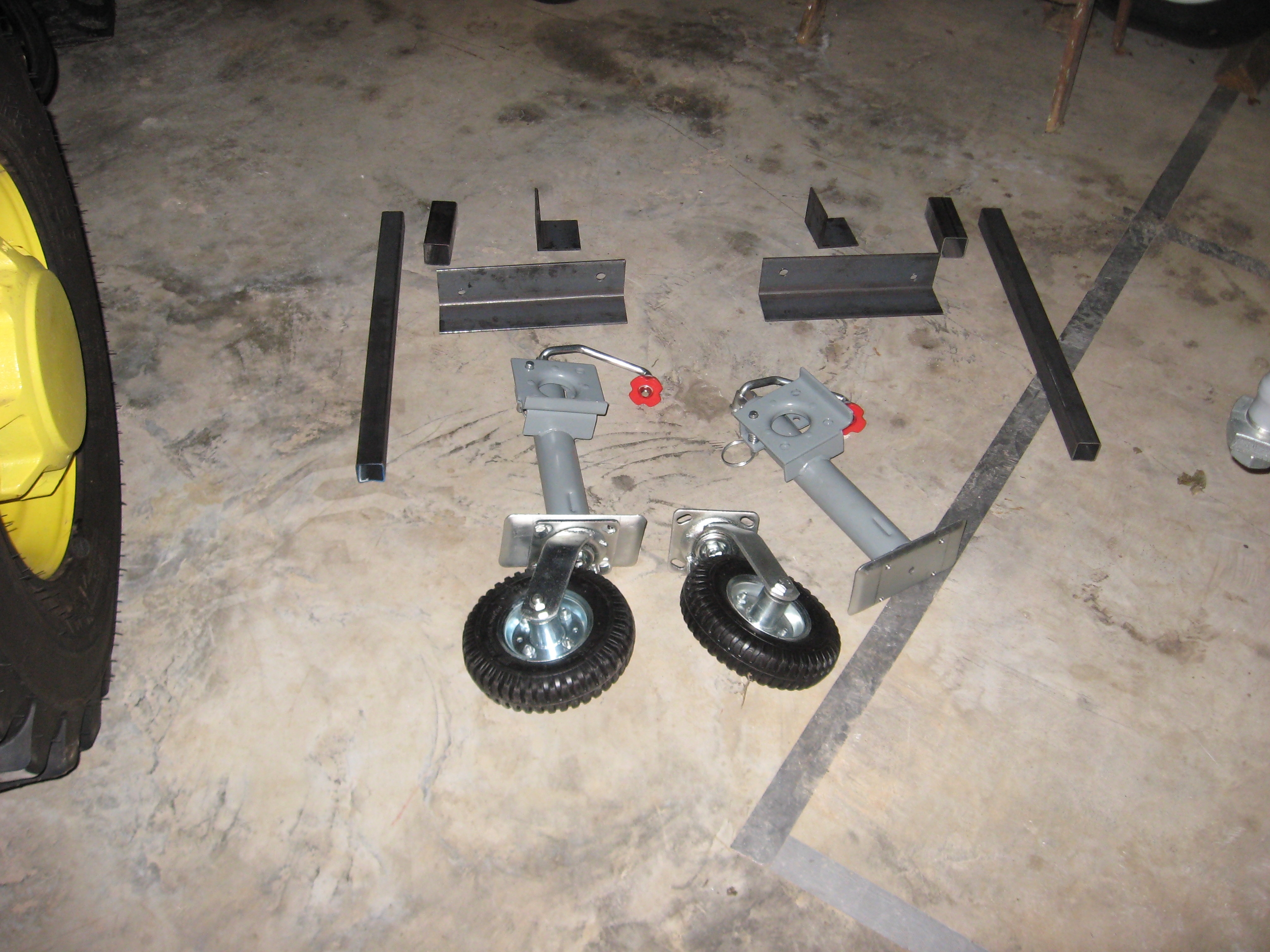

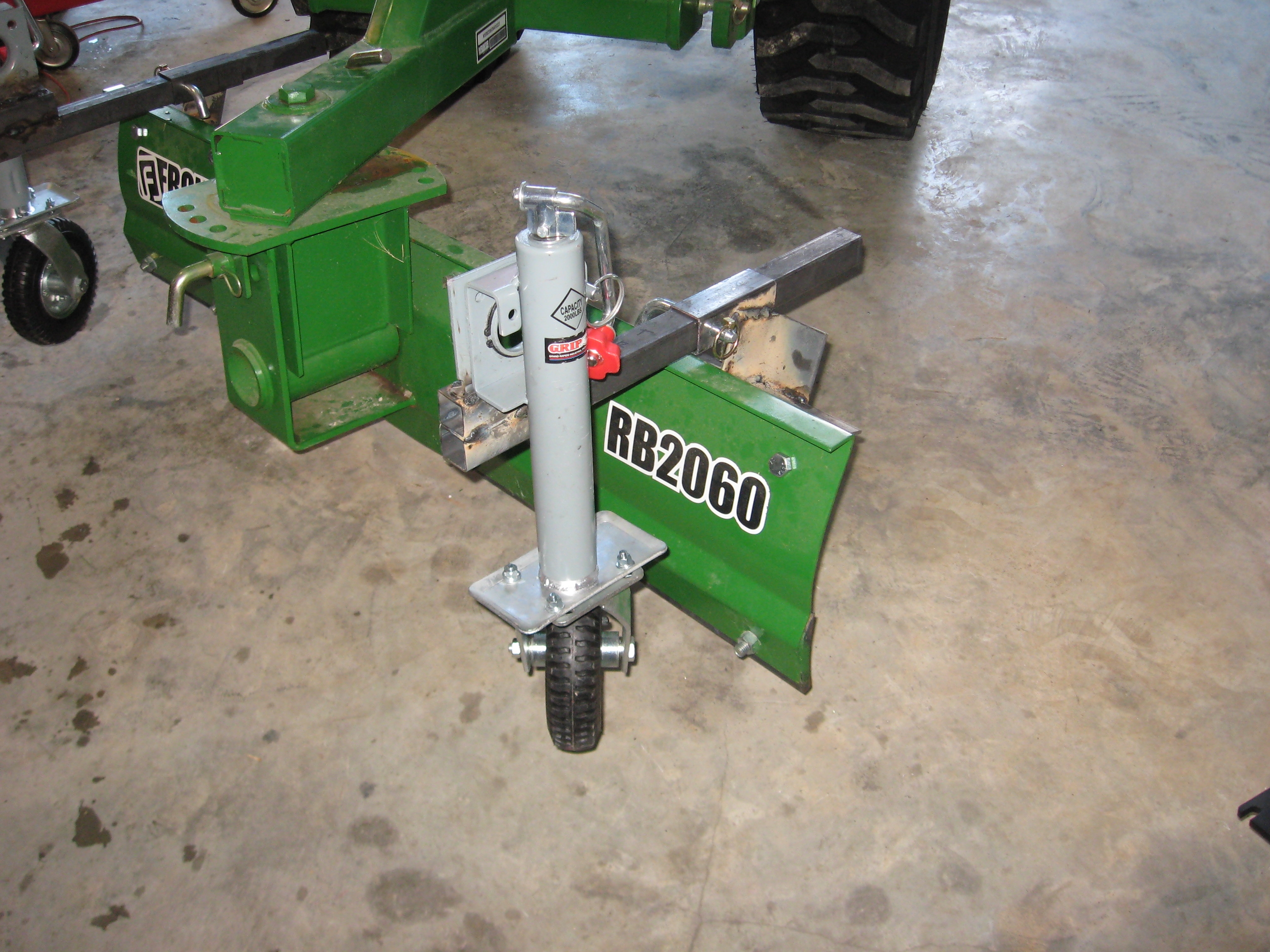

Your wish is my command. Here are the pieces all blown apart.
And here is a close-up of the "finished" product.
Note: The cheapo air-filled tires you see in this photo lasted, literally, one pass before they were shredded, so now it has 6" solid rubber tires from HF.
Also Note: This was supposed to be a "prototype" and not intended to be the final product. However, it worked so well, I just pressed it directly into service and forgot about it. Didn't even paint it. The square tubing I used was cheap, thin wall stuff, but the actual plan was to use trailer hitch gauge material. Maybe someday I'll go back and make the "final product".
In summation, I don't know how anyone uses a rear blade without gauge wheels and I almost never take these off.
I run a heavy 10 foot back blade with no shoes or gauge wheels.

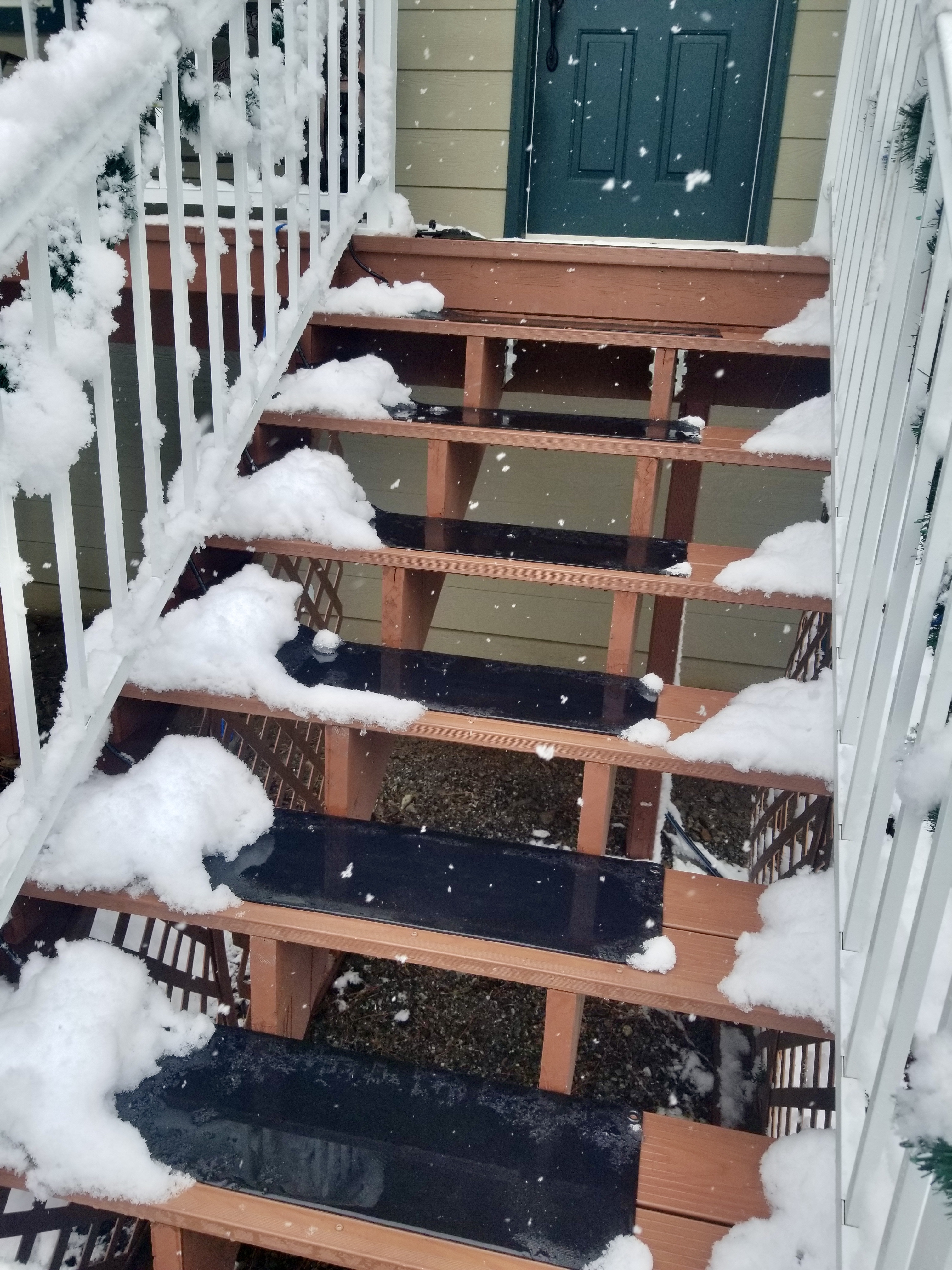

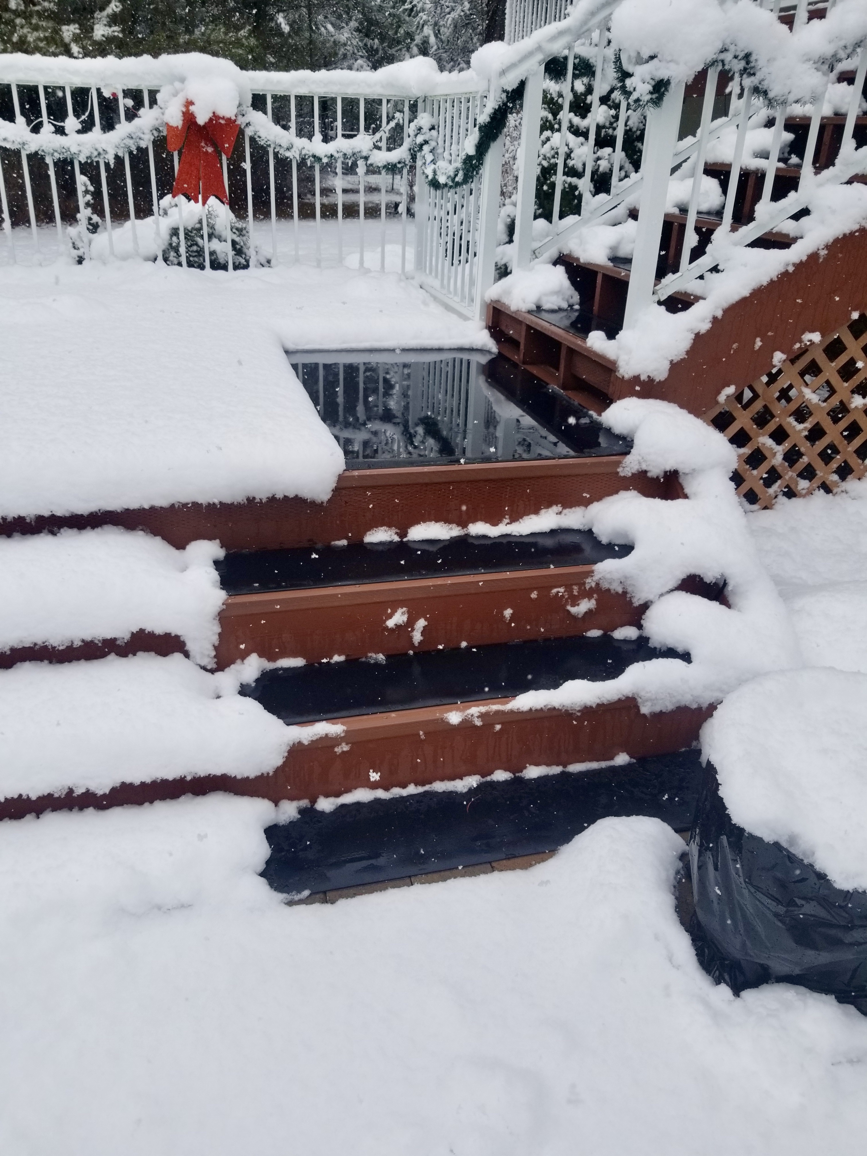

I ran my walk and steps ones for about 4 hours today.
Lou or GRS, can you provide some more information about these drive / walk heaters? Power draw, cost to install, and cost to operate? Then how are they installed - insulated, concrete etc?
My wife wants to connect our detached three-bay garage to the house 70' feet away so we don't slip and slide (and break a hip when we are older). So i have been looking into options.
The other alternative is to add a garage bay onto the house which is doable but $30-40K
/ How do you plow snow? #284

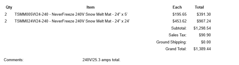

The ones that I installed went in the concrete walk and steps from the kitchen door to the end of the garage. We put down insulation, rebar on stands, then the heat mats.
I have wondered a couple of times if the ones that lay on top of the concrete might have been a better choice.
The in concrete ones are not inexpensive.
The factor for me was the house eve always dripped and put water on the walkway which is shaded most of the day so the ice would build up considerably sometimes. I have also added gutters during the exterior redo we have done the last few years which have reduced the ice build up some.
This is what I put in almost 3 years ago;
When in use they pull just about 6Kw so at our current 22 cents/kwh they cost me a$1.32 per hour to run,
after shoveling or plowing/blowing it usually takes 3-5 hours to finish clearing the 30 ft section. Today I turned them on about 10AM and promptly forgot about them till 4 PM by which time they had not only melted the ice but (evaporated) all the water too bone dry. So $8.00 have a nice safe walk.
I do have 3 1/2" of concrete over mine, less concrete and more insulation might have been a better idea but I have run a 10,000 tractor up on mine when using the work basket to clean pine needles out of the gutter guards.
I "inherited" a York Rake with gauge wheels and a conventional back blade. I thought the wheels on the rake was an excellent idea, and used it a few times with some success. However I never even attached the back blade because I had tried one in the past and found it completely impossible to use with any degree of what I would call success.
Never thought of adding gauge wheels to that. Why don't they come that way?!!

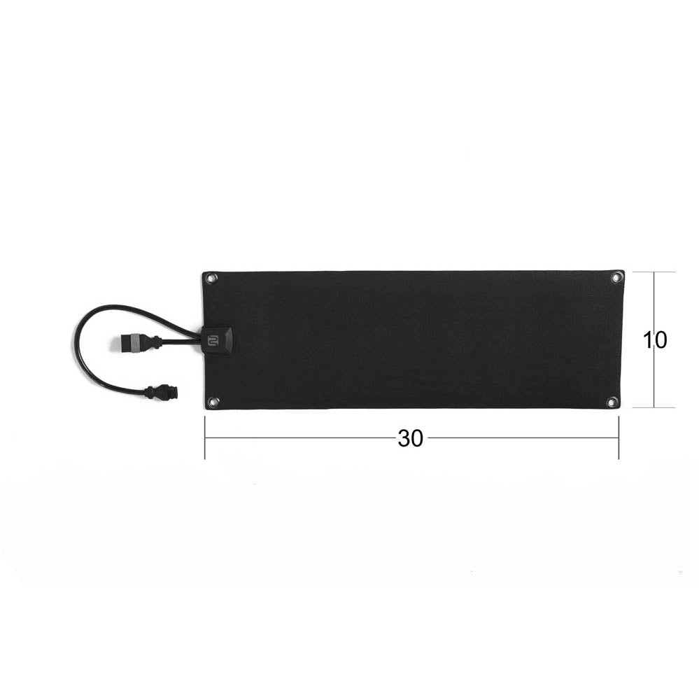

I use mats that just get installed during winter. Each one plugs into the one ahead of it..
I used HEATTRAX MYSELF. Thirs season with it. Love it. Mine is hooked into a Yolink exterior wifi outlet we I can turn it on and off with phone or set a daily auto cycle as needed.
I set the wheels so the blade rides about 1.5" above the surface and it really helps to keep the gravel on the drive and out of the yard. The same goes for the gauge wheels on the blower.
Thank you very much - this is the detail I was looking for and probably similar length. We have shading too as the house entry faces north and that area doesn't get sun in the winter, so always slippery, vs garage faces south so that pavement clears off with sun.
We are due to repave the driveway so thats when I will do it - probably with brick as thats what most of our walkways are now.
I noted the amperage is 25 amps the total for the nearly 60' length or per 24' section?
Thanks again,
That is the total draw for the four sections. When I did the wiring I used four individual switches with one being for each section, the thought that if a section went bad it would be easy to keep the others in service.
Mine are side by side with two short ones in the step/landing and the two long ones are side by in the walkway.
